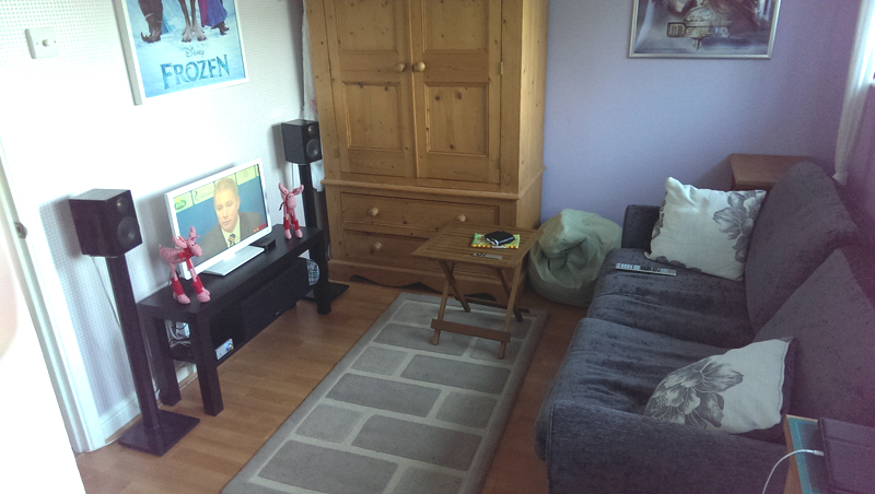

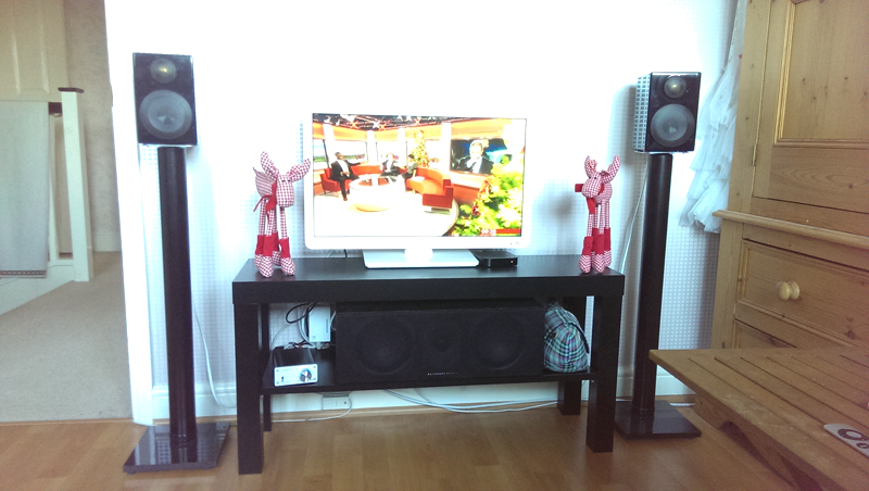

My room is a newly set up den for me and the kids to use for music and TV. We've got about 3.5m x 3m with suspended timber floor. The speakers fire across the room, so there's about 2.5m between speakers and ears.
The current setup:

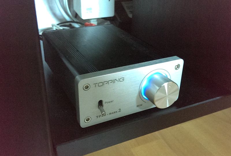

I chose the drivers because they promised a more laid-back sound that's OK for use with low-cost sources. I'm planning to use a Topping TP20 mk2, driven from the TV analogue output (i know 😱).
The current setup (monitor Audio Radius 90s, plus passive sub) actually sounds pretty decent for the money I paid for it - nearly free! I just fancied building something for myself.

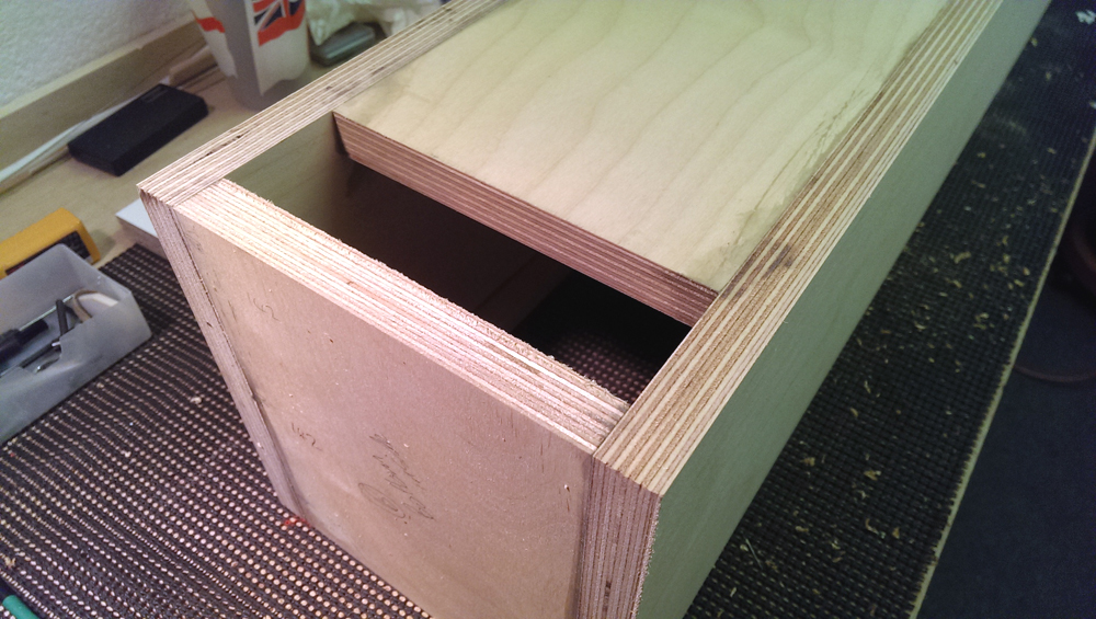

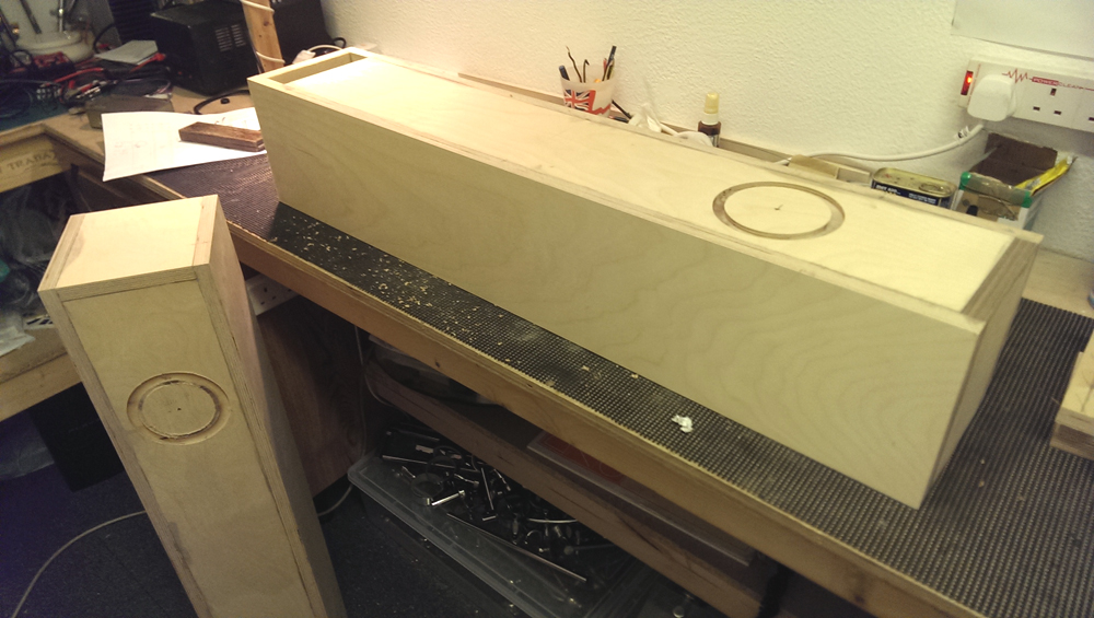

Well that was quick and painless...

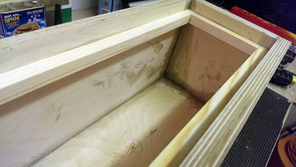

Birch ply custom cut by a company on ebay UK. Only £66 delivered 😱
I could never have got it so square if I'd cut it myself. Cabinets were glued and clamped, not screwed.

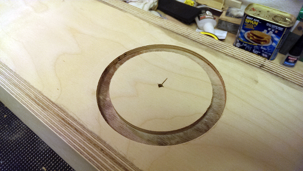

Rebate for Alpair 6M driver - ready for the hole to be cut with 95mm holesaw.
Batten added to allow the backs to be removeable.

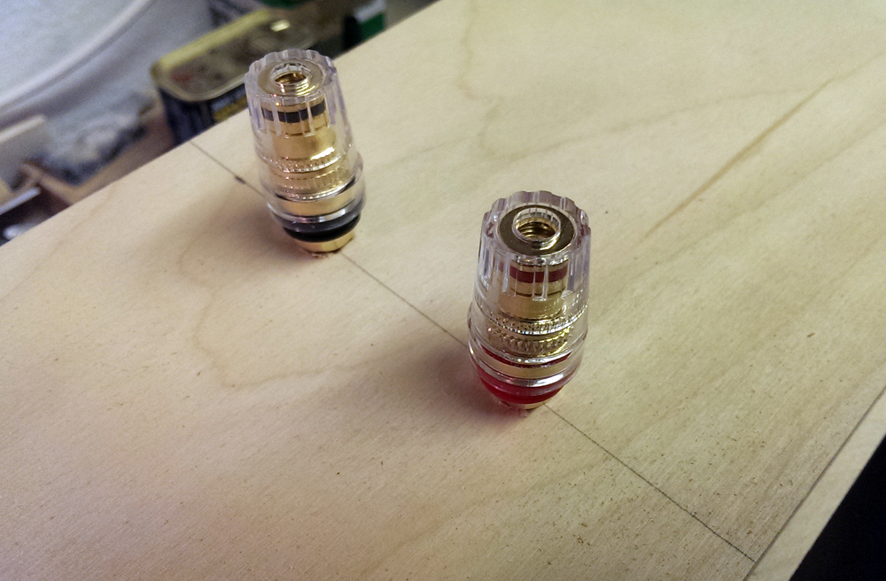

Speaker terminals from ebay. Not sure what to use for internal wiring 😕
Just waiting for the holesaw, and we're ready to go. Gonna buy a pair of pillows for the stuffing.
Should be ready to fire up in a day or so.

Good deal on the precut BB - does that include material cost and delivery? If so, an absolute deal and great for those without a shop.
Nice work on assembling it. I think many folks use single strands of 24ga solid copper from CAT5 cables. At the drive levels that full range drivers get - works very well. Cheap 16 gauge lamp cord or power extension cords work well too - way over sized and good for driving hundreds of watts.

Thanks for the tip on the wiring - I've got some spare ethernet patch cables in the garage that i can cannibalise.

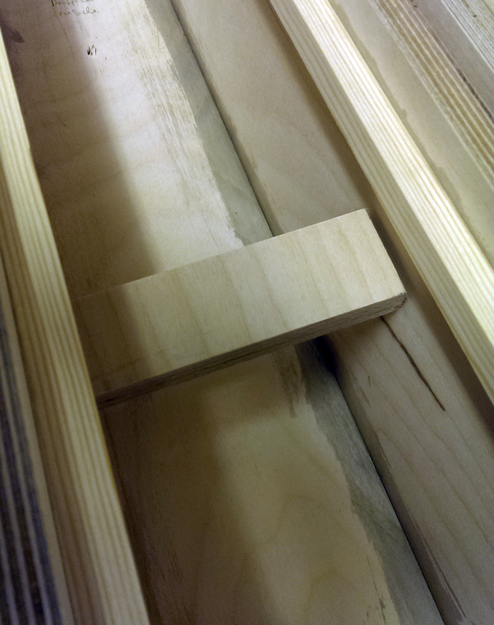

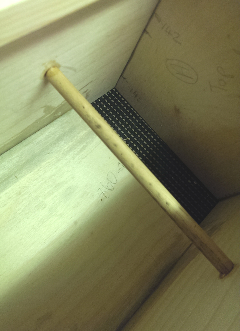

I read Earl Geddes advocated using lots of dowels to brace the inside with, adds stiffness but I guess doesn't resonate as a braced panel would. Dowels going in both directions. I think anything would help? Random pieces in random places should help to break up standing waves, or would this mess with the pensils port loading?
Dowels rather than ply offcuts? I've got a nice length of 10mm dia dowel looking for a home...
I'm worried about messing up the tuning too.

Nice find on the precut ply! Very cool! I'd definitely recommend the bracing. Even on the smaller Pensils, those sides can vibrate quite a bit. I have the larger SuperPensil12 (original version) and did the large bracing as recommended plus additional bracing with dowels. Worked like a charm and got rid of all the panel resonances I was hearing (yes they were audible). Also look into lining the top with some sort of dampening as well as the polyfill through the cabinet.

Managed to get them all together this afternoon and have a quick listen.
Started off with loads of stuffing packed in and they sounded thin - obviously no bass.
Took out most of the stuffing (70%), leaving just a little bit at the bottom - sounded wierd, bloated, like an empty box. Not nice.
Put back half of the stuffing and they sound much nicer, but still thin sounding - no real body to the sound.
Switched on the active sub and its coming together now. Sub has the crossover at 80 hz.
I've not run them in at all yet, so volume levels are really low. How will the sound change with a few hours on them?
Slightly disapointed, but Will persevere to get them to give their best - any suggestions for me?

Amp - the smaller Toppings are nice enough little units, but even after full break-in the TP20 could be underpowered in terms of dynamic range for this driver.

Room - if situated in same location as the stand mounts shown in opening post, you'll definitely need the sub.
