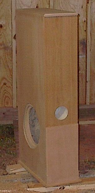

I'm almost finished with my new main speakers and thought I would try to get some opinions before I start cutting holes.
Total enclosure is 44 inches high, 10 inches wide and 22 inches deep.
Proposed drivers are:
12 inch Titanic sub in the side (ported)
1 inch dome tweeter (thinking Vifa D26TG-35-06)
2-6.5 inch Peerless HDS (sealed)
TMM config first order passive xo
12 inch on seperate amp and xo
I'll take care of baffle step comp. electronically
3/4 inch mdf with lots of bracing and seperate chambers for mid basses and tweeter.
Honduran Mahogany veneer and solid Mahogany top and front bottom. I'm also making a grill to fill in between solid panels with a sub baffle to bring the drivers flush with the grill frame.
I built the chamber for the midbasses .5 ft^3 when I first thought I would use th 850467, but I'm now thinking I would rather use the 850439 without the phase plug. the response above 4500 hz looks like it could create problems with a first order crossover.
I also still haven't pinned down a choice for the tweeter, so any suggestions are welcome.
My last set of diy speakers were Dynaudio 17W75 with Dynaudio Esotec dome tweeter. Time, cats, a toddler, and years of compensating for missing sub with EQ has taken its toll and its time to move these to my office computer.

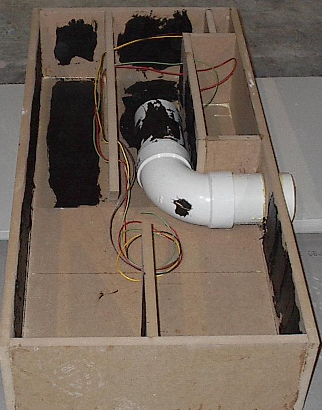

I'll try pics in next post.
Pics
The black stuff is about 3/16" asphalt for dampening.

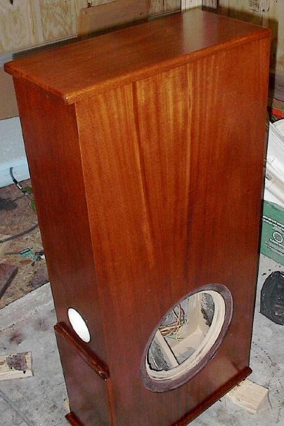

I've been distracted from this project for 3 months with my Aleph 2+ s and work. The drivers should arive tomorrow. They have 3 coats of poly, but need more. I only hope the sound is half as deep and 3 dimensional as the wood grain. I settled for a Peerless tweeter for now. The 811815 had a nice off axis response, and they will get a lot of use as background music. I may upgrade later.
Now I need suggestions for crossover. I think I have enough reponse overlap for first order. I like first order for the minimum phase error. I'm using 850439 HDS 6.5 with out phase plug to avoid the climbing sensitvity beyond 1.2KHz.
Give me some feedback

Nice woodwork. take care so that they wont be to bassy. They look like they could have that ability (check so that tot box qts in the sealed box is approx 0,7 and divide the 12 inch at 100 hz) Put them on spikes or somtging like that.
When using first order electrically, i think you may want to pull the HDS basses down early or ,due to the risning sensitivity in mid range, otherwise they will interfere a lot with the tweeter. Maybe at 1kz or just lower. Then divide the tweeter at 3kz or so, io with at least an octave apart.

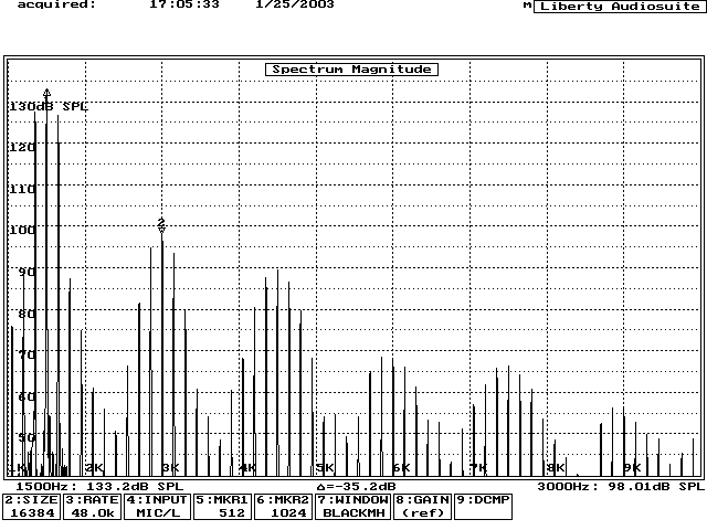

Don't discount the Peerless tweeters. I use the shielded version of the tweeter you mentioned, and it's a steller performer. Testing it's IMD shows that the tweeter has quite high performance, especially considering its price. Peerless is the only one I know that uses the 3 15/16" flange instead of 4.08" like everyone else, but other tweeters that are good buys/good performers are:
Vifa TC26SG
Seas Excel T25001 (the cheaper one)
Seas 27TDC
Morel MDT-30
I've attached an IMD test using 3 tones 1350Hz, 1500Hz, and 1650Hz for this tweeter. The worst case distortion is 1.77%. The tweeter output level is scaled for 90dB at 1 meter, for most crossovers, 90dB at 1.5kHz is way louder than you would ever listen.
