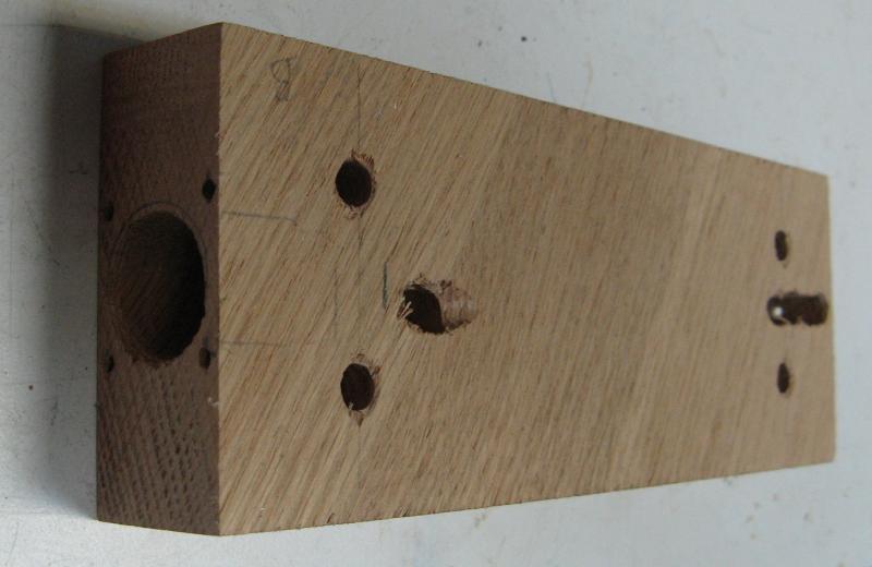

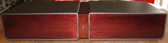

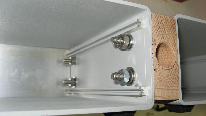

Here the Pearl enclosure. It is recycling of two computer printer port switches. These boxes were very nicely made of strong alu extrusion with nice powder paint. However, the color was the tame computer beige, not very exciting. And the just one channel fits into one box, so I needed two of them. I painted in the case in grey metallic color then connected both boxes using a piece of maple. They are hold in place strongly by 4 stainless steel bolts. I use matching wood veneer on front to hide the original awfull front panel. A blue led will light in the middle.

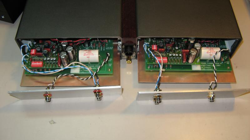

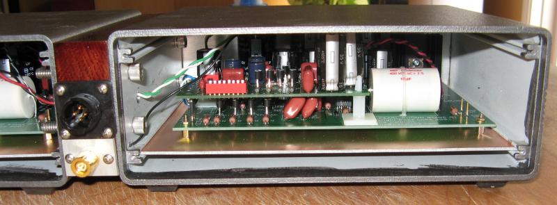

Here a detail of one channel. The gnd lug can be seen just under the power connector. The enclosure has a nice PCB slot already built-in. I mounted the PCB on a piece of bare PCB (grounded to the case in the slot). To mount the preamp, just insert the PCB, connect the wires and you're done. The wires are long enough that the PCB can be probed outside the case for testing. As said before the GND lug has two wires, one per PCB, conencte to each PCB star gnd point.
Well, beauty is a matter of taste. In real it is very nice. I wanted something that looks different than all the rest. I got it 🙂

Thanks for the nice comment. These enclosures are recycled printer selection switch boxes. They were just too nice to trow away. But too small to mount both channels in just one box. This is when the idea to mount two boxes using some kind of spacer came in. I also needed some way to route the power connector, GND and power indicator, without disturbing each channel. This is why I mounted them on the central section.

What puzzles me that many (most?) people put those white Mundorf caps into their Pearls (and PSU). To my ears they absolutely ruin the quality of the unit and add some kind of mechanical harshness. Of course your milage will vary.....

I've tried a number of vintage caps (PIOs/MKVs), a 'lowly' Roederstein MKT (all more musical to my ears than those Mundorfs) but 'best' of all (to my ears): Russian PETPs. Of course YMMV as you've got different rooms, equipment and...ears 😀.

I just didn't know any better when I built my Pearl. I'm all for trying something else. Are the Russian PETP's you reference the K73-16's?

K73-16

Yes, those are the ones. At the moment they are my favourite caps - not ony in the Pearl.
