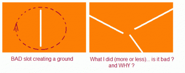

OK,
I finally settled down for the following layout and design.
It is still quite compact (although not as much as I wanted originally, but I had to make compromises)
I decided to keep a combination of Star grounding and Ground Plane (star ground to isolate the ground from the rectified current and avoid ground loops, and plane to provide some RFI protection)
The argument/analogy with the 3 antenna made me think a lot but I finally decided to go for it anyway with the following reasons:
- in the case of 2.4GHz GSM antennas, the use of multiple antennas does not intrinsically increase the radiation, but rather makes it omnidirectionnal. My opinion is that using 3 antennas will not radiate more than one if there is the same power at the input.
- This is a shunt Reg working at audio frequency, not a high frequency switching circuit, so it doesn't radiate in the first place.. I guess I don't need to worry of RFI anyway
- ... and this is DIY after all.. who cares if my design does not pass the EMC tests!
Unless I receive any further comment on the design by then, I'll send the files to the board house this week end (if I succeed in making the Gerber Files)
I want to thank all of you for the very usefull and informative comments on the design and how to improve it. I guess I learned a lot from this thread on designing PCBs and RFI theory !
