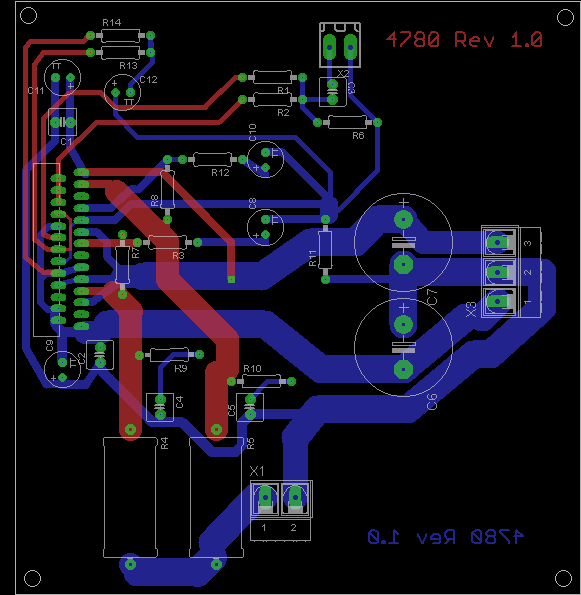

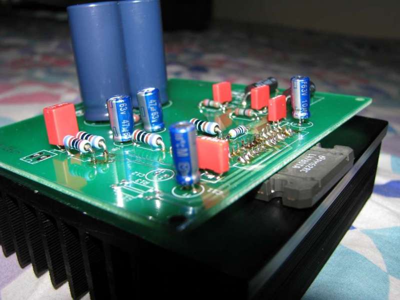

my paralell LM4780!
I have made a pcb using national's art work as a guide, it may not be upto scratch..it works without any hum hiss and sounds good too.. comments welcome..

trace and lead lengths connecting C1 to C2,
yes, the C1 & C2 decoupling are close to some of the power pins. But look how far apart they are.
The zero volts of the decoupling should be connected to each other. It's the way the currents want to flow. The decoupling is like a temporary battery for very short term transients.
