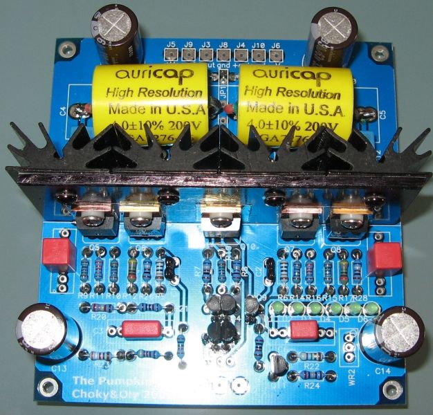

Algar_emi said:Just made my custom heatsink, looking better than what I was expecting to use at first. It is made using 2 X HS276-ND from Digikey, cut in two, then screwed on an alu plate.

It cut the heatsink on my bench saw, using a non-ferrous metal blade. Then, I used a belt grinder/sander to remove the cutting leftover.
Then, the 4 heatsink halves and the 1/8" aluminum plate were fixed in a small jig that I made to keep everything straight and well aligned. Nothing fancy, just a piece of wood, an piece of metal channel and two clamps.
I put some heatsink compound between the heatsink and the plate before assembly. They were all drilled together at the same time. Then I tapped the holes using a 4-40 tap. It took about 45min per heatsink assy to make. I did it in one Sunday afternoon.
I didn't try to save money. Just to make some nice heatsink and have fun...

Algar_emi said:............ Just to make some nice heatsink and have fun...
well - you certainly succeeded in that .

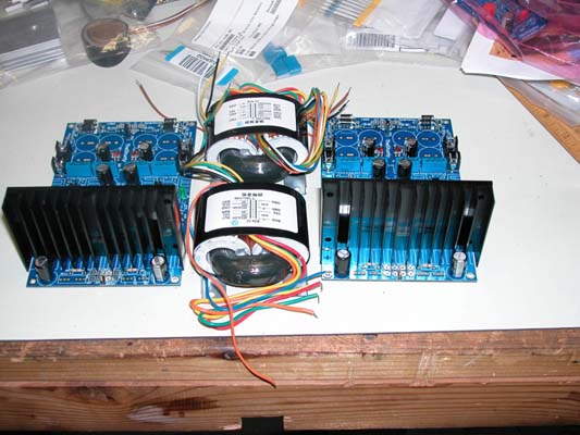

Nice, I did the same but larger on my F4 heat sinks and they literally wick heat away from the plate. R cores arrived they look sweet - ZM this may be my last preamp (he he - said that three preamp s ago).I am going to try to get a friend of mine to bring me 12 of the little TO220 heat sinks with her when she comes over from France, so I will have two spare sets.
