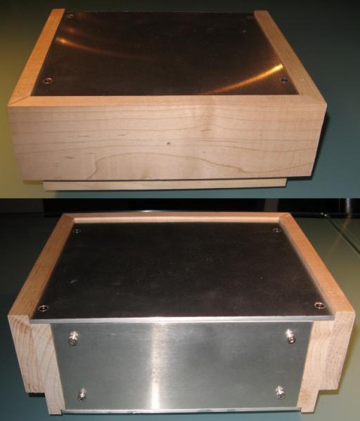

I'n my spare time from the Maxon GB 2007 (and night and weekend :cannotbe:), I started to work on some enclosure to mount the Pumpkin preamp. I bought a set of PCB a few weeks ago. I'm collecting the parts for now.
The preamp will have a separate supply module that will contains a custom Plitron surplus transformer that I got directly from Plitron. It is hugely overkill. It has also some extra secondaries, one of which I will use to supply the preamp digital section and input selection boards, more on that later.
This is the transfo enclosure. It is made of laminated dried maple on the outside. The inside is a complete aluminium enclosure. The top has some spare space reserved to receive a plate of black tinted glass or black plexiglass for a nice finish all around.
I'm still working on the preamp enclosure. It is built the same way but has 1/4 inch alu inside side panel and a center 1/4 inch alu spine for extra case rigidity. The central spine will also insulate each channel from each other.
I'm planning to use my Placette attenuator kit as volume control. A set of external connectors will allow the Placette to be used by itself if I choose to. The Placette I have is fully balanced, as needed by the Pumpkin. The kit will also allow volume remote control. The processor and LCD Placette control PCB will be mounted on the front, inside the wood. The back will be closed by an alu plate for shielding. The processor and relay will use a separate digital supply. This supply has a built-in EMI filter.
The source selection will be done using a selector switch and back mounted relays PCB, close to the inputs conenctors.
The preamp back is made of brushed, anodized panel that I recycled from an other enclosure. The round notch on the back will receive the input power connector.

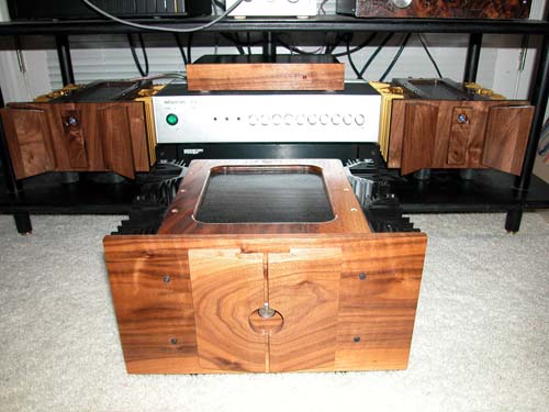

I agree, I have limited metal machining tools, however wood is relative easy to machine. I like to refer to mine as the Pass woodies. I was reviewing your 2.2 BOM as mentioned R20,23,24,25 on Pumpkin need updating. On shunty D6,6a,7,7a leads are to big for holes, C19a),C4(a) C12(a) need to have 15mm spacing. C17,C17a,C18,C18a, Is Wima ok to use in place of ceramic (plead ignorance on my part)? I appreciate your work on the BOM Have you had any luck with heatsinks? I looked in all my catalogs and am unable to locate the ones used on Q1,Q1a. I will make a trip to Apex JR soon to see if I can find something suitable for the larger heat sinks, if something looks usable I can pick some up for you.
