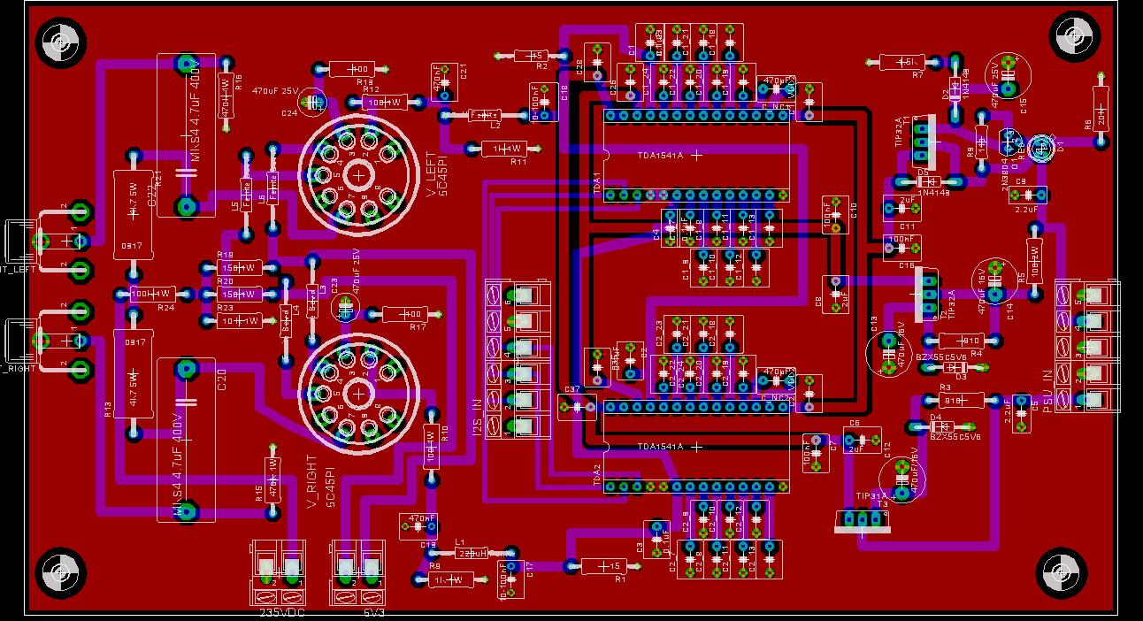

some news.
1- The PSU board for the controller, DAC, mechanics has been designing. It remains the delay issue see HERE
2- The controller board is completed (based on the PIC18F452)
3- The DAC is almost completed. It remains to check the routing. Please find the BOARD. The TOP layer is the GND plan, including some signal routes.
Do not hesitate to comment if you find something wrong.

My CDPRO powersupply incorporates a pair of relays. The main power turns on the 9 Volt power supply which powers the drive and two relays. One relay turns on the 5 volt supply section, the second latches the 9 Volt supply on and a third relay powered by the 5 volt section reverses the power switch function so the 5 volt supply switches off first.
I know it is cumbersome but I needed a simple circuit to control several different power supply schemes. I have ALW regulators being fed by Digi01 and Bigparsnip rectifier boards.
I am still waiting for the promised interface for BrianGt's CDPRO controller that can provide a power up sequence via relays!
BTW this only works on my test bench as my unit is still in a bazillion pieces.
Regards
Anthony
Anthony
Quite strange since I understood that the startup sequence should be the opposite.
The +5V for the servo first then the +9V for the mechanics..
While turning off, first the +9V then the +5V...
