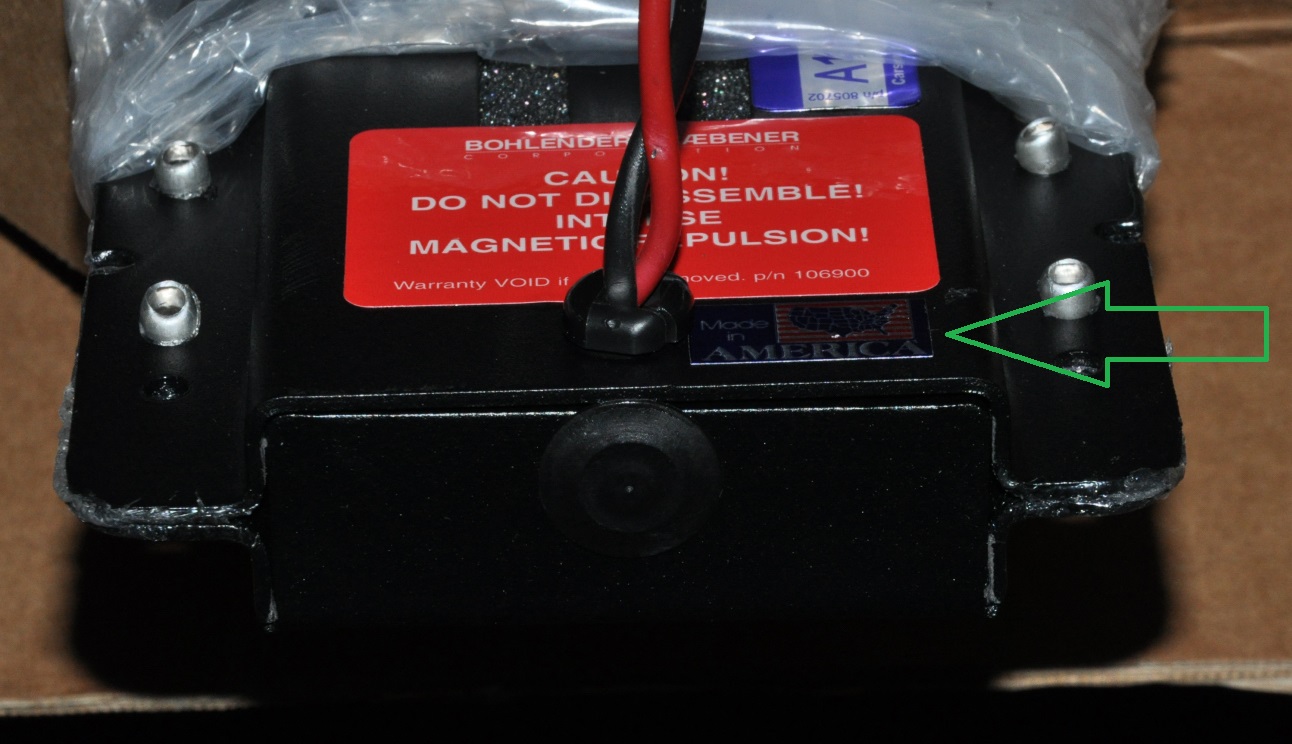

B&G says that the RD-75 is made in America. Or maybe its just the sticker that's made there....
Tianle confirmed me, they are not the supplier of B&G.

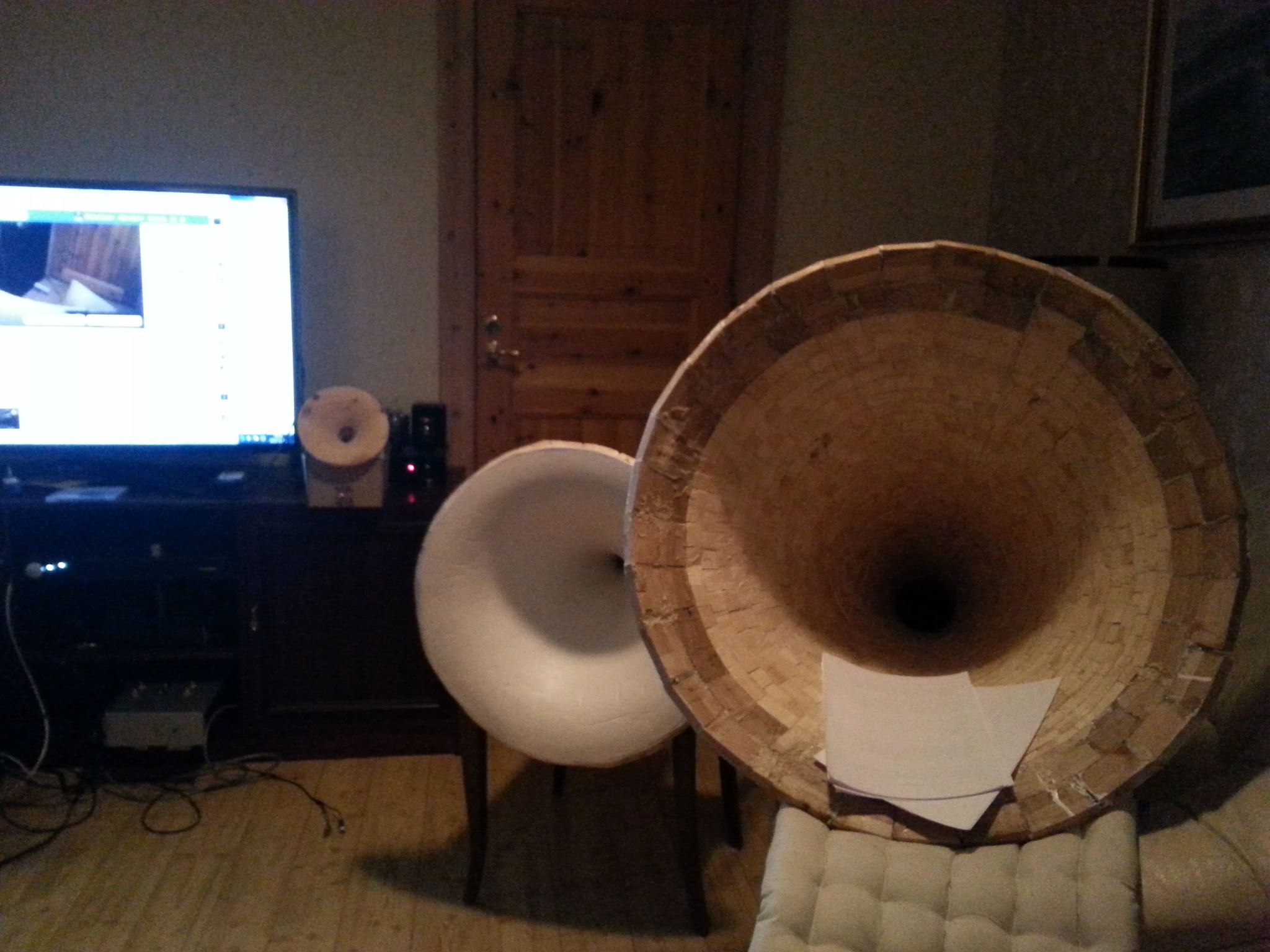

Here is a picture of my somewhat impotent 4-way horn system - I am missing three pair of horns still.
