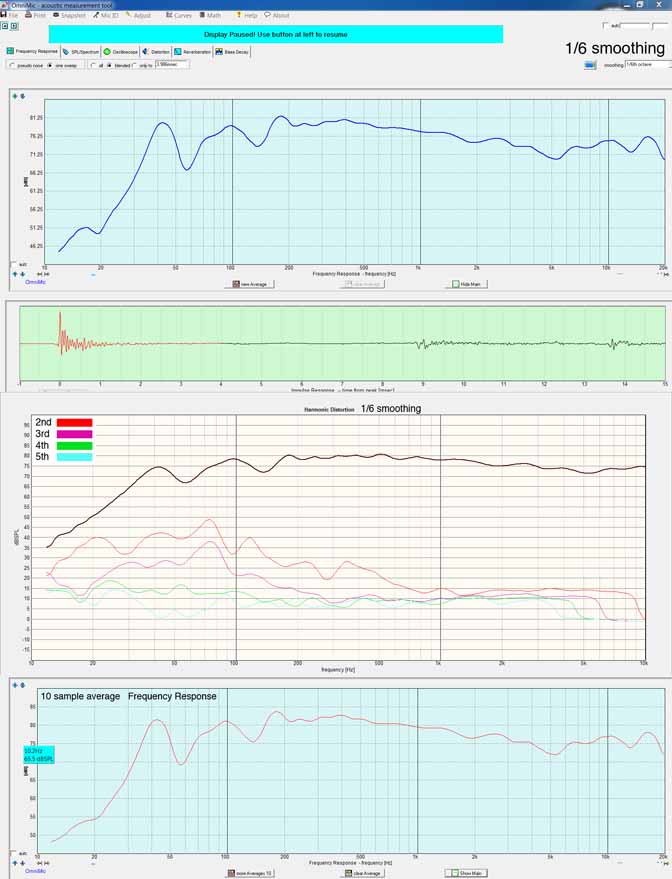

I finally got everything together and had a chance to take measurements of the Magnepan 1.7's.
I really want to take measurements outside, but that will take some time before I get the chance.
These measurements were taken indoors, 5' (~1.53 meter) from front wall, 5.9' (~1.8 meter) from the side walls, and 8' (2.44 meter) ceiling.
I used the Dayton's OmniMic measurement system. The microphone was 1 meter from speaker, gating set at 4 milli-seconds, no audio equalization. Five sets of measurements were taken with different smoothing levels, no smoothing, 1/24 octave smoothing, 1/12 octave smoothing, 1/6 octave smoothing, and 1/3 octave smoothing.
I will try to attach a screen capture of the 1/6 octave smoothing, and the NO (0)smoothing Impulse Response text file. The Impulse Response text file is in the .frd file format, the file suffix was changed to .txt so that it could be uploaded, it can simply be changed back to .frd if you want.
I hope the attachments work the way I think they do! 😕
Let me know if you want any of the other files.
At the bottom of the photo is a 10 measurement average of the Frequency response everything else is just one measurement.

Very interesting to see the Maggie 1.7 measurement. It definitely confirms my listening impression of the speaker: there just too much midrange. I think it would sound fabulous with some EQ: lift the top and low end.
I will try to provide impulse response measurement of the RD-75 in a week or so. My CLIO is currently on loan, so I will have to wait until it comes back....

jvern,
your impulse response file seems to be corrupted - the first part (until peak) seems to be cut away.
Do you have any other possibilities to export a IR file - or can you try again?
Michael

MigeO,
The situation is simpler than a corrupted file.
By default: "OmniMic always aligns "0 ms" to occur at the highest peak in the impulse response. Normally, the frequency response calculates from this point forward, and the peak of the response will be the time reference plane. In advanced mode, you can also select to have OmniMic start calculation from a different first point."
I realize the Frequency Response calculation begins at the zero reference point (the highest peak) ... as the manual says, but I just assumed the program would save the entire selected 4 ms (shown in red on graph) to file, apparently it does not. I wonder though if this is an OmniMic program bug.
Well, live and learn. The user manual really does need a lot of work to be more informative and useful.
I will be happy to do the measurements again as soon as I can, actually it is sort of fun, it's just a matter of timing and circumstances.
