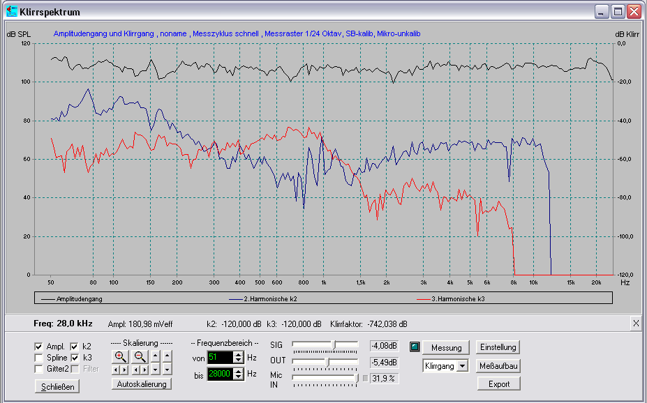

Not in to horn tweeters Erik.
Horn loading gives very low distortion and linear response and there for clear sound. You have to pic out the good drivers and horns.
My current BR-speaker with horn high. Thd the 120dB is faulty it was about 95-100dB when measured.
On the thd figure you can see where the hornloading begins.

which horn
Which horn and driver?
Upto 30kHz. Now I use one 1" that is flat up to 18khz that is even better. I measured -55dB second and -80 third harmonic. At about 95-100dB can't say exactly doesn't matter its clear it is very good performing.
