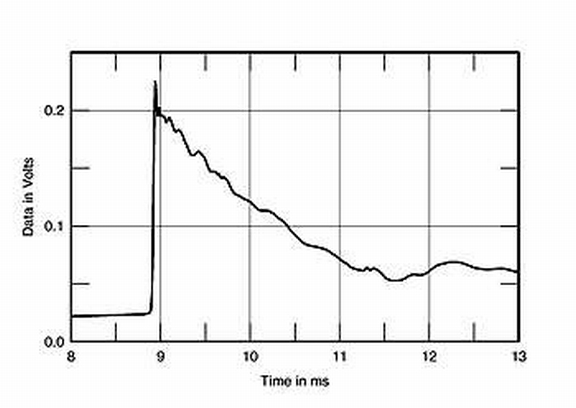

Any analog
sendler, can you link the preringing data you're comparing too? If 60us 30dB down is extreme I'm quite interested in the system that's producing less.
My post disappeared so I will throw it up again. I guess I am just used to looking at impulses from passive cross speakers.
