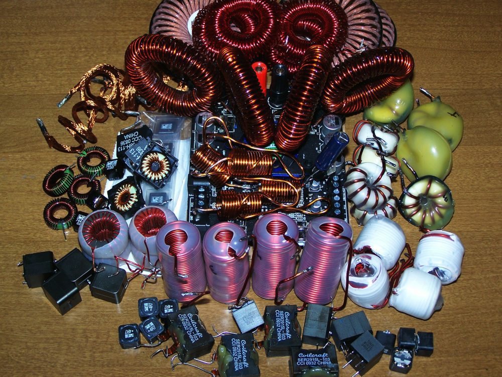

Also flexy enough they don't mess up your beautiful swinging speaker. The MI2 I like to use is anything but so I'm thinking of rigidly mounting it in proximity to lightweight drivers like the Neo3 and Neo8 and then jumping the last inch with the same sort of wire used to connect to the voice coil dynamic drivers. Anyone know a good source for such highly braided, flexy, durable stuff?
Unwrapped Litz wire
I have some 14ga Litz wire left from my adventures in class D output coil winding. Pictured on the upper left.
Long enough is very important. More than connectors, I think. 😛
