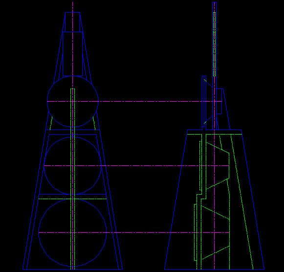

I think I've found the drivers I want to use for the main dipole. The next thing up is to improve a bit on them. The Excel drivers have very stiff, but light magnesium chassi, which rings quite a lot. I will try do damp a little here with bitumen sheets.
For the bass there will be four 21" H-baffles for sure. Two is just not enough!
In time I will build a "finished" version of all this that looks a lot better that the current prototype speaker of course.
Here's a new picture. The only thing new is the amplifiers you can see on the floor behind the main dipoles....

...The only thing new is the amplifiers you can see on the floor behind the main dipoles....
New AMPs or new housing?
