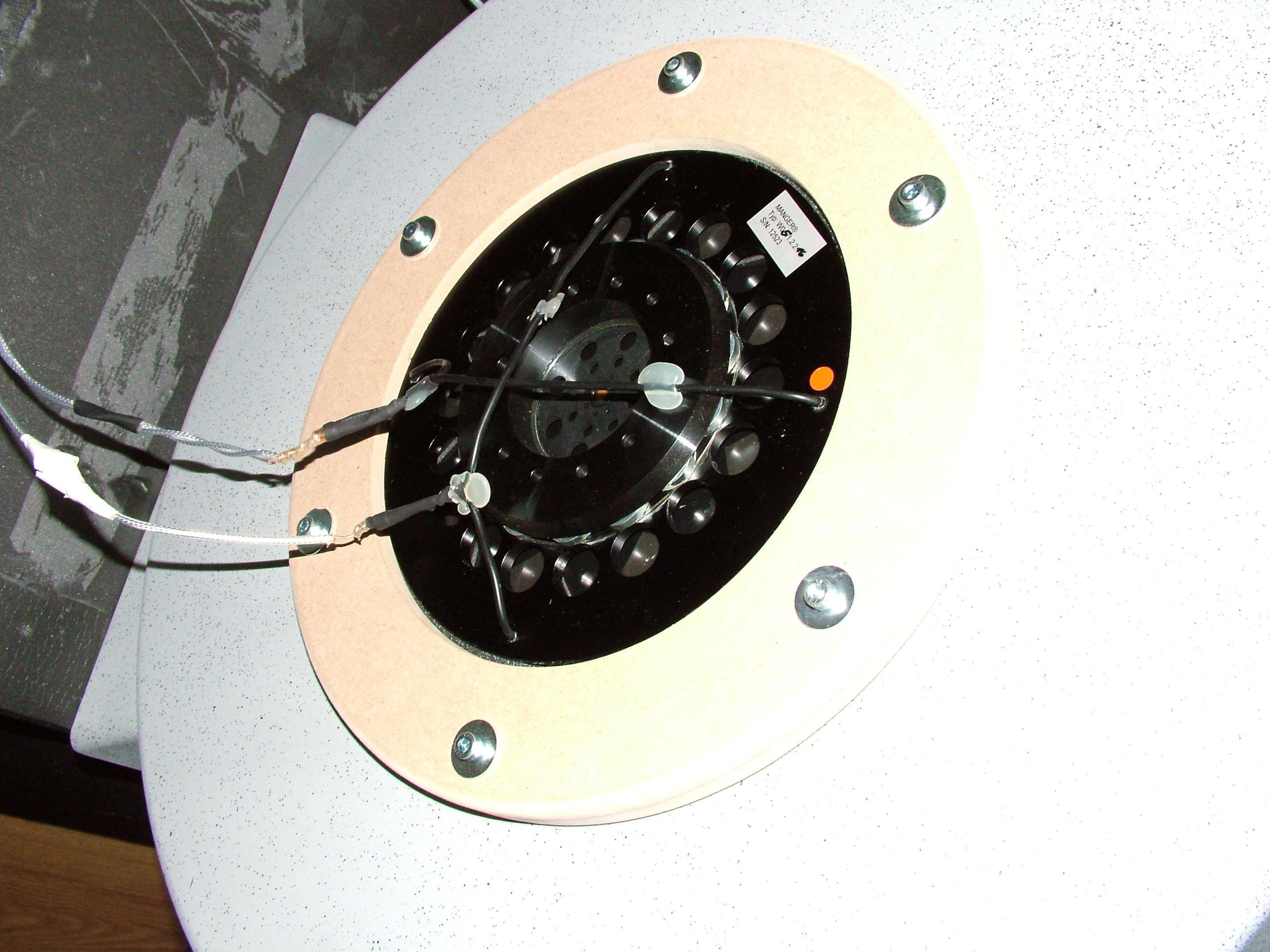

Hi all,
I have been experimenting with free air driver suspension with thin steel wire or soft polypropylene rope, and the benefits & compromises involved when combining the hanging driver with a baffle.
My initial conclusions are as follows:
I can’t hear or measure any difference between thin steel wire ( stainless steel shark trace from fishing tackle shop) and good soft polypropylene rope. But I can feel a slight vibration in the steel wire. I cannot feel any vibration in soft rope. The wire looks best, very cool!
Using traditional “soft mounting” I tried using a 3mm Sorbothane gasket between the Manger and the back of the solid wood horns, but the brass screws created an effective energy path for vibrations and I could still feel the (25Kg!) wooden horns vibrate slightly.
Next I built a “zero contact” wooden clamping system ( photo attached) lined with 3mm Sorbothane to attach the Manger driver to the back of the solid wood horns.
There are no bolts or screws going through the Manger chassis, only bolts / threaded inserts going through the wooded mounting plate and the wooden horn.
The Manger chassis sits in a sleeve of 3mm Sorbothane, no part of the Manger is in contact with any wood, clamp or horn, and no bolts or screws touch or pass through the Manger chassis.
The wooden clamp is tightened only to “finger tight”.
This is a total success and there is now Zero vibration detectable in the wooden horn.
There was a small but worthwhile improvement in the sound. I am only speculating here but I think the very heavy and solid wooden horns will show less of an improvement than a conventional 18mm or 25mm thick flat baffle.
I have found it much more difficult to implement the zero contact clamp when working with heavy 15 inch and 18 inch drivers. They are so heavy...!
My best results were obtained using a rear mounting zero contact soft mount combined with rope or wire suspension wrapped around the central pivot, close to where the magnet meets the chassis.
Then only a very gentle pressure or forward facing support is required to make the seal between the front of the driver and the rear of the baffle.
3mm Sorbothane combined with 3mm neoprene under floor sound deadening material is required to completely encapsulate the edges of the metal chassis.

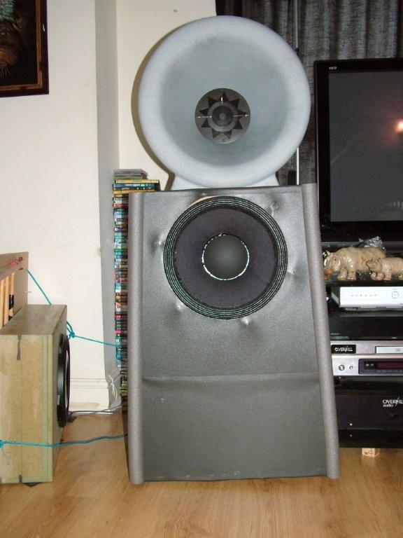

I will attach a photo in another post of my sub 400Hz test baffle, please note the ultra high tech tubular foam edges to eliminate cabinet edge nasties, huge cost £2.99 at B&Q for a pack of 5....!

Hi all,
In this rough test baffle the PD 158 is sweet from 200Hz to 400Hz.
Adding 160mm min depth, 330mm max depth, VPL side wings adds on a good octave or more ie 80hz to 400Hz with no sonic penalty of cuppy vocals and muddy low mids.
There will of course be a an additional 15' or 18' Beyma or Presion Devices driver covering the 80Hz down to approx 30Hz ( more room than driver dependant) band.
Over the Christmas break I hope to complete the drawings for the finished design.
Cheers
Derek.
Indeed! Nice foam work!
Question for you. Is the baffle all foam, or foam covering something else?
Reason I ask is that I've always found foam to be rather transparent in the bass. But maybe not up were you are using it. What have you found?
