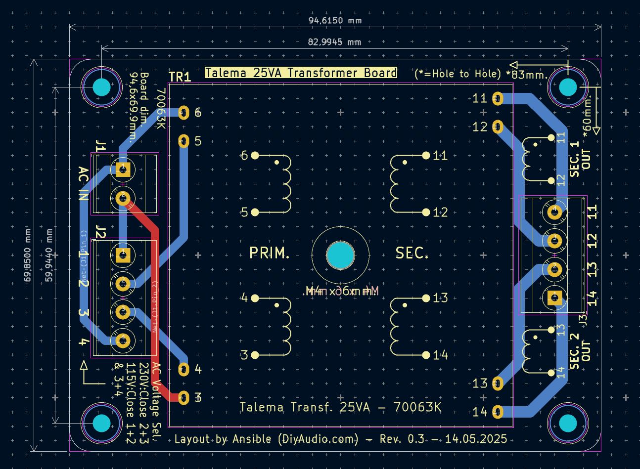

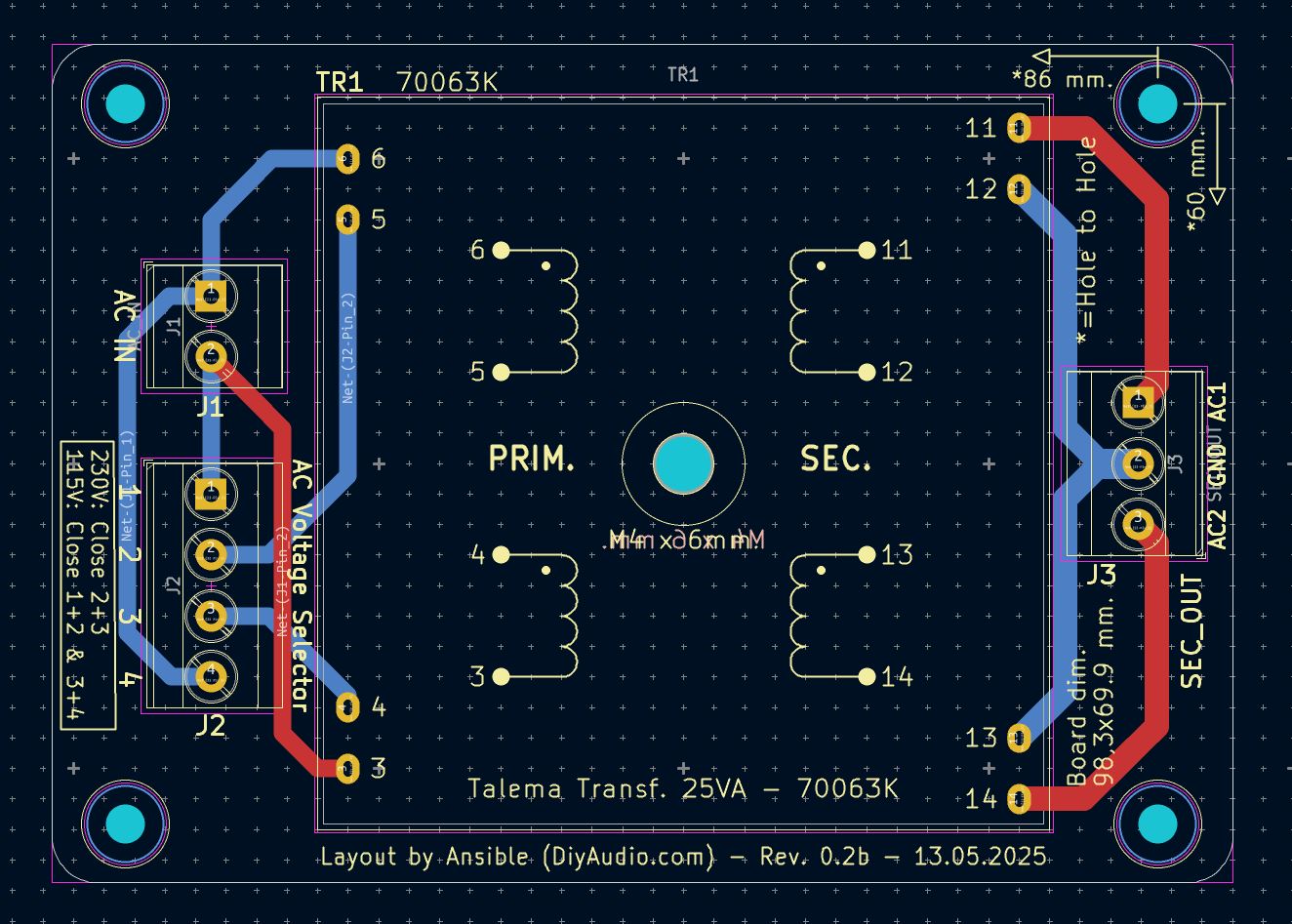

When they are on opposite sides of the PCB, the PCB material will provide the isolation.There is still a single crossing of traces between the primaries (top/bottom).
Could it still be okay?
Yes arjen6t8, I take PCB isolation for granted. 🙂
But can there still be an iteration between AC lines crossing each other, as happens when the insulator is air?
(...with reference to the minimum distance of 5 mm suggested).
In any case, it seems to me that this latest version meets the requirements.
Am I wrong?
Am I wrong?
hi ansible, do you think a R input selector ( like input C selector) could be useful? ( since the cartridges on the market required definited RC loads) ...and a question:why pin 12,13 of transf are shorted?what is the reason? un saluto to everyone Ros

About your second question, thank you.
The answer is that for this particular use (dual power supply), the secondaries are placed in series, with the central connection (pins 12 and 13 joined) becoming the GND line. But it is certainly better to keep the possibility of connecting the secondaries in parallel, as well as in series.
I therefore modified the schematic and PCB in this direction.
(Hoping it is the final one...)
Talema 25VA Encapsulated Transformer, interface board.
Revision 0.3

Talema 15VA and 25VA Encapsulated Transformer, interface board.
Gerber file, Revision 0.3

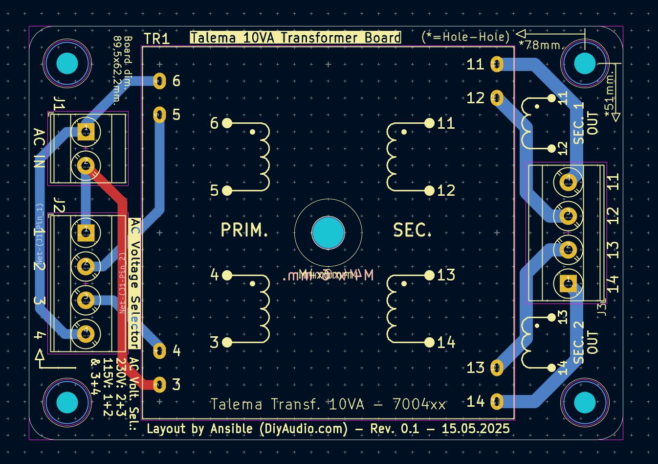

Hi arjen6t8,
I just now realize that this pcb is also compatible with the Talema 15VA version (same size as the 25VA).
The 10VA is slightly smaller (55x55mm.), but it would not be difficult to modify the schematic for that size.
Would it be useful to have it?
(In the case of simple pcbs without components, the cost for 5 pieces is usually really low, around 5 euros including shipping)
If you are not in a hurry, I could prepare it.

I bought the 10 VA version for size. The larger one(s) do not fit in my turntable. I would be much obliged if you want to design a 10 VA version PCB.
Ok arjen6t8,
Give me a couple of days.
The good work you are doing with your turntable is worth a little effort. 😉
