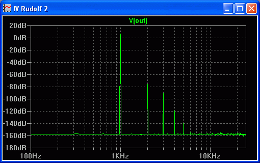

Below are the simulated harmonic distortion graphs of three common base I/V stages. Source output current is 4mA p-p, source output Z is 1kOhm, I/V resistor is 1.5kOhm.
Rudolf 1 is the single transistor between the current source and current sink. The circuit was firstly posted by Jocko and later posted by Rudolf about year ago. The circuit is supplied by +/-18V and signal transistor runs at 7mA.
Rudolf 2 is a few months old Rudolf’s circuit with folded cascode (not super pair). The first (input) transistor runs at 11mA.
Third is the one circuit very similar to that one used in the OPA660. It is supplied by +/-24V and the first stage runs at somewhat less than 4.5mA. However, the circuit exactly used in the OPA660 can not show this performance regardless of the used voltage and current. Or at least I have not found the way to do that. Judging on the OPA660 model provided by BurrBrown, with the same 1kOhm Out Z, 4mA p-p current source and used as common base stage with 1.5kOhm I/V resistor, it will have about 0.06% THD (mainly third harmonic).
Simulations are done using BC547C/557C models by Philips.
For possible better insight, the same circuits with the same operating points simulated using 2N4401/4403 models by Fairchild.
The graphs are not supposed to claim anything about the sonics. Especially I do not have an intention to claim that the last shown circuit will work better than the first two. Btw, even better numbers are achievable using a complementary feedback pair.
Pedja

Pedja said:Below are the simulated harmonic distortion graphs of three common base I/V stages. Source output current is 4mA p-p, source output Z is 1kOhm, I/V resistor is 1.5kOhm.
Thanks for the graphs Pedja. Very interesting results.
Yes, this one is SE, non cascoded and shows a fair degree of
non linearity
This one is a bit perplexing. I don't understand why H2 has
been attenuated compared H3. I would have thought the
cascode AND higher current (11mA) would lower all harmonics.
On this premise H3 should be lower than -80dB. Maybe the
cascode is non ideal, but looking at specs of 2SA1085 all looks
good up to 10mA (HFE linearity).
I am looking at the OP current source as a possible culprit.
If you have time, try cascoding this.
I'm sure the super pair will improve on these measurements,
but Rudolf, maybe the OP current source should also be
a super pair to make it more ideal. Food for thought.
Does it include current mirrors or complimentary cascodes?
I am surprised it simulates so well. If you can explain circuit details
next time I have AP1, I will knock one up and measure it.
This is more the level I would expect in real life if not a little
better.
WRT CFP, yes of course, I would expect at least 20dB
Pedja
improvement.
Also I would try simulations at 10kHz. When I did
measurements, this often really broke a particular designs
back. Where as many designs measured well at 1k some had
20dB or worse results at 10kHz. I strived for almost flat
measurements from 1kHz -> 10kHz. I think this is where
designs like super pair will excel.
So what have we learned? I'm not sure, however I would
certainly like to run simulation parallel to physical measurements
next time I have AP1 in my hands, this will answer a lot of
questions.
What software are you using, where can I get it?
Good post, thanks for the effort. 🙂
PS All this typing is chewing up my DAC building time🙁
Terry
Terry, I have looked again through this and take my apologies, the first transistor was running at 11mA but cascoding device on 3mA. I raised this to 8mA and the result is below (so consider this instead of the second graph in the first string above). Of course, all this puts higher demands on the (upper) current source which should then provide 19mA. As about this current source, I tried earlier two ways to improve it in the basic circuit and both showed lower harmonic distortion but in this regard it seems not to be that important for the cascoded circuit.Terry Demol said:This one is a bit perplexing. I don't understand why H2 has
Just drop me an address on react_71@yahoo.com .Does it include current mirrors or complimentary cascodes?
Linear Technology SwitcherCAD, free, fully working, serious SPICE program, downloadable from here:So what have we learned? I'm not sure, however I would
questions.
http://www.linear.com/software/
Pedja

Thanks for the update Pedja,
Looking at these results, seems cascode can be improved
slightly but thats almost another thread. I am wondering whether
SwitcherCAD takes into account noise generated by current
sources. The noise floors you are getting appear to be very low,
almost too low?

Hi Terry,
Interesting notice about the current source noise.
Re the noise floor on the graphs above, actually, none windowing was applied in the FFT, and Blackman and Hanning will bring improvement of further 20-30dB. Since in this case the noise floor looks a bit nervous, for the sake of the visual elegancy I left the “raw” FFT’s nice flat line. I do not take this too serious because many noise sources that will appear in the real world are certainly not modeled at all.
Pedja
Pedja
Pedja said:Hi Terry,
Pedja
Exactly. However, the OP noise can be calculated if all the devices
noises are known, assuming power supply is not limiting.
It's just a matter of understanding what all the noise
generating mechanisms are. A current source is not just
a current source.
Terry
