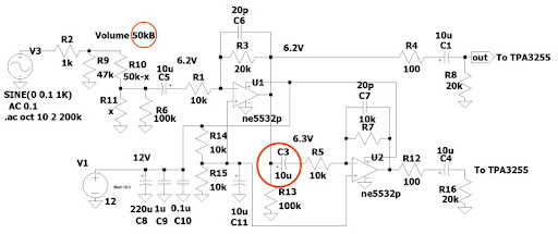

Hi Mark,
I did a bit more research about my audio amplifier (Aiyima A07 with TPA3255) and came across this diagram for the op-amp input section by a Japanese blogger:
However, I could not find a circuit diagram even if I searched the net. Therefore, I made a circuit diagram only around the input. The following figure shows the result of my research.
The signal is amplified by 6dB by the inverting amplifier after passing through the volume, and furthermore, a positive-phase signal, which is the reverse of the reverse phase, is made by the inverting amplifier of the second stage.
The 50kΩB type B input is disqualified for audio use, so it is replaced with a 10kΩA type A. Also, there is a second inverting amp connected after the first stage inverting amp via a capacitor, I wonder why ???? It seems to me that the capacitor is probably included for stable operation, but I don't think it would normally be included, so I will jumper it.
I found an example of jumpering in the same way when I checked the net. The manual for the evaluation board also does not include capacitors, so it seems that it is better to connect directly with a jumper.
The 10μF chemi-con around the input of the op-amp will be replaced with a TOSHIN UTWRZ, which is inexpensive and has a reputation for relatively good sound. Also, the chemicon making 6V was changed to 56μF from OS-CON for more stability. The operational amplifier will also be replaced with LT1364, which has a relatively good reputation.
I know next to nothing about circuit design, but I'm curious to know whether anything's off with this particular circuit and (possibly) how to improve it.

Hi Mark,
Well its seems to have good decoupling and probably won't have too many issues with swapping opamps.
Its volume section is fairly high impedance, changing the volume pot and R6 to 10k would reduce noise somewhat.
