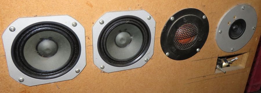

The two 5" square-frame mids shown are from the HPM-150 parts list, but it used only one. The crossover is the HPM-150 unit, and those mids are parellelled on the mid output, which is wrong but it works. The dome is on the crossover's tweeter output, and the small cone tweeter, from the HPM-150, is on the omnidirectional tweeter output, before the impedance transformer (as the omni tweeter was a strange, expensive device and I did not have them).

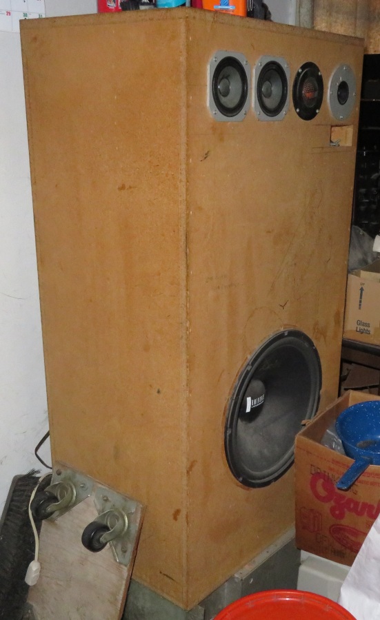

Do you have a pair of those monsters? You could do a lot better with more modern drivers and fewer of them but if the boxes are well made and you want to use them are they well braced side to side and front to back? Do you have a budget? Big woofers tend to cost fairly big dollars
Thak you folks for replying with help on this.
I do have a pair of the beasts. The high density particle board is the kind made for speakers, and although it looks a little dirty they are in good shape.

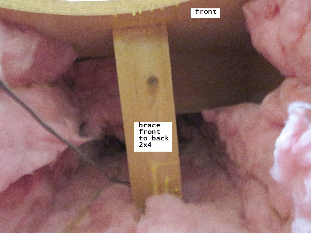

It has a brace from front to back above the woofer. The wood is 3/4" thick everywhere. The mids and tweeters and controls are in their own sealed inner box. That gives quite a bit of bracing there at the top front.
I am on a tight budget so if the present speakers can be used and solve the issue, that would be best. I've seen some of the low Fs 15" speakers on the speaker selection site and they are quite expensive.

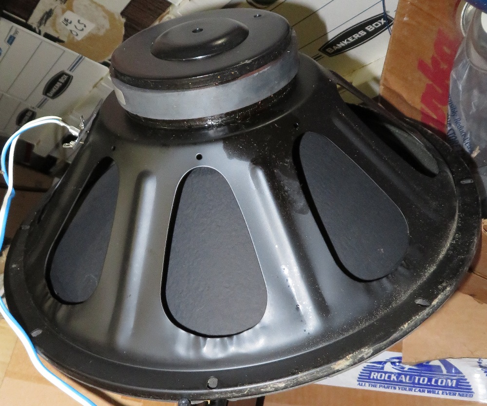

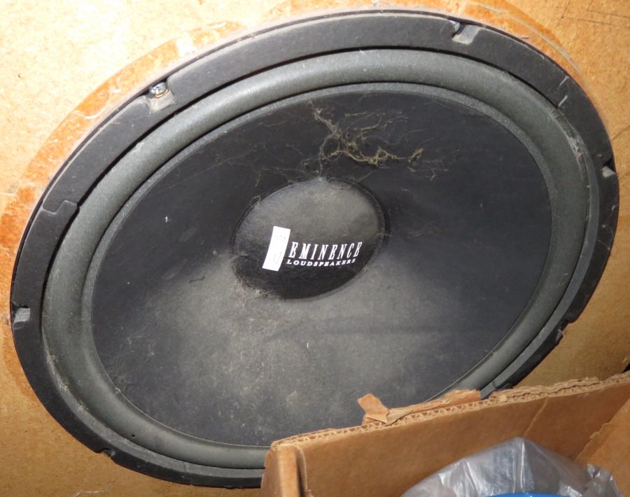

I will have to remove the woofer from the accessible speaker cabinet to try and identify it. Hopefully the model or part number is on the back of the speaker. If not, I will need guidance on testing. Let me get it out first and go from there.
The box is not stuffed, but has some insulation on three sides internally, if I recall, as it was long ago when they were made. I can supply the info soon as I can get to it and pull the woofer.

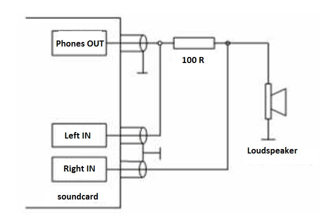

This will be best approached by measuring impedance and then have the software calculate the TS parameters. Prepare the weights for "delta mass" method, like 4 weights, each 25g equally spread around the dustcap. Some use blue tack, others rubber blocks or whatever works. It is important that these are accurately measured for their weight. Search for ARTAlabs measurement suite and the LIMP module is meant for impedance evaluation.

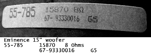

Thanks to Bill McFadden's Home Page, there is a "List of Low Frequency Loudspeaker Drivers 12-May-99" and these woofers are on it.
Manufacturer_________MCM
Model________________55-785
Dia._________________15 inches
Power RMS____________100 W
Z Ohms_______________8
SPL 1W/1m____________93 dB
Vas cu ft____________31.13
Fs___________________18 Hz
Qts__________________0.35
xmax_________________ not specified
So, these seem to be a product made in 1993 for MCM Electronics. There is a date code on them. I'd forgotten the Fs of 18Hz - no doubt why I picked them. Said I didn't know much about speakers!
Xmax not specified- I have seen these move maybe 0.25 inch each direction without bottoming, no idea about linearity at that point but likely pushing things pretty far.
That's all the info I have on these. The speaker test on these woofers may not be worthwhile because the surrounds are about to go (small hole) and the 100W power rating is pretty small for what I'd like to do. 8 Ohms is also too high, want lower Z to make better use of the Ling 1 Ohm shaker amplifiers. Modern speakers give lots of better choices I can see now after looking at a few. I have no objection to 'house brand' stuff but it's time to move beyond the lowest budget performance. I might be able to go $200-300 each, but let that be stated with the caveat that I'm much more influenced by performance now than 20-30 years ago, and willing to save up $ and wait.
The cabinet is not totally stuffed but has quite a bit of insulation. Hmm. I think it's from my old friend the Pink Panther. The front to back brace is a 2x4. No side-to-side brace, but one could be added in there, a lot of trouble but do-able. There is a 1x1" cleat in each corner, running top to bottom. The cabinet can not be disassembled, that is 100% certain. What about the wofer attachment screws? The mounting holes seem OK, but I'd like to improve that situation, but no idea what hardware is appropriate. I have noticed that a lot of 'professional hi-fi' speakers have machine screws.

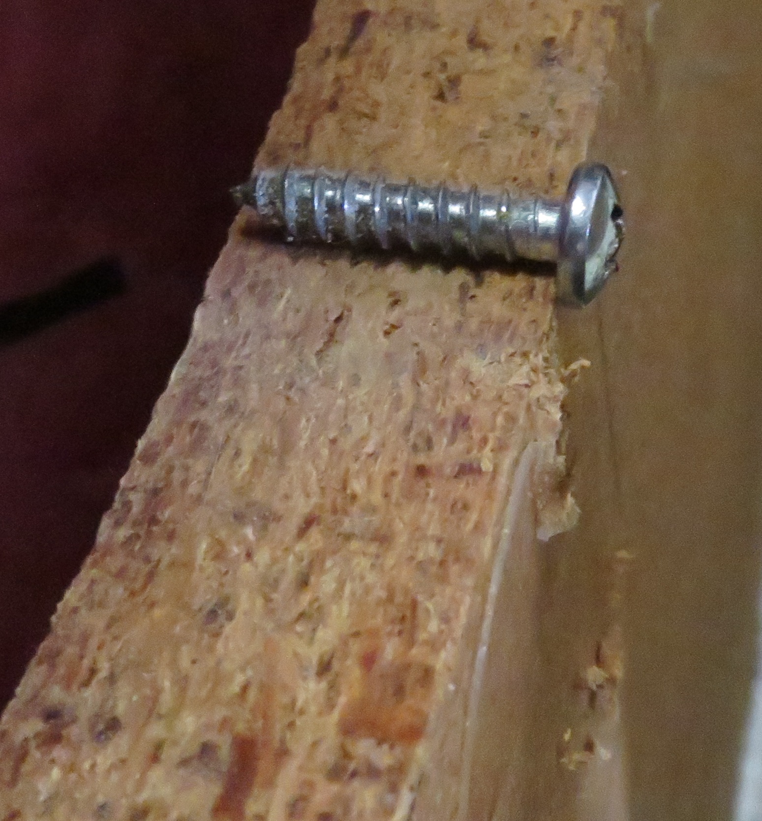

I use T nuts, but a lot of folks have issues because they don't seat them properly, especially in particleboard, though threaded inserts is a good way [both use machine screws]. The main thing is just wood screws isn't a good plan for woofers, except at very low power

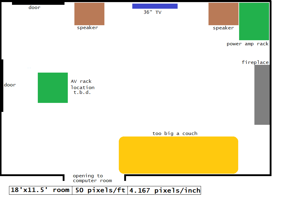

Here's the room, which I am willing to reconfigure but there are limits. It's a modest home in Dallas.
The place is pier and beam foundation - so the poor old AT-PL120 turntable will suffer some vibration, though its weight has served it well before

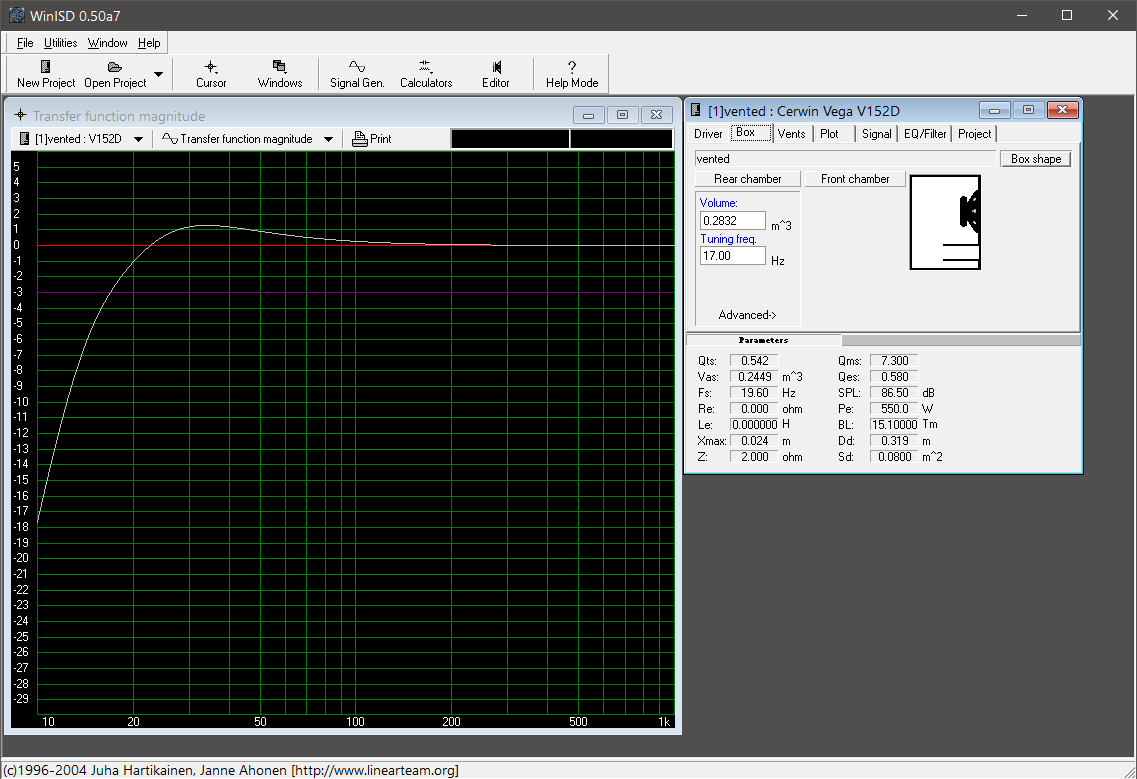

Here's a WinISD project using the Cerwin Vega 15" sub -it has two 2-Ohm coils and Fs 19Hz, Xmax 24mm. There is a port, 5", tuned as shown.
