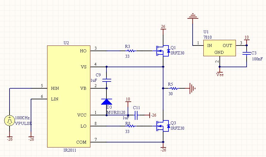

This is a general question:
Consider the attachment -- This circuit would never work because the bootstrap capacitor is never able to charge since the source is referenced to GND through the load resistor instead of -26V.
In general the only way the IRF drivers will work with a +/- supply is if both HIN and LIN are driven 180 degrees out of phase.
Or am I mistaken?

It could not start until the Lin pin is taken high so that Q3 pulls Vs low to charge the bootstrap cap.

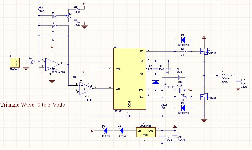

Alright, got a bit sidetracked and put this project on the backburner for a while. In the meantime I did finish up my UcD400 amplifier that was long overdue. However I have revised and recalculated the class-D amplifier as described here to offer full-range performance and will be getting parts in this week (ordered this afternoon) so I plan to have two prototypes up and running soon and then I'll be sure to see how they fare on the testbench. Here's the updated, latest revision of the schematic and a look at my finished UcD400 amplifier.
SODFA class-D amplifier, revision 007
http://hardwareanalysis.com/images/articles/large/11666.gif

Alright, couldn't help myself for wanting to simplfy things ever further and have the feedback after the LC filter. I came up with the following schematic, see url below, after some further thinking. In the meantime I've also built a prototype following this schematic which just needs a final checkup (tomorrow) before I flip the power switch.
Semi-discrete Class-D half-bridge (ver. 008)
http://hardwareanalysis.com/images/articles/large/11667.gif

Thanks Pierre, Chris,
I had it running for a bit this morning but for some reason the top (V+) MOSFET quit on me and the replacement also. I don't know what happened, but I'm retracing the layout to see whether I might've made a mistake, and am also replacing the IR2011, as that could be faulty. When it did play it sounded somewhat distorted, but it did amplify.
Any suggestions are most welcome,

Alright, I'm back to the latest version of the SODFA class-D (ver. 007) as for some reason the simplified version just refuses to work. It does run, but clips against V+ and then burns out the MOSFET and sounds rather distorted all together.
The SODFA however is a different beast, from the moment I turned it on it plays without any audible distortion or other odd behaviour, no hiss or crackles even with my ear physically touching the hexagrid grill that protects my speaker's tweeter.
I'm off doing some measurements with the oscilloscoop and a function generator to see how she holds up. I've been playing through Michael Jackson's Thriller album for the past hour or so and the heatsink is slightly warm at full throttle, the output coil is luke-warm at best. Here's an action-shot of the prototype running MJ's Thriller album 🙂

Sanders it sounds like for some reason it clipped hard as you say and perhaps the bootstrap cap ran out of steam and dropped the gate voltage to the point it smoked. Use a much bigger bootstrap cap so it can hold the gate high for a longer period of time. Why it clipped like that in the first place, I can't help ya there.
Chris
Chris,
Ah, you meant the toroids in the UcD, I was confused as I did not use any toriods (other than the output coil) in the design discussed here. I actually put those in the UcD400 amp to electrically seperate the two compartments. The steel seperator pictured acts to devide the case into two compartments. Due to the toriods less HF garbage gets into the PSU section and vice-versa.
But going back to the amp discussed here, I just looked at the carrier frequency on the scope and it is a bit on the high side, 770KHz, as well as having a fair amount of spiking at the crossover, have a look below. Comments are most welcome as always, as I'm not sure how to intepret the image exactly. If you have any suggestions on how to do a THD measurement I'm all ears as well, would the RightMark AudioAnalyzer work? And how to set that up?

Hmmmmm, perhaps a comparator issue, loosing control at zero crossing?
You need interface circuitry for Rightmark, not sure what, input and output buffers?
I'd hit that up on spice and see?
Do you have a spice simulation of it??
Chris
Chris
Chris,
I think it is some switching issue, since I'm clocked at about 350KHz faster than the UcD I'm comparing to. For reference please see the same image of the UcD below, it has very minimal spiking. This again is with the input muted and the scope attached across the speaker terminals, carrier frequency of the UcD is 400KHz. I'll go ahead and lower the carrier frequency and see whether that changes things somewhat
