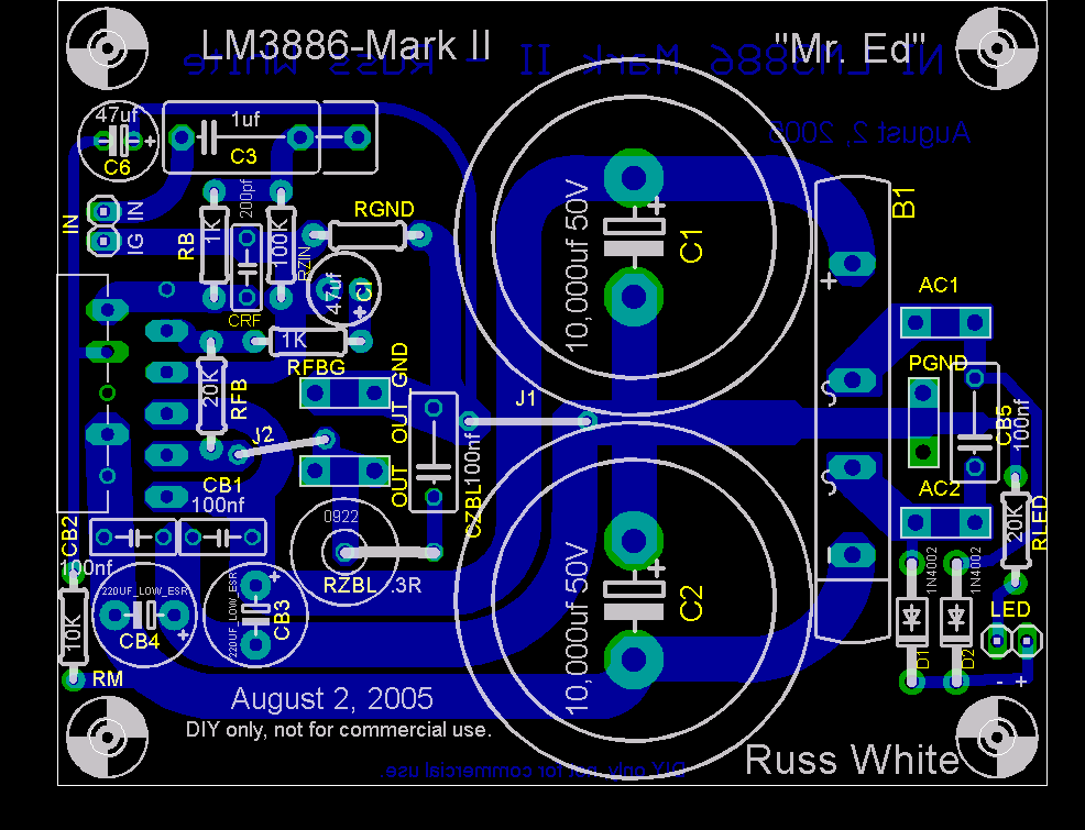

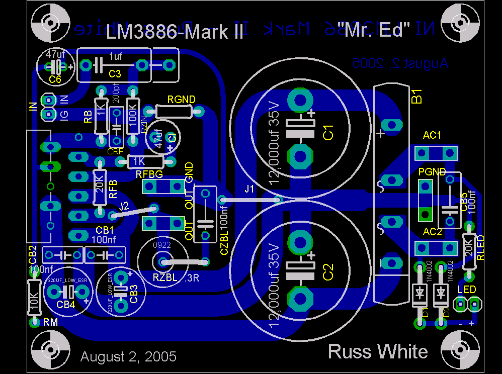

latest layout
As promised, I have tweaked the layout (its amazing what you notice when you actually build a PCB) and increased the size of a few components, mostly to accomodate slightly larger film caps for the Zobel and AC in, and give you a little more clearance in certain spots, plus I wanted to allow the use of a vertically mounted zobel resistor since I have some 5W jobs that are huge. 🙂 You could still use a smaller resistor there without issue.
Cheers!
PDFs of copper and component layers to come. 🙂
there is something i dont understand. after following this chipamp forum for over a year, i've been told over and over that too much capacitance in the power supply ruins mids and kills highs. so russ, how are you getting away with so much capacitance without a snubber??
Good question, as long as you use good bypass caps(the 220uf and 100nf on my board) your highs will not suffer in the least. I have done extensive testing with all sorts of snubber arrangements (my own and Carlos') and found the scheme I have chosen here to be quite ideal. I can assure you there is no lack of nice airy and detailed highs, as I am listening right now to the nutcracker suite, and the bells and picolos sound great! 😀 :up: The bass is also very tight, not loose or out of control at all. Low ESR caps are critical here. I used panasonic FCs for the electrolytics.
You have to take a lot of what you get out of DIY audio from experience. I have built dozens of amps and dozens more PSs and experimented with them all. You will not be disapointed. 🙂
Cheers!
Russ
So your saying you prefer your simple bypass cap solution vs carlos' cap+R solution? Can you give any insight on how they compare?
and it also boggles my mind how no one in all this time has tried simple bypass caps 😱. everyone's been using low capacitance until the snubber came along...
Yes, I prefer the scheme I have chosen over any snubber solution. The design choice it quite intentional and deliberate and born out of hours of research and testing, and many a lunch hour at the UT lab. :smash:
I have a lot of respect for all the work that went into Carlos' snubber design, but my ears and the scope see no benefit in it to recommend it over what I have here.
Now be sure you keep this in mind. I design for myself, and what I know is good "for me". I love the sound of this amp, it is controlled and transparent. I am sure Carlos and other love theirs just as well. 🙂
One of the nice things about designing your own work, is you have every prerogative so utilize what you trust, and what you know from experience. 😉 😎
Cheers!
Russ
what about bleader resistors for those big caps?
just for clarification: from your personal experience, you are saying adding the snubber arrangement did not produce an audible difference or it did produce a difference but that you didnt like as much?
I thought about bleader resistors (and have them on some of my other amps), but I prefer to omit them as I do not like the constant current draw. it would be simple add one (or two) yourself, just drill a couple holes in the rails. Or solder them to the leads of the caps.
As for my impressions of the snubber, it is not that it introduces anything negative, but it is different, just not better in my opinion. Most of the benefit of the snubbered PSU in my experience is simply the better bypassing. I have kept the bypassing, as that does make a huge improvement both in sound and in stability. 😀
Cheers!
Russ
