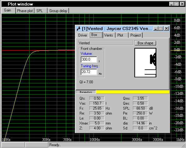

I (being old) am not so much interested in wrecking the house with a dB deathBox as simply being able to go down LOW!!! To that end I am going to go haywire with bracing the box internally. I have figured out a really effective and simple way to do this. Will post a model of what I intend to do. Basically it involves using a strut from the centre of one panel to the centre of the opposite panel. I think this is better than simply stiffening the panel because as one panel tries to flex out under air pressure, the opposite panel tries to bend the opposite direction so they both pull on each end of the strut, which as far as each panel is concerned appears to be *absolutely* rigid.
They're gunna be 300 litres each plus ~25 litres for bracing and driver. I'll just have to try them outside one day with a selected track.

Circlotron, id say dont do it, 2 drivers in 600L of volume have lower output than a single shiva in 85L, and a 142L shiva will go as low without EQ.
and when i say more output, the shiva has 7db!!!! more at 30Hz, and that is room shaking bass, and then below 20Hz it still ha more.
A Shiva is $300, but when u consider the cabinet cost of a 600L box, or 2 300L boxes, an 85L or even a 140L is much more appealing cost and building wise.
And on top of all this the shiva is an audiophile quality woofer thathas rave reviews and amazing performance to dollars ratio.

Room gain?
Hello,
Did you allow for room gain?
If this is a maximally flat anechoic simulation you gonna get a hump in a real enviroment.
Just a reminder, many people prefer their bass like that though.
Hello,

I dont take into account too much for room gain i dont know,it may be too low and i may have insufficient output.TOo much output can simply be EQd out.Hello, did you account for room gain/
