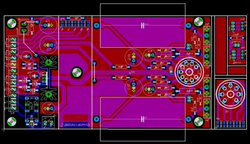

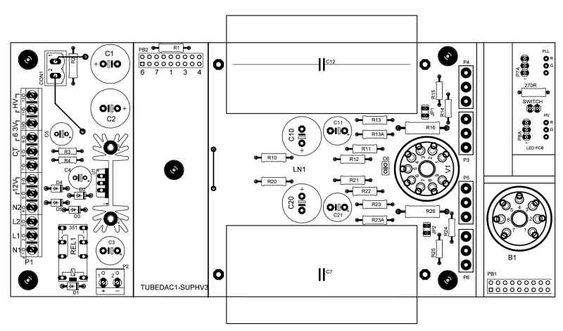

I did a design of a PCB for this tube section. Inspired from Guido Tent original HVSupply PCB it as these features:
-Support external supply transformers using an input terminal block.
-Support external CLC choke using insulated Molex connector
-Accept 6922 or 6N1P tube. You can install a bigger separate filament transformer for the higher 6N1P filament curren, select a different cathode resistor using jumper and the filament voltage regulator is mounted on a good heatsink.
-I added on the left over section of the PCB a small section to easily connect the DAC two leds and HV switch to the front panel.
Here the PCB schematic.
