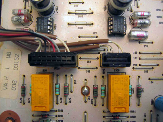

plops
Tom,
Look at the output relais.
They prevent the plops when switching on.
I did change mine too, it was broken down.
Do you hear a clic from the two relais when switching on after a second?
Peter.
