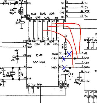

One thing about it though is the muting circuits don't appear to be working properly, at switch on and off there are some really nasty pops, is there an easy way to diagnose/fix this? The relays do appear to switch on and off with the power but not at the same time as my other CD80. Any ideas would be appreciated 🙂

Try to get hold of schematics. Maybe the timing of the muting circuit could be somewhat improved.

I think its caused by the non oversampling mod in the digital filter. The relais are only operated by switching on and off, so not for muting.

solution for the muting
I can't find the original (Maybe Jean Paul knows) So her the whole mod.

To start with
The old 16x4 Philips CD-players can be easily converted to no-oversampling-digital-filter-less CD-players.
Just open your CD-player and look for digital receiver SAA7210 (or SAA7310), for digital filter SAA7220 and
for converter TDA1541. If you find them you can start to work. Please, remember you can find the 16x4 Philips
chipset in many CD-player: Philips, Marantz, Quad, Cambridge, Rotel, Mission and more.
Best CD-players ever made are in my opinion: Revox-Studer B226, Philips CD960, Marantz CD94
(but they sound 'dark and old style' without any modifications). They all use the hard solid Aluminium mechanism
Philips CDM-1; IMHO nowadays the most CD transport mechanisms are very poor comparing to the old Philips Aluminium
CDM-1. Modifications are very easy: just cut 3 traces on MB and by-pass the digital filter SAA7220 using 3 cables
to get a real non-oversampling sound.
The TDA1541 DAC has three connections to the SAA7220 (word, clock and data):
from pin 18 of the SAA7220 to pin 1 of the TDA1541
from pin 16 of the SAA7220 to pin 2 of the TDA1541
from pin 15 of the SAA7220 to pin 3 of the TDA1541
Look for these traces and cut them carefully using a cutter or a small drill. Now, using miniature coax (RG196),
connect:
pin 39 of the SAA7210 (or pin 1 of the SAA7220) to pin 1 of the TDA1541
pin 38 of the SAA7210 (or pin 2 of the SAA7220) to pin 2 of the TDA1541
pin 37 of the SAA7210 (or pin 3 of the SAA7220) to pin 3 of the TDA1541
Done! You can close your CD-player and start your no-oversampling listening lession.

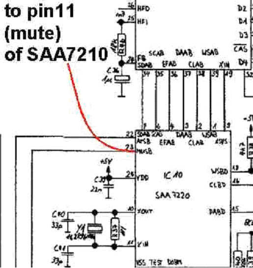

But... the muting function (in the SAA7220) has been bypassed and the CD-player will produce
pops and crackles when skipping tracks and when the music starts. To restore muting function
connect pin 23 of the SAA7220 to pin 11 of the SAA7210. Easy! I want to thank Ryan that first made
the no-oversampling modification, Carlo that first made the muting restore trick and Recce for technical help.

I know what you all mean but Tom wrote it plops at power on and power off..........
As said before, this mod was done by a company. I don't think they would forget to connect the muting line to SAA7210.
yeah, the pops are only at switch on and off. However, interestingly there are only two wires attached to the oversampling chip...
