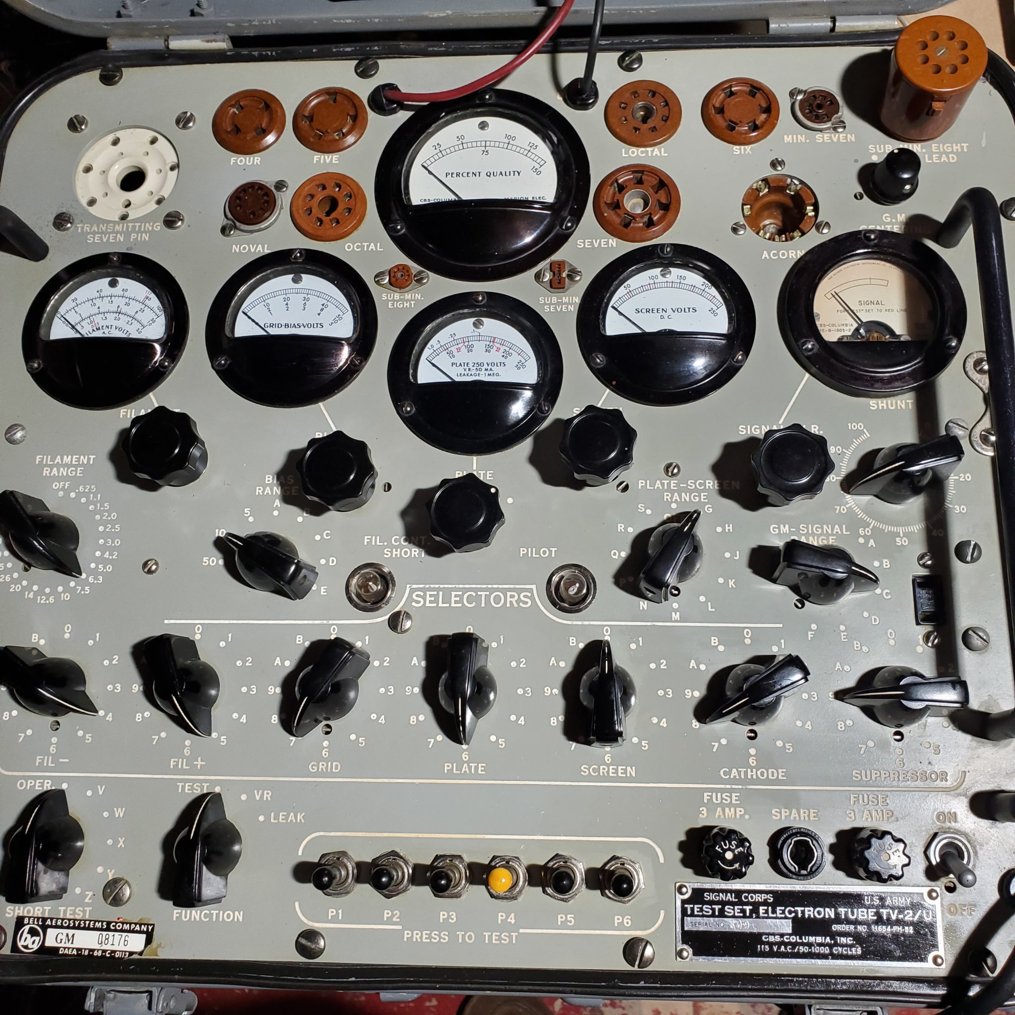

Well I have decided not to let a few scumbags and and scammers destroy my enjoyment of this hobby , figured sooner or later I will meet decent people in the field .. Anyway I took a deeper dive into the 800 and found that the English wheel seems to be causing most of the problems .. I removed the control and ran it in my ultrasonic cleaner for 20 min and it now seems to be working much better, was filled with a bunch of old dried out grease .. Also today purchased a calibrated Hickok YV-2 so I have something to give me a ball park idea of the accuracy of the Hickok 800.. Will have to do some reading on the TV-2 but it seems pretty straight forward to use .. The biggest complaint I here of the TV-2 is it's very slow to setup , No problem for me as I just do this as a hobby , I prefer accurate over fast for my needs .. pictures tomorrow ..
Here is the TV-2/U the only thing I can see that's missing is the spare fuse cap and the lenses for the Pilot and short bulbs , seems pretty straight forward to use , tested a few tubes and it seems to work very well .. spent a little time machining some new lenses for the bulbs , I'm sure I have one of those fuse caps someplace , don't really need it but it looks incomplete ..
