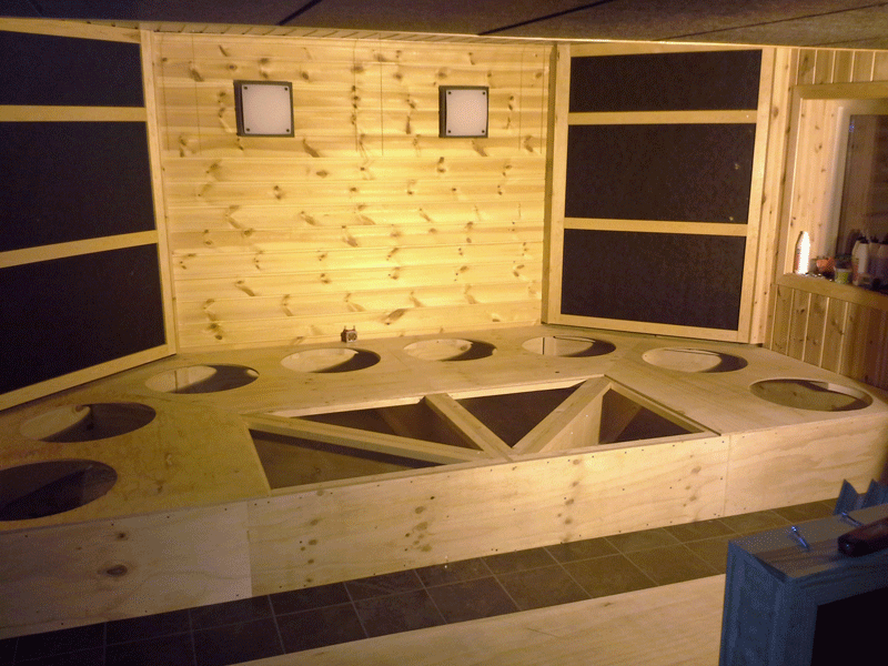

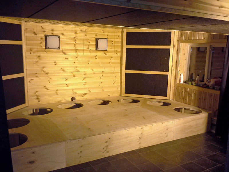

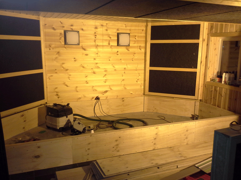

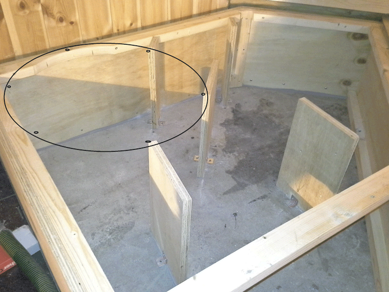

Some images from the construction of the sub
This is very impressive. I really like the internal shape of the "boxes".
Where in this beautiful country are you located? Do you accept visitors? 🙂
I feel like I'm crawling in the mud with my beyma 12br70 t-tqwt's compared to you. How did you plan your corner traps?
Thanks for the nice feedback
I come from Langesund, also called sunshine coast. Here are the doors always open for visitors
Area marked with yellow is completely filled with glava. The bottom (concrete) and all walls in the sub is covered with 50mm rockwool

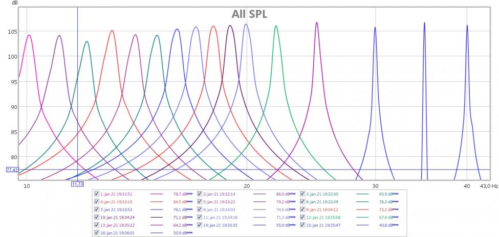

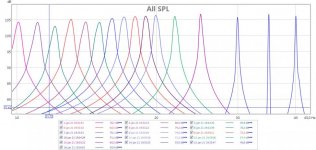

Have measured 10Hz-11Hz-12Hz-13Hz-14Hz-15Hz-16Hz-17hz-18Hz-19Hz-20hz-22hz-25Hz-30Hz-35Hz-40hz with the same volume.
Can probably say that this goes totally in the basement😀
Level within +/- 2 dB
Much respect for your build! Do you have the philosophy that the drivers form the throat part of à very large horn (the room), were you are listening in the mouth?

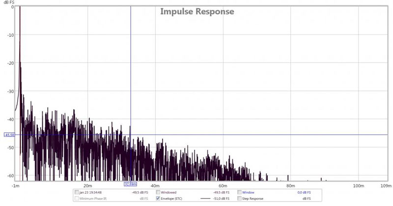

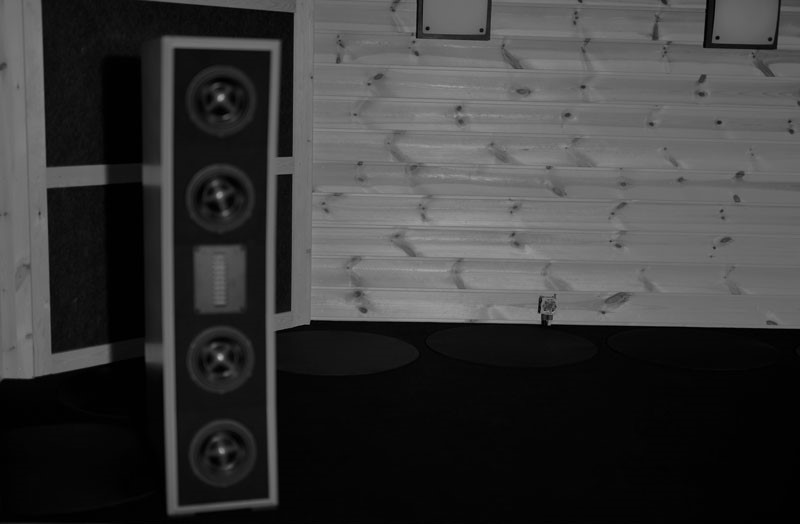

I have very good control of the first reflections in the room, maybe a little too good for someone opinion. I do not care, I like it that way

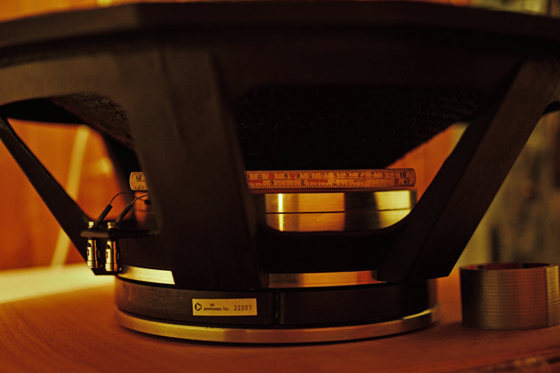

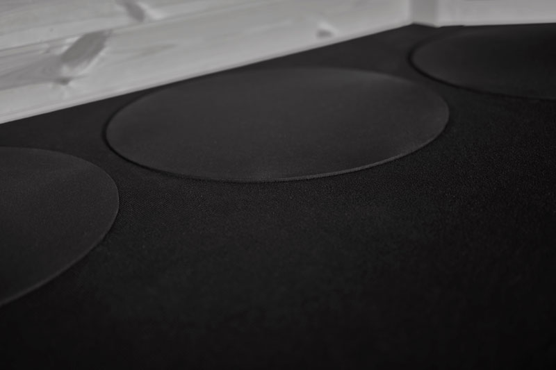

It turns out to be a long wait at the drivers from AE
Has almost completed the subwoofer
Then 6 pcs AE TD15M heading across the Atlantic Ocean
It will be interesting to complete the project.
