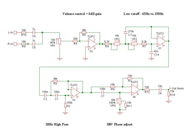

also I have this active sub filter(attachment) that someone posted here.
I would like to mod it so that the high pass cut off freq will be 17Hz and a Q of 0,7 and for the low pass have a freq of 50-150Hz.
Thanks in advance,

and for the active filter do you know what values i should change to acheve what i want?

I think you should leave the crossover like it is, it's very near to what you need. I'm sorry but I don't have enough knowledge to modify it.
