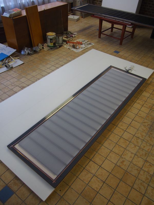

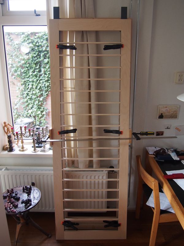

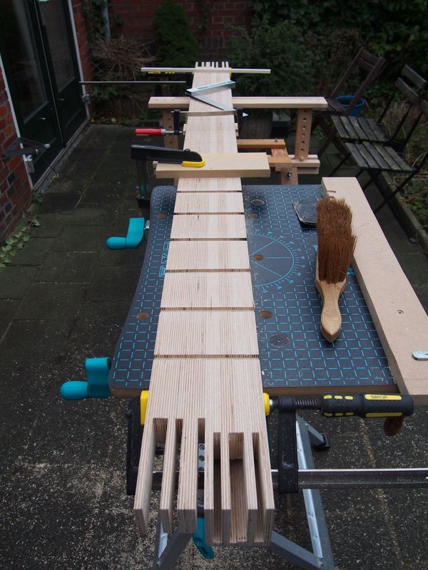

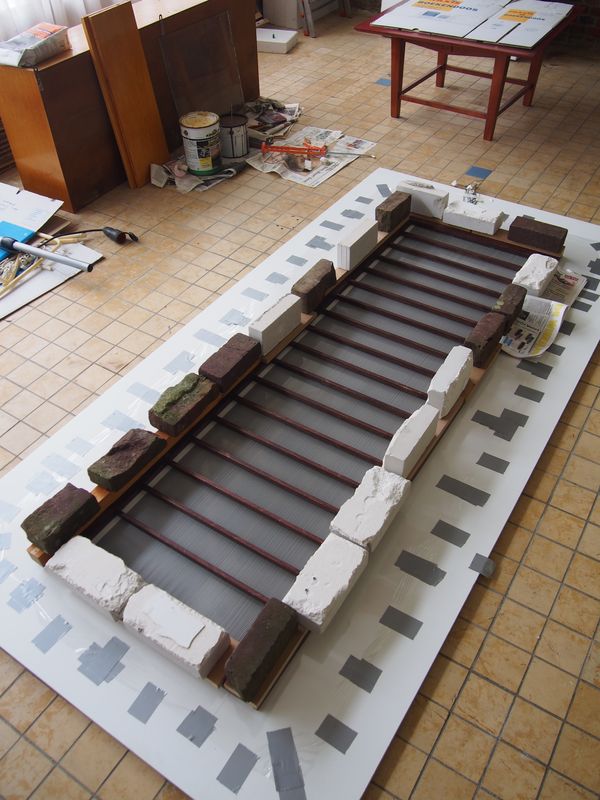

I almost finished my new electrostatic panels. Thanks to the help of several people at this forum I managed to get a good result. (I'm not sure what exaclty is good, but they seem to look and sound good to my own taste)
It took about eight months to (almost) finish them, 150 - 200 hours (rough guess). Especially the wood joints took lots of time.
I will post measurement pics in future. Unlike model #3, which has been in use for the last 3 years, this model has a resonance damping screen. The severe resonance of model #3 is reduced by about 8 dB. I didn't try the most difficult bass-intense cd I own, but all music that previously caused problems (heavy vibrations / resonance) in model #3 seem to play well in model #4!
At first I thought the mesh impaired mid / high sound quality, but after some initial listening tests I think the new model sounds better than the previous model. (tighter lf and because of different segmentation network better hf)

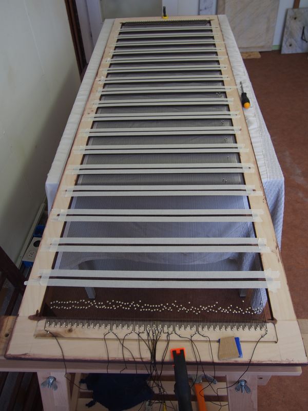

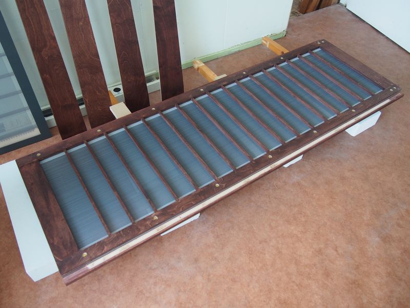

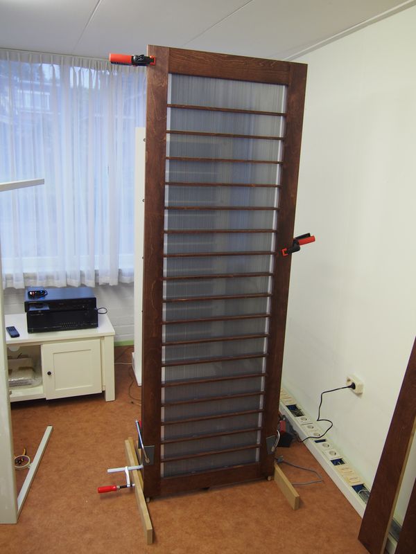

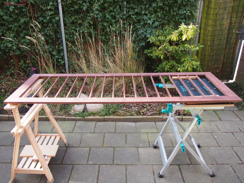

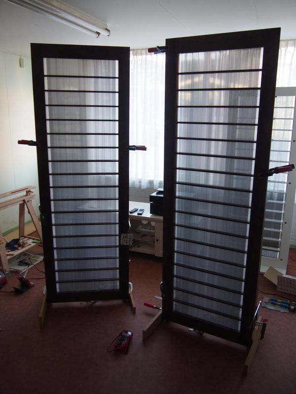

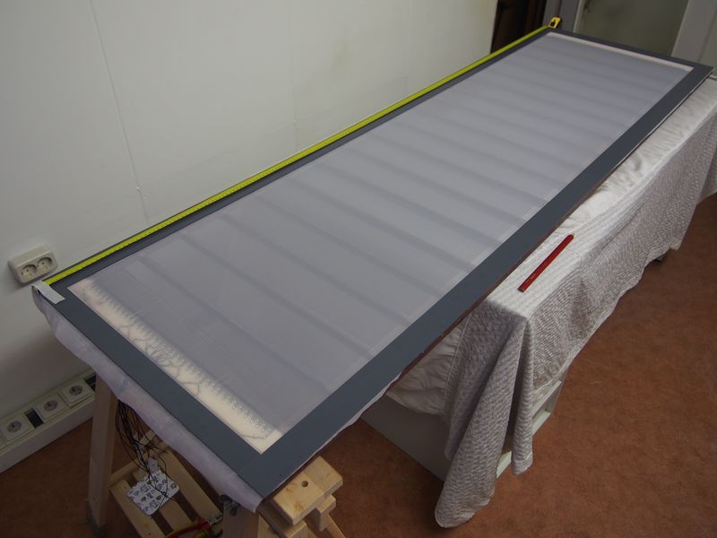

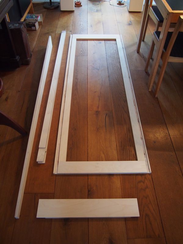

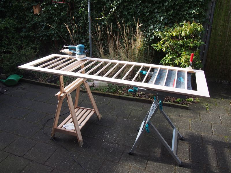

Here is a small selection of photographs I took during the building process. I hope that soon, when I have more time, I can add new photographs and measurements.
The panels are made of birch-multiplex, 18mm thick, outer dimensions are 68x200 cm.

Hi, I just replaced the externally hosted images with uploaded attachements from my starting post.

Hi, thanks for your kind replies!
About stretching the wires: I did it by hand. I just hammered 640 nails into the birch-plywood and used about 1200 meters of stranded wires. (1.1 mm diameter) The stretching itself was not that time consuming compared to the woodworking, but all the preparation and glueing took a lot of time.

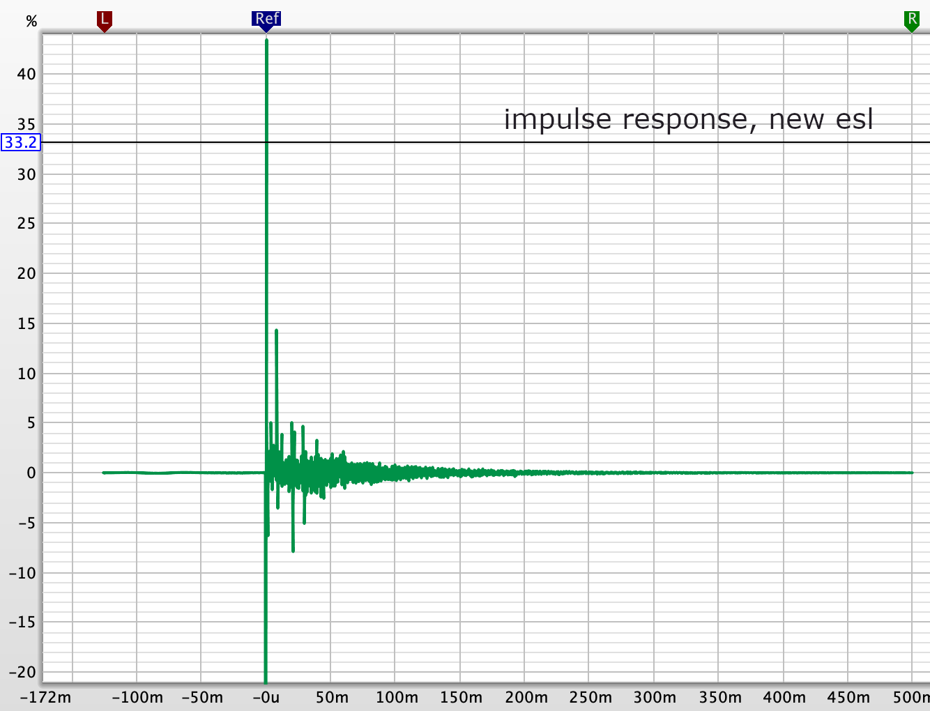

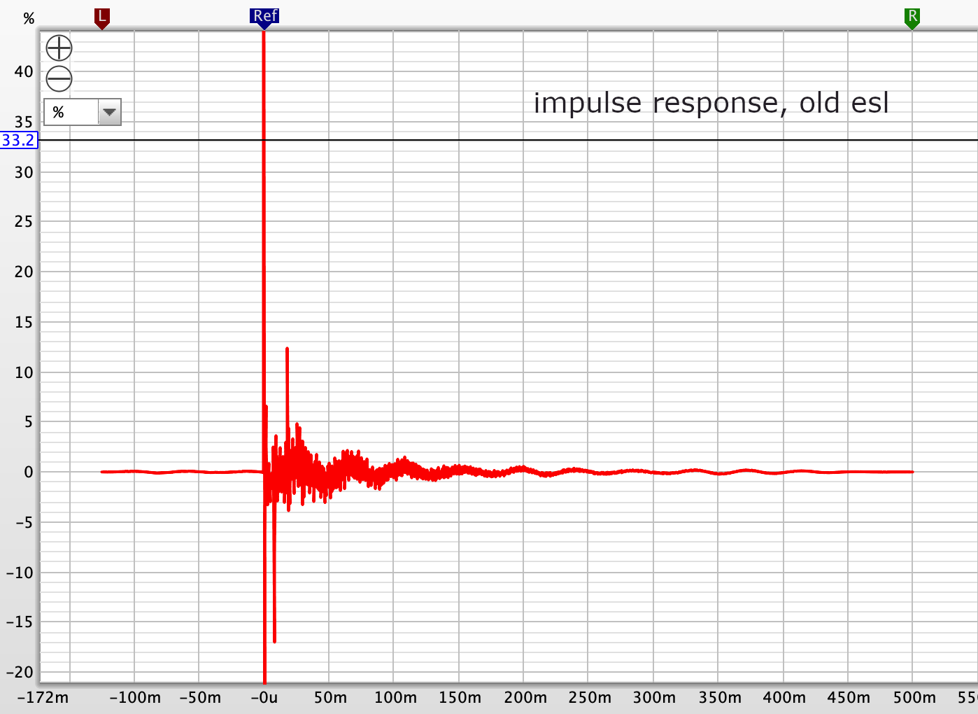

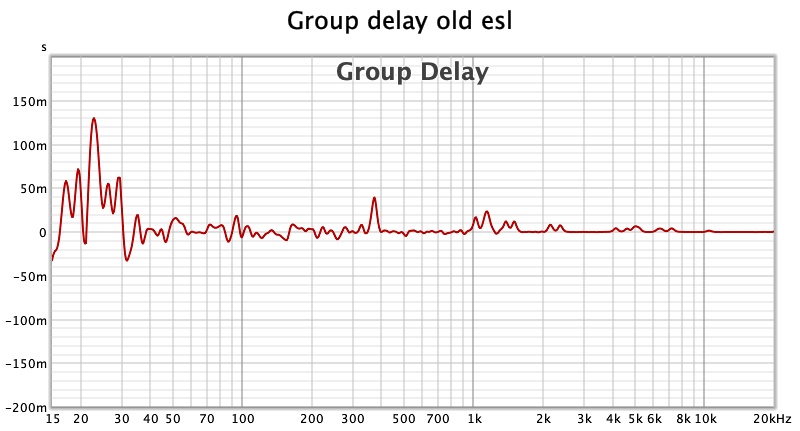

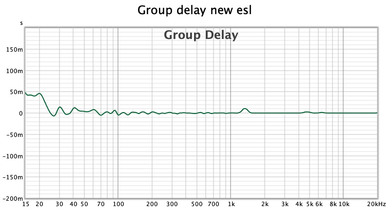

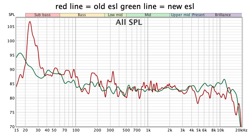

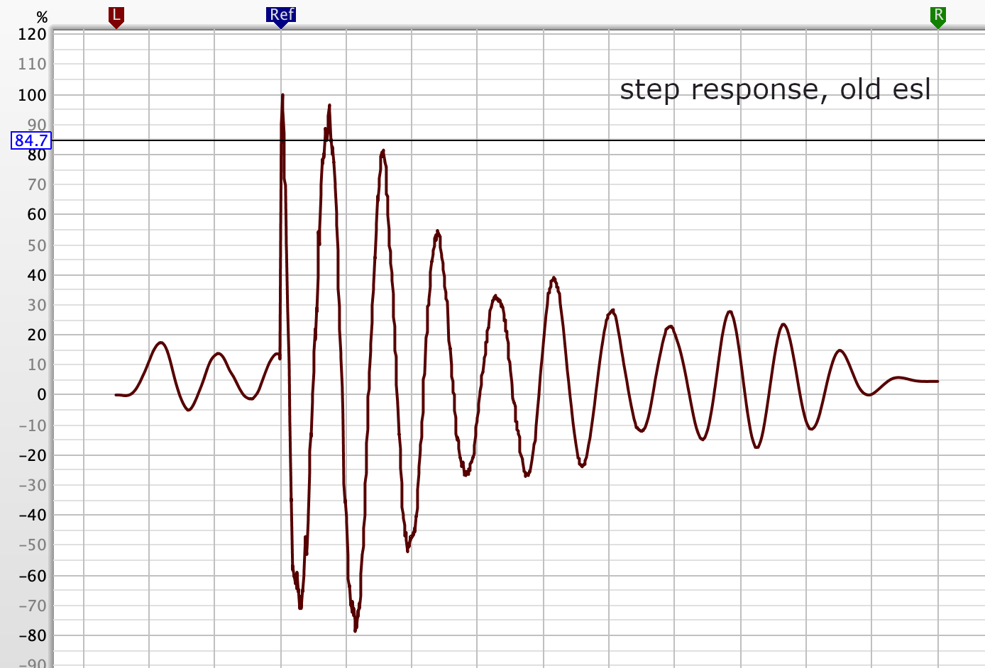

I made some initial measurements. My knowledge on this topic is still limited, so I'm not sure if the measurements do tell something and are usable. To limit room interferenece, I placed the microphone at 15 cm in front of the panels at a height of 108 cm. Room dimensions are about 6x3.5x2.5 meters.
I used a callibrated MiniDSP USB microphone. I included a frequency response, step response, impulse response and group delay response of both my previous (old) big esl panel, and of my new panel. The new panel uses a different segmentation filter to get a bit more hf extension.
The new panel uses a silk mesh damping screen which results in a better controlled lf resonance which is clearly audible. My subjective opinion is that lf sounds much cleaner and tighter compared to the previous (old) big panels that don't have damping screens.
Feedback on these measurements is welcome! I can post more measurement results if wanted like phase, distortion, waterfall...

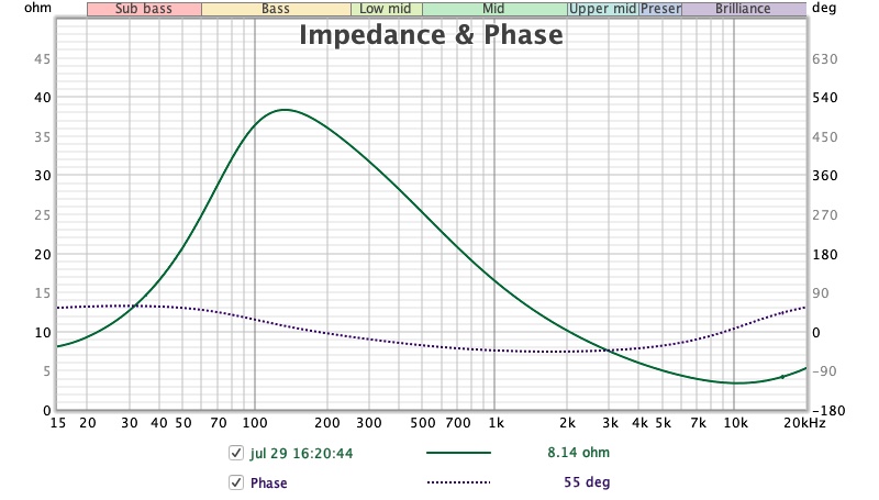

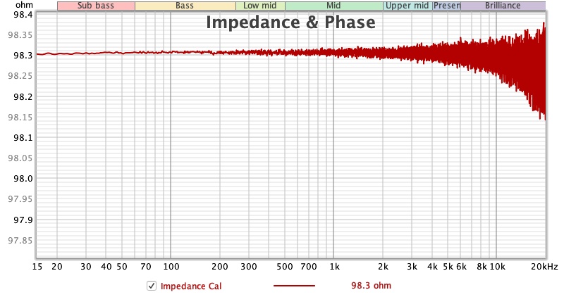

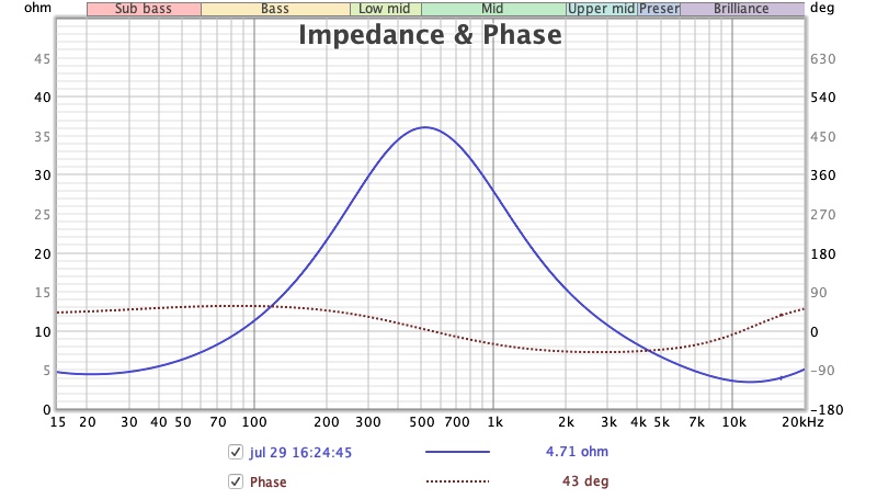

I just made some impedance measurements using an impedance measurement rig with a 100 ohms sense resistor and REW software and external usb soundcard. First image is the calibration plot, second and third one are the new esl panels, one of them has a temporary ladder network filte that combines the 3 middle segments to one segment.

Thanks for sharing your measurements. The new panel frequency response looks great, and the impulse/step response really highlight the improvement in resonance damping from the mesh screens. I’m glad to see you have finally gotten the results you were after…I know you have been wrestling with this resonance issue for a few years.
The impedance looks nice too, an easy load for amplifiers. The magnitude doesn’t dip too low and phase angle stays within about -45deg(ie not too capacitive) at higher frequencies where un-segmented panels cause sometimes case stability issues.

Hi Bolserst, thanks for your reply! Although I have one pair of AudioStatic 1:150 step-up (2x1:75) transformers for these new stats, I was thinking about ordering new ones at a local transformer builder. I can let them have custom specifications. Do you have any recommendations in order to getter performance from the audio transformers? For instance, would a lower step-up ratio (like 1:100 - 1:120) result in a higher LC resonance and therefore a higher hf-roll-off?

I managed to find a few recordings that make my new panels resonate...
It's a different sound than my previous (big) panels. The measurements show a clear improvement in Q, but I guess it's still not enough damping to get completely rid of the resonances. It it not that bad, but I would like to have a full-range esl that has no audible resonance at all.
