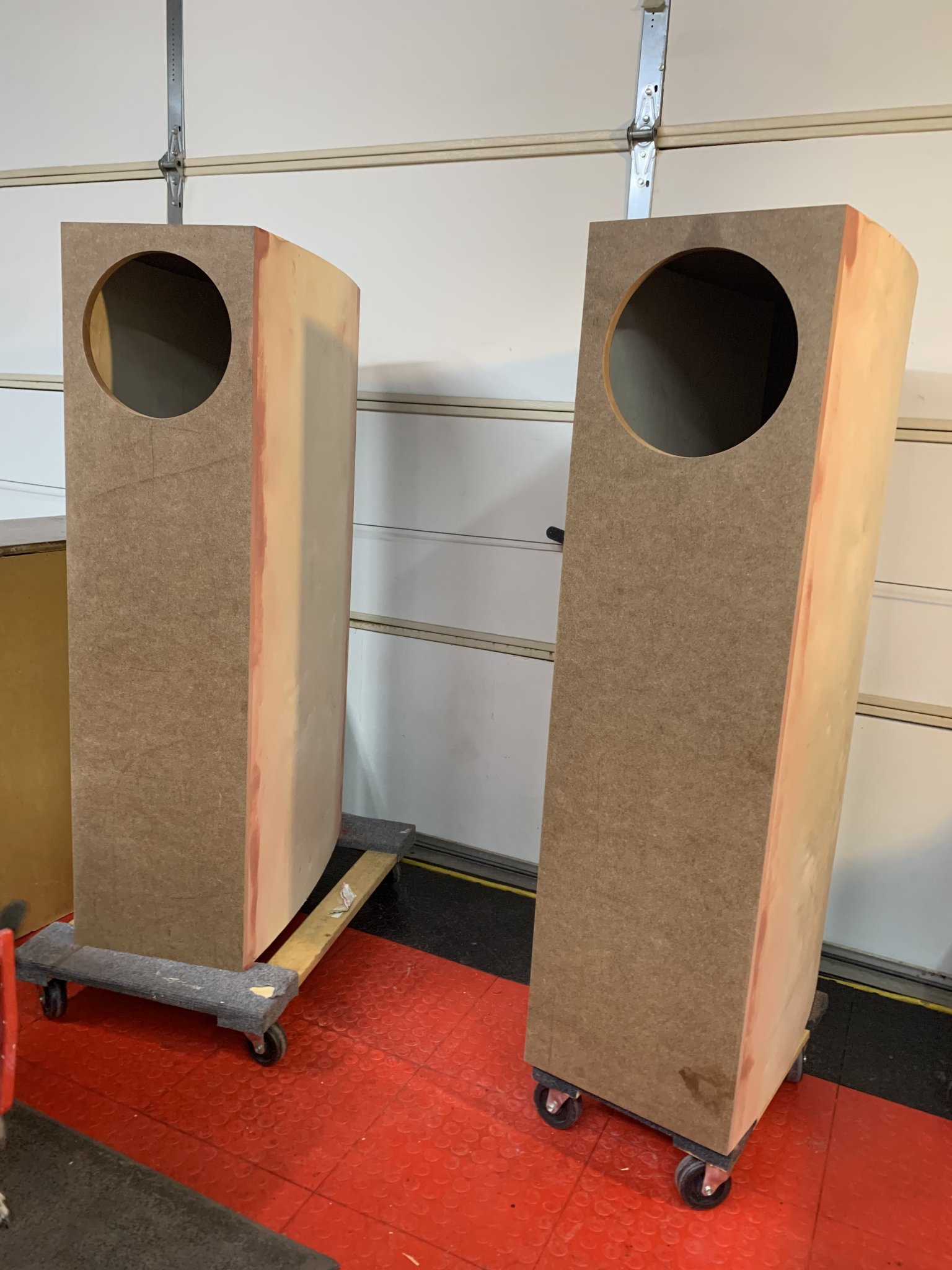

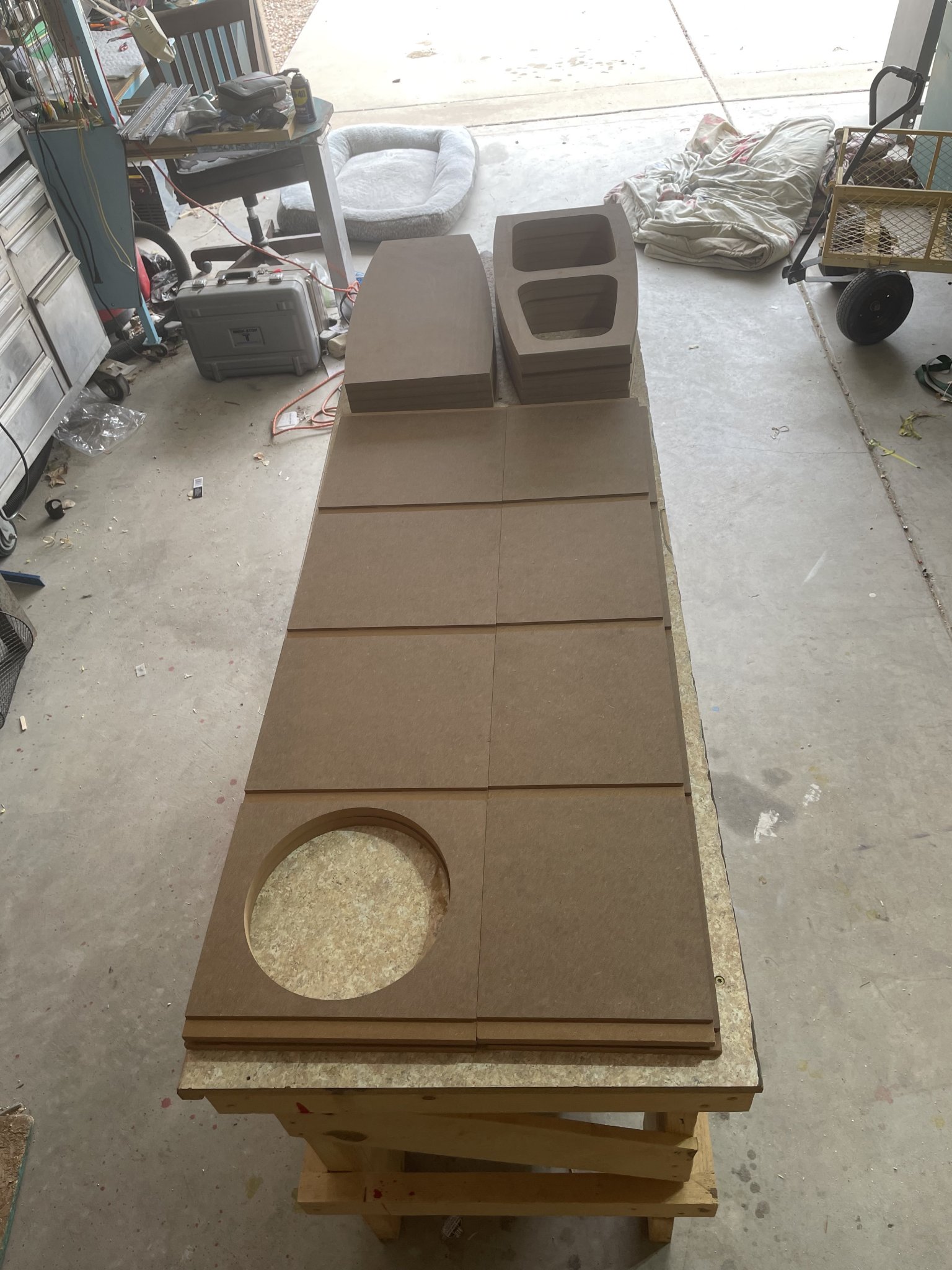

My new speakers build

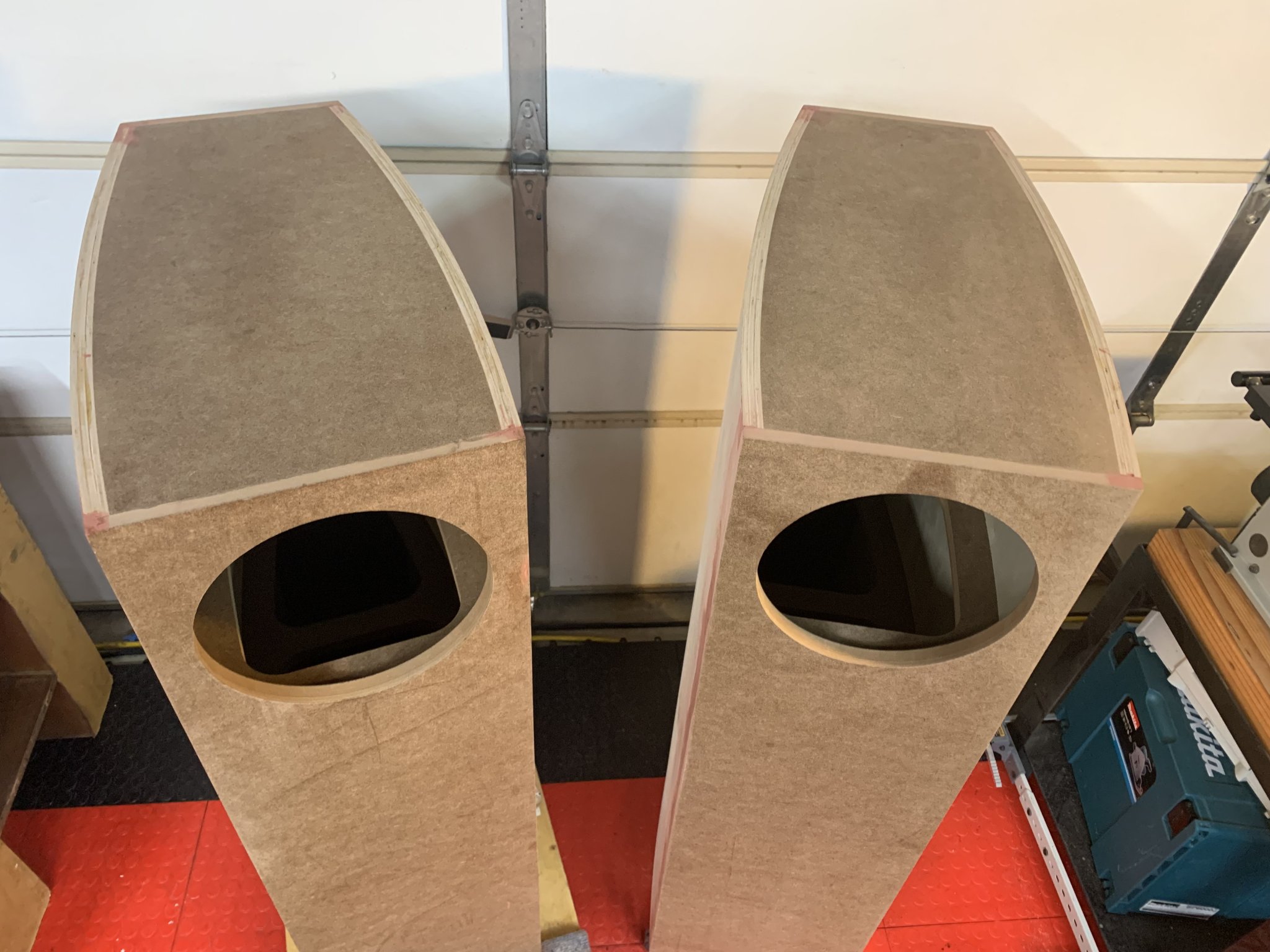

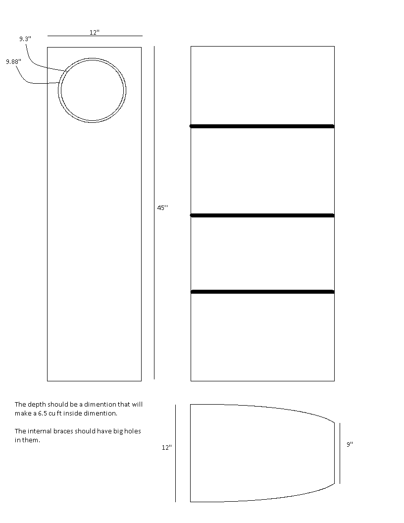

I have been struggling with placement of the vent pipe. I know I don’t want it on the front baffle but do I put it near the top behind the driver or down low near the floor? Any advice?
It is a tower so highest pressure is at the top and bottom.
So not too low and not to high so extra fill can be used
in the upper/lower " uh-oh" zones without the fill interfering
with the port. And also making the port not too far distance
from the speakers. So longer walls don't make the theoretical length
longer. Wouldn't over think it, either in the middle of one of the braces
line the cabinet walls with absorption material and little extra in the
upper/lower pressure zones.

What program do I use to simulate it?
You can use Hornresp, the "offset driver bass reflex model (OD)". It allows you to specify the driver and the port positions (3 segments, see pic). It allows you to check the tuning, port output, and combined outputs. The attached file is approximate cabinet size from your drawing, but I used a DS270, because I don't have your drivers T/S. Place the file in the Hornresp input directory, then use the import command. Lots of people here can help you drive it. Port placement has little effect on the tuning, but placing the port 30cm (12in) from the bottom gives the least "noise" on the combined output. Again, you should check the cabinet details I used and use your driver T/S details.

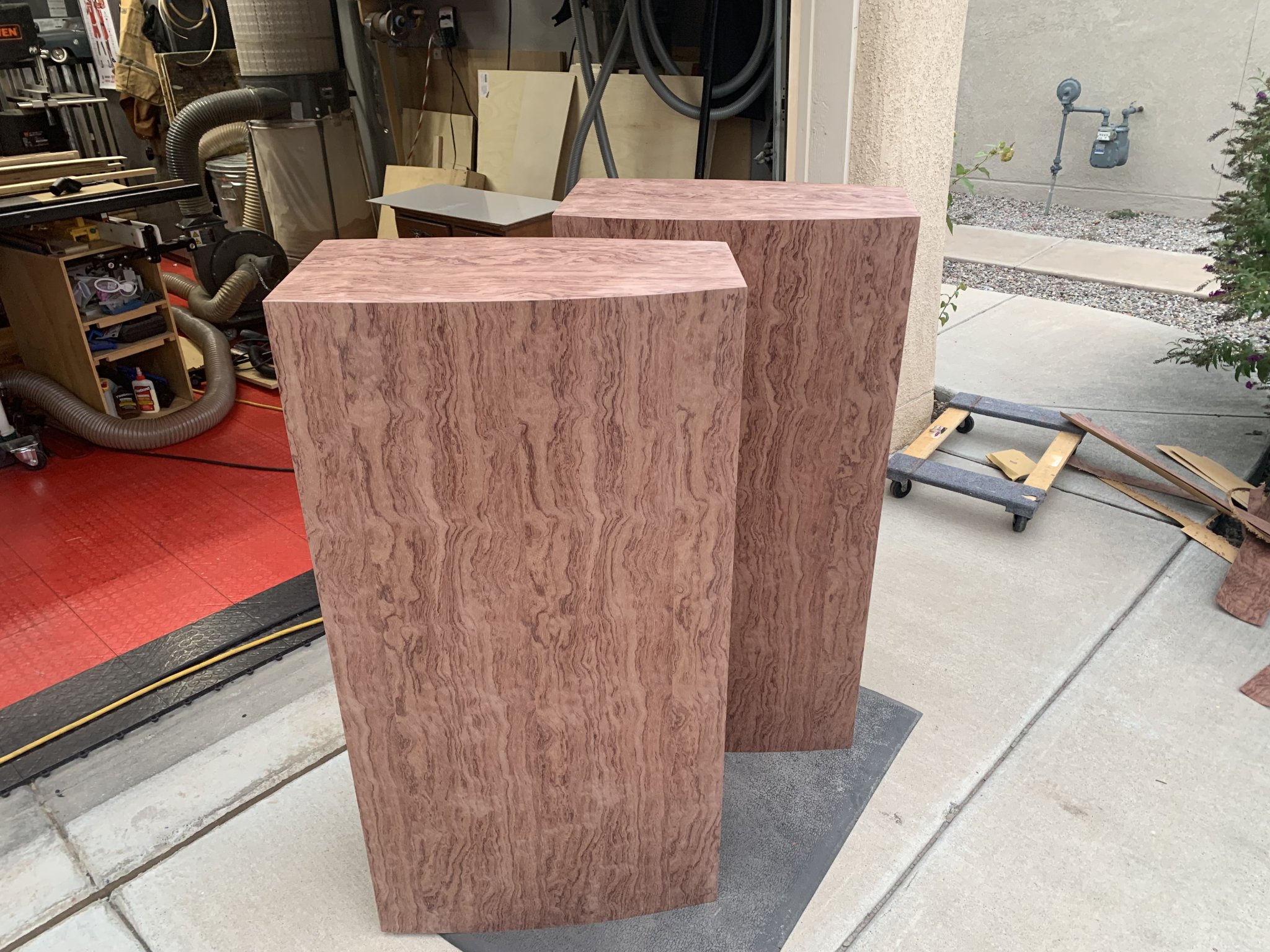

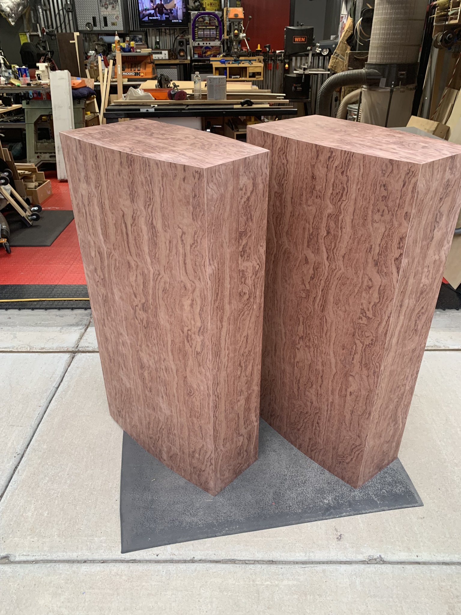

Beautiful boxes, nice build!
In order to minimize the risk of midrange leaking out through the port I would have put the port on the backside 5-7 inches from the bottom of the box. The reason would also be to maximize the floor boundary reinforcement of the bass.
I dont know how the crossovers for field coil drivers work but I think you will need baffle step compensation in about four to six db (which in reality means that you reduce the output above 600 - 800hz with the same nr). Since its a large full range driver you may need to stop the reduction in about 8k hz in order to augement the highest frequencies. Thereby you can experiment with toe-in of the speakers.
To reduce standing waves inside the box, I would have put some absorbing material in the bottom of the box. To reduce reflexions from the inside back wall and back through the cone (the driver looks as if its cone is made of paper) I would have put some absorbing material behind the driver.
if you put the inner port end near the center of the box you avoid the first box dimension resonance exiting the port, because interior enclosure dimension resonances (sometimes called "standing waves") have a velocity maximum and pressure minimum in the center. first box resonance has a wavelength of 2 x box dimension.

I absolutely love the name of the box, by the way!
