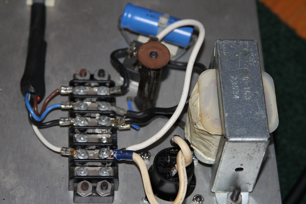

Servodrive used specially ordered motors with a higher resistance; the surplus servo motors are usually 0.9 ohms. But, you can use a 2:1 power transformer to convert that to 4 ohms. I went with the surplus motors, and use a big Hammond power transformer.
I think you may be right. There is what I thought was an iron core inductor on the back of the panel. It actually may be an autoformer. Like I said before, now that I have it tucked into place, it is virtually impossible for me to move by myself. I will try to move it when a friend is over to help and get some pics of the panel.

Actually, I was able to move the beast so that I could get the back panel off. The DC resistance of the wires going to the motor was 2.9 ohms. And that is an inductor since it has only two wires going to it and is in series with the motor. I am attaching a pic of the back panel. The black and white wires are the ones going to motor. The brown and blue ones are going to the fan motor. Again, I am stumped by why they used a series inductor, full wave rectifier, and a capacitor in the circuit because that motor is rated for 120VAC.
The cooling circuit was designed to make the fan run faster when more power was being used while still presenting a reasonable impedance, previous versions were not "amp friendly".

IIRC Danley said that the inductor was there to limit current into the servo motor as it would otherwise tear off belts and cone with time. The motor apparently had a little too good HF response and oompf and had to be tamed to prevent damage, or at least minimize it.
Indeed, he said the motor inductance was much lower than a moving-coil driver, and if you clipped the amp driving it the sharp corners in the waveform caused huge accelerations in the system which shredded the belts and cones. The inductor brought the bandwidth down to something more sensible.
The motor was a high-speed DC servomotor from Pacific Scientific, similar ones now cost thousands of dollars secondhand and can handle less power than modern cone drivers.
