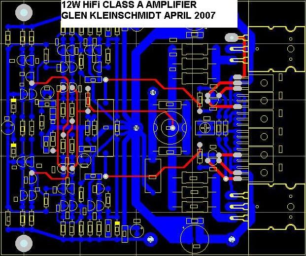

I was going to do this in my 12W design discussed here, but decided against it on grounds of complexity, as I only intended for this to be a relatively simple design. However, the compromise ‘Figure B’ circuit is a worthwhile improvement over the standard topology.
Boards are 80% complete 🙂
Glen
- My new mini Class A amp.
