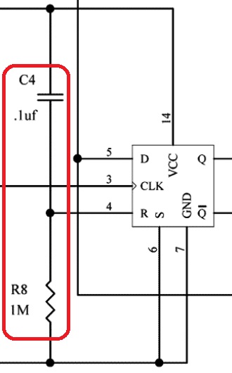

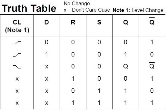

It's NOT a component failure. It's a design compromise, which can be rectified with 2 additional components and a considerable amount of mucking about.
The CMOS 4013 'Table of Truth' tells no lies!
If Set and Reset are tied together @ GND potential, which function wins on power up?
Flip a coin...
Reset (U1 pin 10) needs to win!
(The required components were installed on the Valhalla).
Alternatively, pressing the 'Start' button once or twice will resolve the issue.

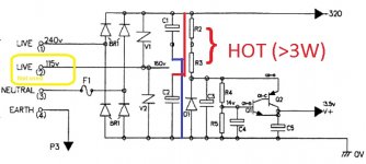

If you leave the AXIS connected to mains power in standby mode (LEDs extinguished) and experience a mains power interruption, the AXIS may start spinning when power is restored.
The obvious solution is to disconnect it from mains power when not in use. It prevents the electrolytics from drying-out and prevents unnecessary scorching of the PCB under R2 & R3 (R2 & R3 dissipate >1.5W continuously when connected to the mains).
Don't forget to replace C19 - when it fails (short - as tants do...), the AXIS goes into cardiac arrest.
If you don't require the voltage doubler, you can vastly reduce ripple on the +320V rail by using >350V rated capacitors (C1 & C2) across the rails. F1 may have to be uprated.
