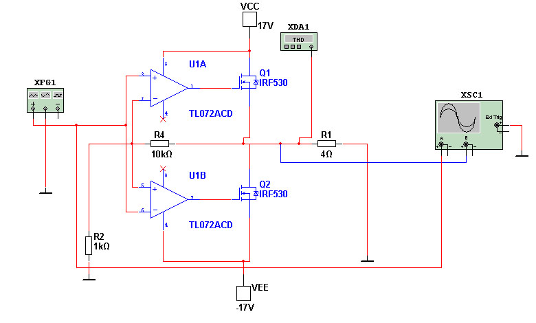

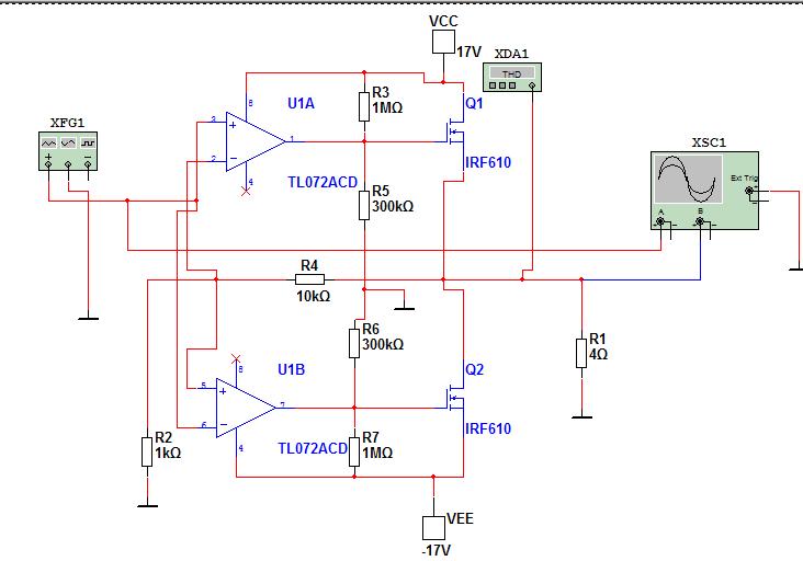

My new idea application,only use two same irf610 to building amp,This prevents different components due to process differences caused by different,hope someone give me some advice,^_^

Did you simulated it and the currents through 610's are correct?

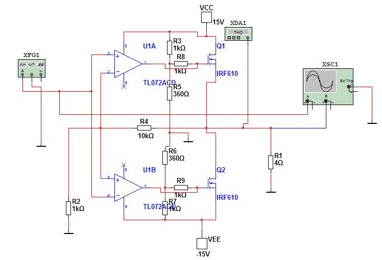

Thans your encouragement,but I thought this can improve,focus on bias resistor,

add gate stoppers ~100 ohm

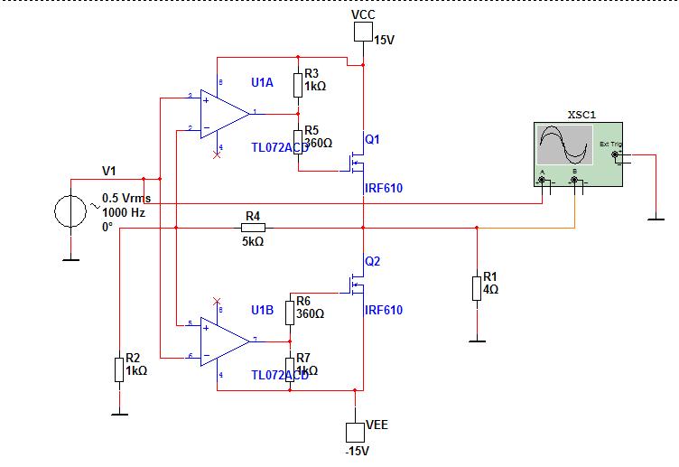

Interesting approach. It seems to be a simplefield version of this topology (post #1):![]()
This is an improved version of my,How did people feel interested in this circuit, Oh!
http://www.diyaudio.com/forums/soli...h-pull-pull-like-gamnut-whats-right-name.html
check out also this thread:
http://www.diyaudio.com/forums/solid-state/66334-gamut-d200-clone.html
perhaps there are any advices to additional improove your topology.

I've been looking for a N-Channel using only a simple circuit, I see that you provide a little complicated, if it simpler, the design of my simulation is correct, but the actual application of a problem
- My new idea TL072+2 irf610
