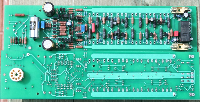

I'm over the first test. Not yet listening, just some measurements. Ther will be some major, and minor issues, I have to solve. The DC offset is is liitle higher than I expected, and the adjustment is not possible. So I have to replace the trimmer, to get wider range for the offset compensation.
Another issue is the stability. The amplifier oscillate if I put more than 1uF capacitor across the 8ohm dummy load. There are some ringing on the square wave output with 1uF. So I have to replace the compensation network.
The output is little over 400W/4ohms.

There was some different version, to listen, and test. What I found, that the KSC/KSA series transistors have not as good sound as the 2SC/2SA types. I have changed the protection little bit.
The solid state buffer finally based on Marantz SM11-S1, but with more output devices, and approx. 150W/8ohm output power.
Some pictures attached.

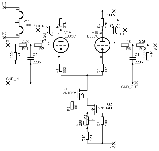

The input stage will be E88CC two half connected parallel, common cathode.
Expected output power 140W/8ohm, 220W/4ohm, 400W/2ohm (simulated). Option is the bridging to drive my 4ohm subs (2xBeyma 18G550 bassreflex).

So I planned another driver stage, which is under construction. It contains E88CC long tailed, with cascoded DN2540 as ccs at the tail.
So it will be truly balanced amplifier input, to output.

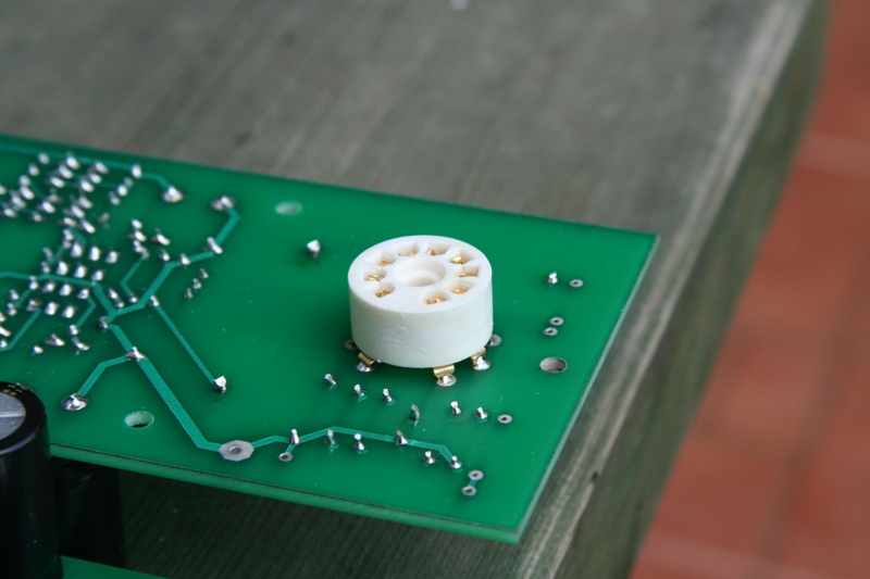

The input pcbs are arrived today. I planned another one which will contains the 3 drivers, due I don't want to destroy the existing pcbs.
I will put some pictures about the heatsink assembly, hopefully on next week.
