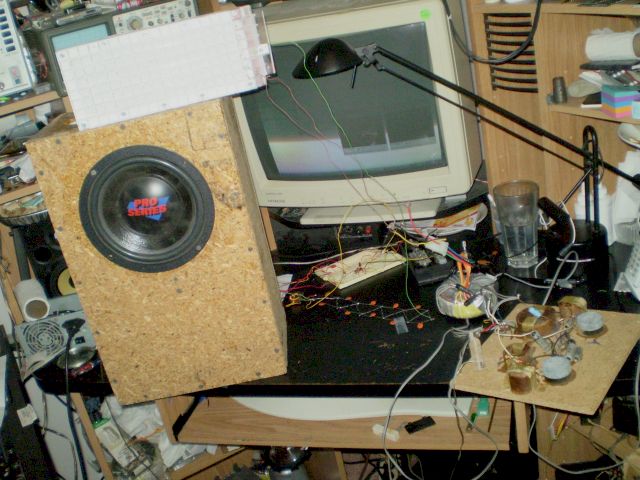

here is my very first esl i built 7 years agothat I just got running today. i'm in the process of rebuilding my bigger panels now that i can properly drive them. jer
