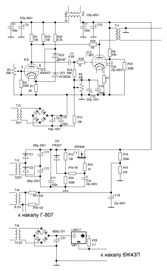

This is my new SE with GU50. Idea is "stolen" from Wavebourn. I tried 6J9P and 6J49P as input tube and I found that 6J49P sound better. I got 12W.
amp:

I simulated your circuit a little. I had to use 6j9p as a voltage amplifier because I do not have 6j49p spice model, but those two are similar tubes, basically.
I got as follows:
- Open loop gain (no 110k feedback resistor) = 34,2 dB
- Closed loop gain = 25,2 dB-----> NFB = 9 dB
- Pmax = 13 W @ THD = 9,6 %
- THD = 3,1 % @ 2 W
- Zout = 4,7 ohms.
- Quiescent current of GU-50 = 70 mA, Ig2 = 5 mA.
Are these close to your results ?
my resultsv (I have only multimter and osciloscope):
- Closed loop gain = 25,2 dB-----> NFB = 9 dB Yes, around 24dB
- Pmax = 13 W @ THD = 9,6 % I Got around 20V PP on 8Ohm before clipping (I belive that is around 12W)
- THD = 3,1 % @ 2 W (I can not measure that)
- Zout = 4,7 ohms. (I can not measure that)
- Quiescent current of GU-50 = 70 mA, Ig2 = 5 mA. On cathode I got 66mA
Can you make simulation with B+ 550V and 60mA on cathode? What power can I expected and what THD?
When the anode voltage of GU50 is 550 V, then 470 ohms cathode resistor gives some 60 mA cathode current.
Power is increased a lot but distortion increases too.
The anode impedance should be higher than 3k5 if 550 V supply voltage is used.
Some results:
Uin Pout THD
0.35Vrms 4.7 W 7.5 %
0.64Vrms 14,3 W 13,3 %
0.78Vrms 20.2 W 15.5 %
20 Vpp across 8 ohms is only some 6.2 W.

THD looks "a little high". What about if I take (I have them) C3G at B+ 390V, G2=150V, plate voltage 220V and red LED bias? I do not have skills to use LTspice. Artosalo - could you send me your LTspice simulation on mail?
Distortion comes from the output stage, not from voltage amplifier.
So using C3G instead of 6J9P or 6J49P changes nothing.
I think the original supply voltage (390 V) is guite optimal with your 3k5 transformer.
If you want to get better distortion readings, why don't you use global NFB ?
What do you want to be simulated ?

Now thy this version:
1. Shunt cathode resistors
2. Decrease value of feedback resistor.
3. Increase output transformer ratio
4. Try 6J52P instead
No, not in terms of optimal output powerI think the original supply voltage (390 V) is guite optimal with your 3k5 transformer.
The cathode current of his amplifier is 66mA @ plate voltage of 390V (Cathode Voltage assumed as ground, OPT-DC-loss and Screen Current neglected)
The nearest ideal OPT value (for a Pentode) in that specific operation point would be 390V/66mA = 5.9k
With 3.5k, the triangle below the load line is a lot smaller and so is the output power. Furthermore the distortion will rise
With your OPT (3.5K) you will get most power out with the following U and I:
P=U^2/R ; P=I^2*R ; with Pa-max=40W this yields:
374V and 106mA
and a theoretical output power of nearly 20W 😎

Higher load impedance will reduce distortion essentially, but since the thread started with already built amplifier I assumed the transformer will not be first component to be changed.

I have a pair of 10K:8 OPT. I have also one power trany 350V AC (around 450V DC I belive). This amp is still prototype. I will also try 6J52P and D3A. All this tubes I have. Thx to everyone.
1. I did on output tubes - should I do that on 6J49P too?
2. I did to 110K. Should I try something arounf 70K
3. I will try 10K
4. I will try.
The point is, to decrease distortions of an output stage and decrease it's output resistance you first use higher load resistance to trade off voltage swing for less distortions, shunt it's cathode resistor decreasing feedback by current, then increase feedback by voltage decreasing value of resistor. If resulting amplification factor is too low shunt driver's cathode resistor, or/and use a tube with higher transconductance.
