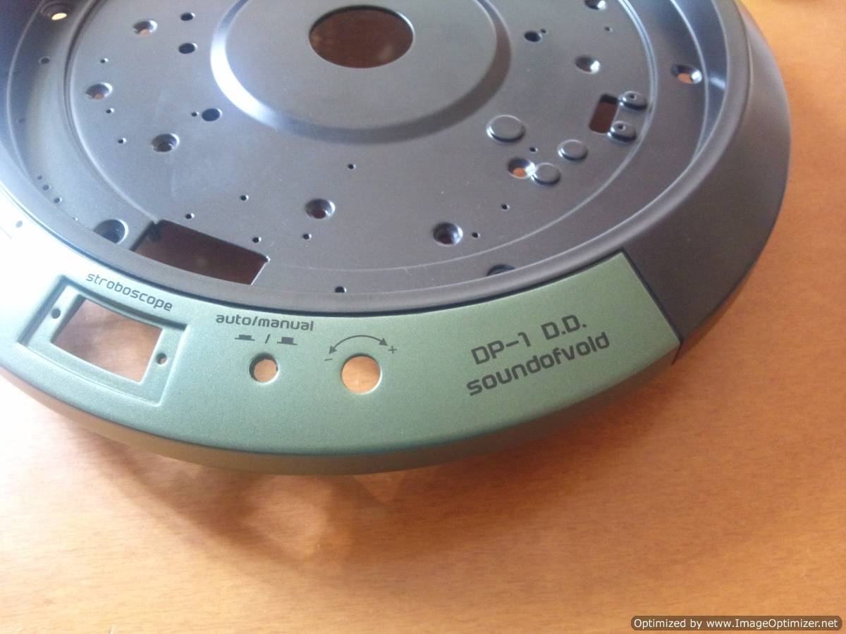

Your project is very inspiring, thanks for sharing.
From following this thread I have got the feeling that you miss feedback on your posts. I have resisted commenting so far, to not clutter the thread with a fan-post with no relevant technical or design feedback. Because those +1 and "Great" posts are really annoying when you subscribe to a lot of threads. I think a lot of other members act the same. Your thread is one of those threads where I actually miss a function like the Facebook "Like". Anyway, you can be sure that there are thousands of DIYers who have read and been awed by your efforts.
Regarding the lettering, to be up to the standards of the rest of the project, my view is that the line of letters should be following the diameter of the chassis. At least whith your rather large letters it looks a little awkward with the different texts following their separate baselines.
As to printing on metal, a friend of mine has such a printer which he used to print on mostly flat surfaces. If I recall correctly he had some software where he could compensate for angled surfaces and also to print along the perimeter of a circle.

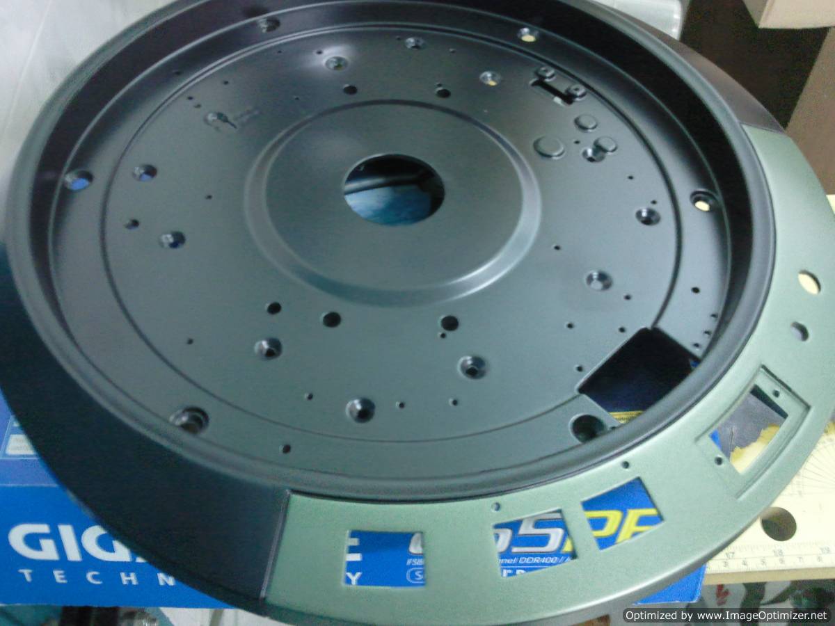

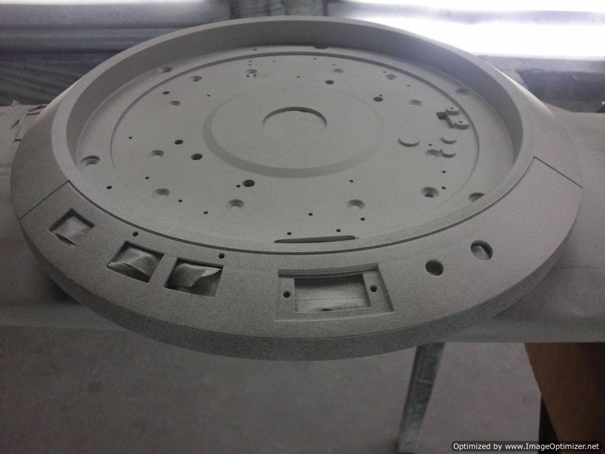

I do know that the printing is not as perfect as it should be.
I chose letters just one mm bigger than original in order to show the difference in the letter styling (that i like very much).
And because in preparation i filled up a line that was casted just above the
buttons now i had much more space and the old lettering looked too small.
What they did was printing the letters in three stages (left -center-right) trying to follow the roundness of the chassis.
That is three times printing and three times "baking" the paint in an oven to harden it.
I will not go this road again.
I 've come to understand that for almost everything i ask from others to do
their understanding of the word "perfect" is different from mine.
But unfortunately i cannot do it all by myself!
I will use CNC engraving from now on...IF i keep using the original top part.

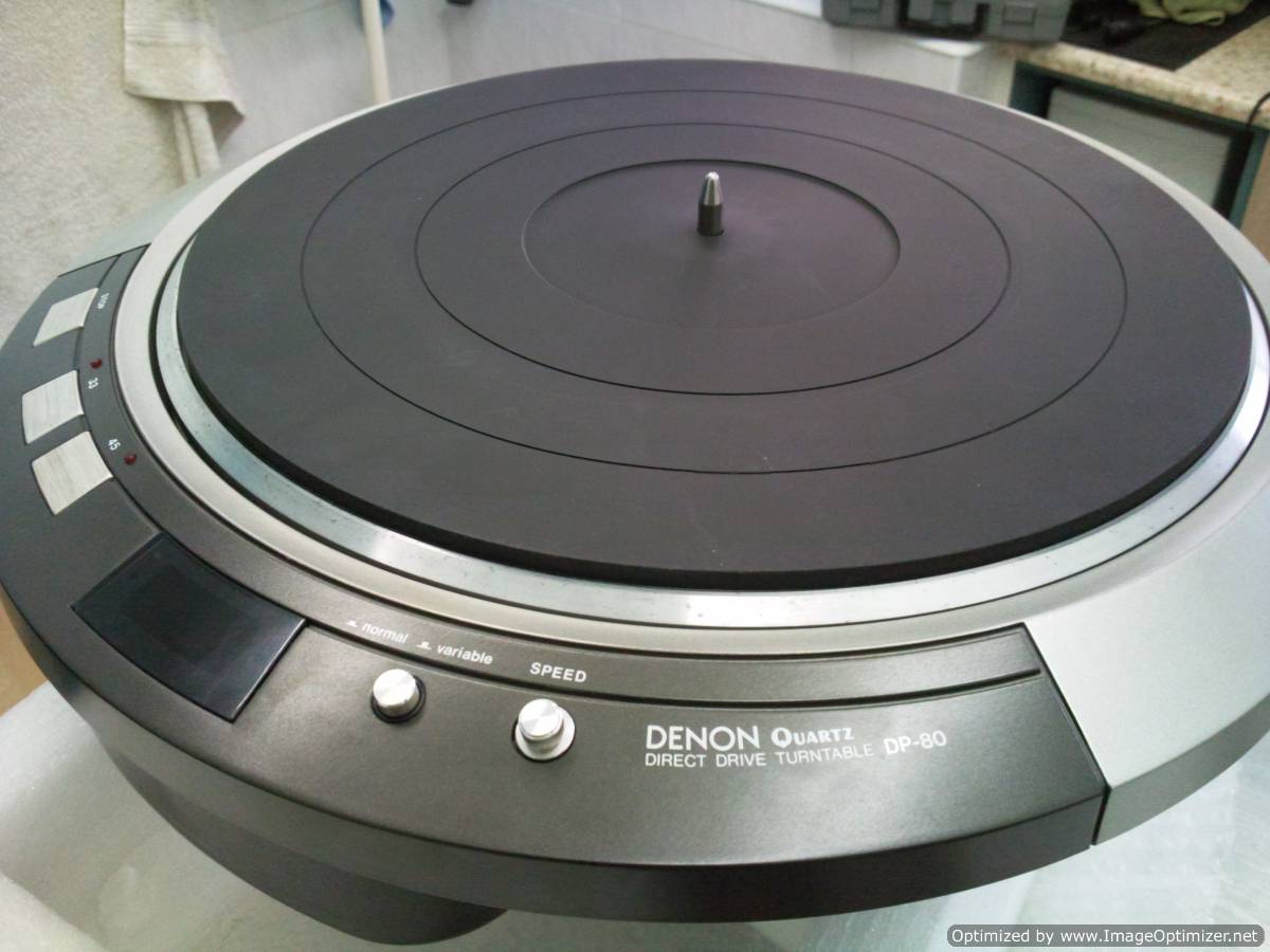

If the problem with controls/sync persists i am thinking about moving all buttons on the power supply, meaning i will have to cut me another top part.
Difficult, but with one stroke i will be able to solve many problems regarding appearance, damping properties and final presentation.
From the whole DP then i will keep just the motor and the lower platter.
All the rest will be my doing.

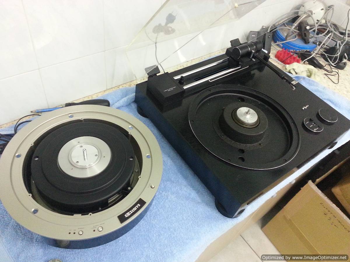

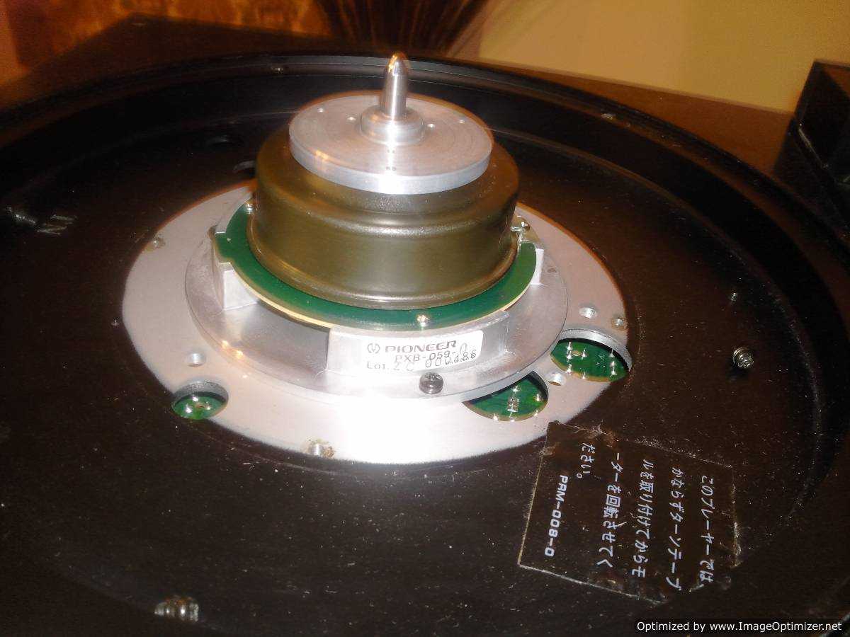

Both are "Japanese only" products.

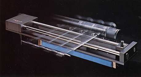

The Darth Vader is the PL-L1 that has an exquisite parallel tracking mechanism
that works without gears belts or strings...just with magnetic induction!
It's the big daddy of the PL-L1000...only executed in true high end spirit.

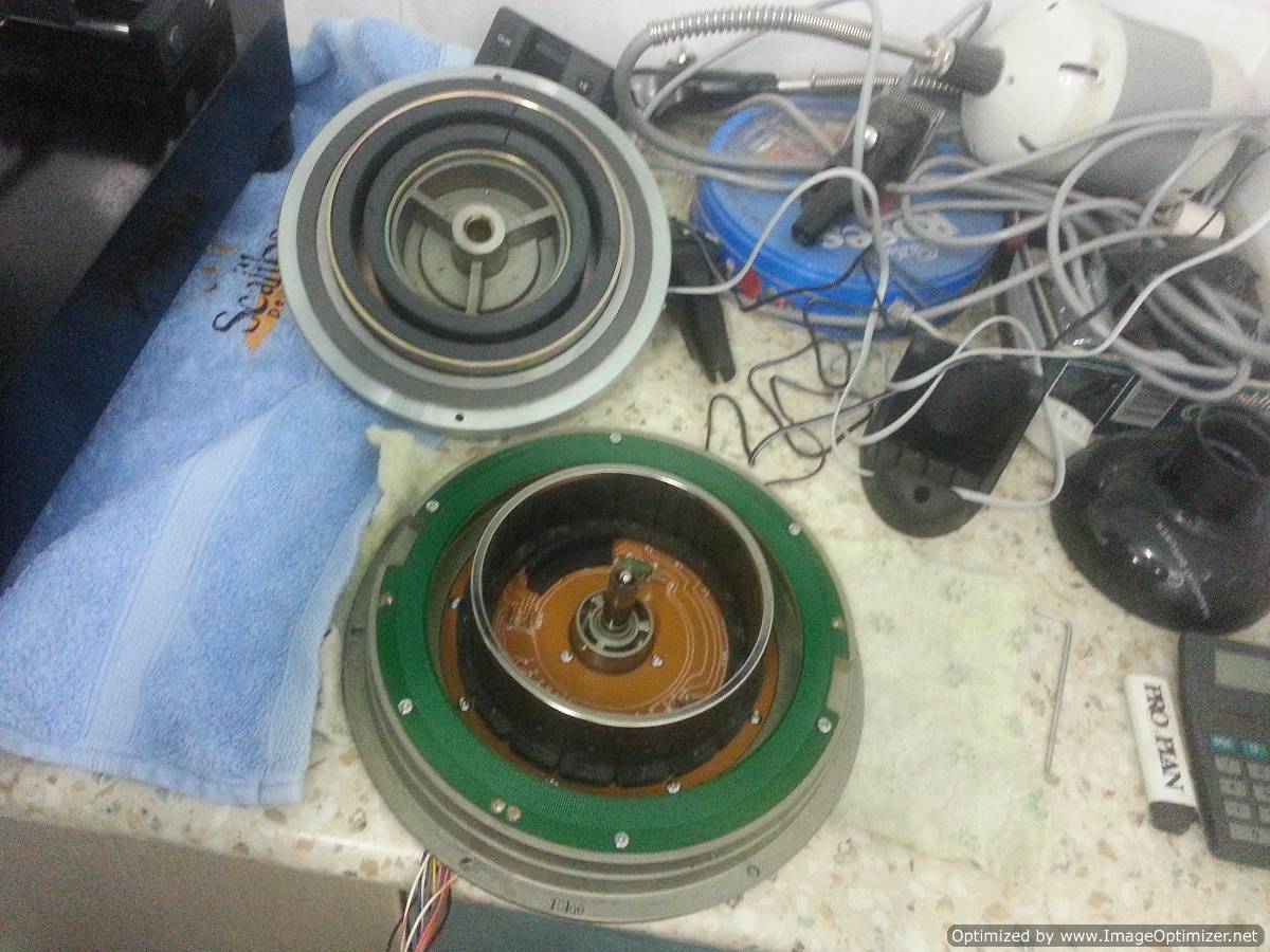

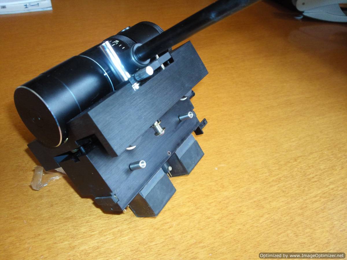

The other part is a stand alone (no arm-like the DP-80) transport with the motor and platter of the legendary P-3.
Ripping the arm and relative mechanisms from the PL-L1 and attaching them to the rest (in the same type of construction that i use here) plus magnetically levitating the new extra heavy platter has been a fixation to me for a couple years...
The motor is monumental.You can see the two motors in comparison in the 4rth picture.The central black part in the transport is corresponding to the little protruding part in the center of the PL-L1!
It can move mountains.

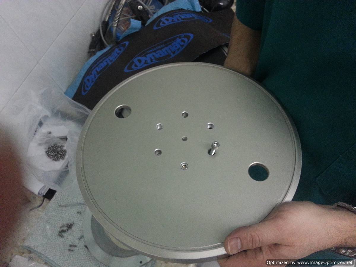

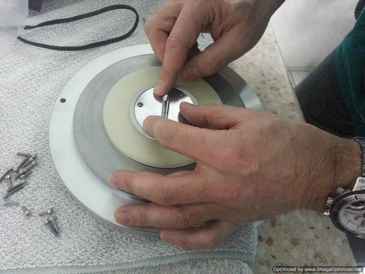

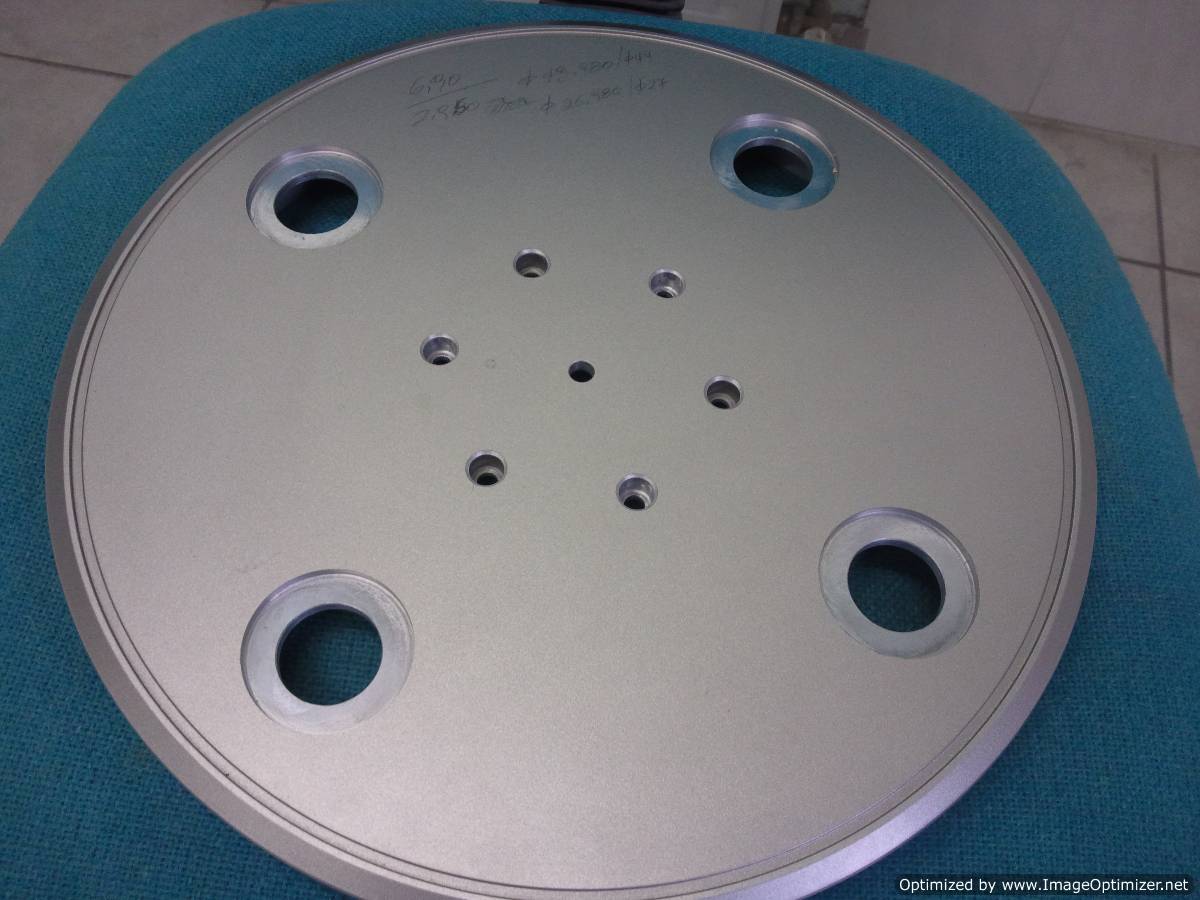

I have designed the new platter (a mix of the old aluminium one and a new bronze part-about 15 kilos in total), the placing and carriers for the opposing magnets (i have custom ordered the N45 magnets-13.5 kilos opposing power),
i have prepped the old platter to accept the new parts and have done a study about the damping materials and where to use them...
The main chassis will be a derivative of the one used here and i need to
make a big chassis to place the arm and it's bits and bolts.
But i need a multiple "me" to tackle all these at the same time...

I feel that the Stable Hanging Rotor motors in the Pioneer/Exclusive turntables to be the most advanced direct drive motors ever made by the Japanese. I would suggest that you consider a panzerholz plinth for the Pioneer P10 motor.
My experiments with cup and ball horizontal isolation in combination with mag-lev have ascertained that the cup and balls need to be arranged equidistant from the center of mass and that the mag-lev footers are best used in a circular arrangement with the load in the exact center(again, with regard to the c-o-m).
The performance of a high quality direct drive/cup and ball/mag-lev collaboration is a tour de force.

Yesterday was a sad day.
In no way, with any type of cable in my disposal
was i able to make it work properly.
At best i could still feel (more than hear) a slight cogging in the motor like it was constantly hunting for the absolute sync.
At 45 it was almost perfect but at 33 it was long from acceptable.
I can't live with acceptable.
On to a new power supply and the return of some boards inside.
I have already made my orders...
This does not mean that i am abandoning my plan to make it happen.
I may need to revise the boards but i will get there...on my own time and on my test mule.
