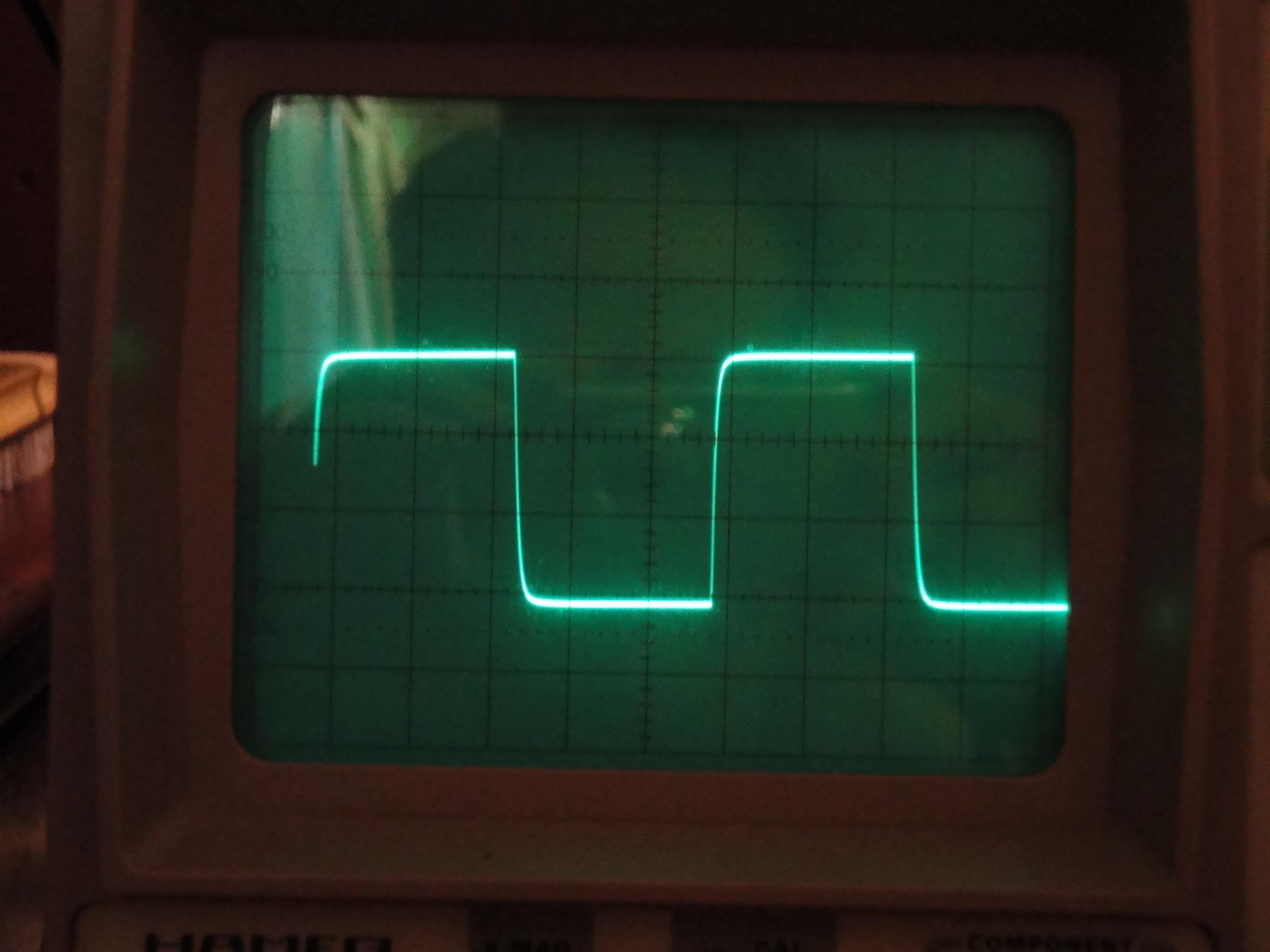

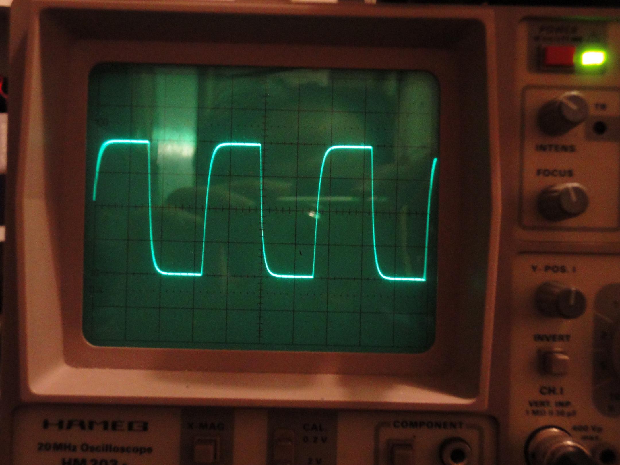

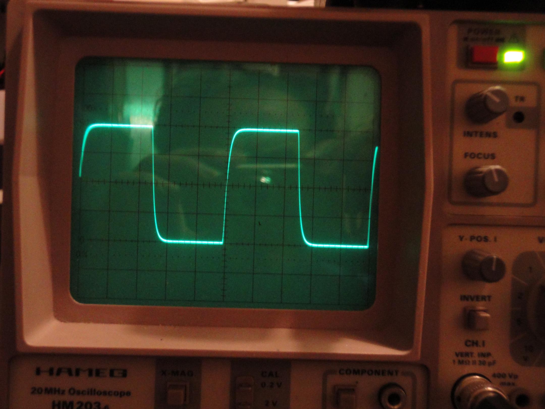

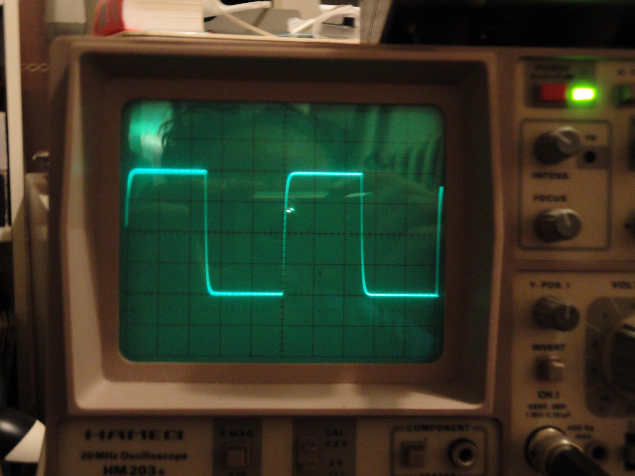

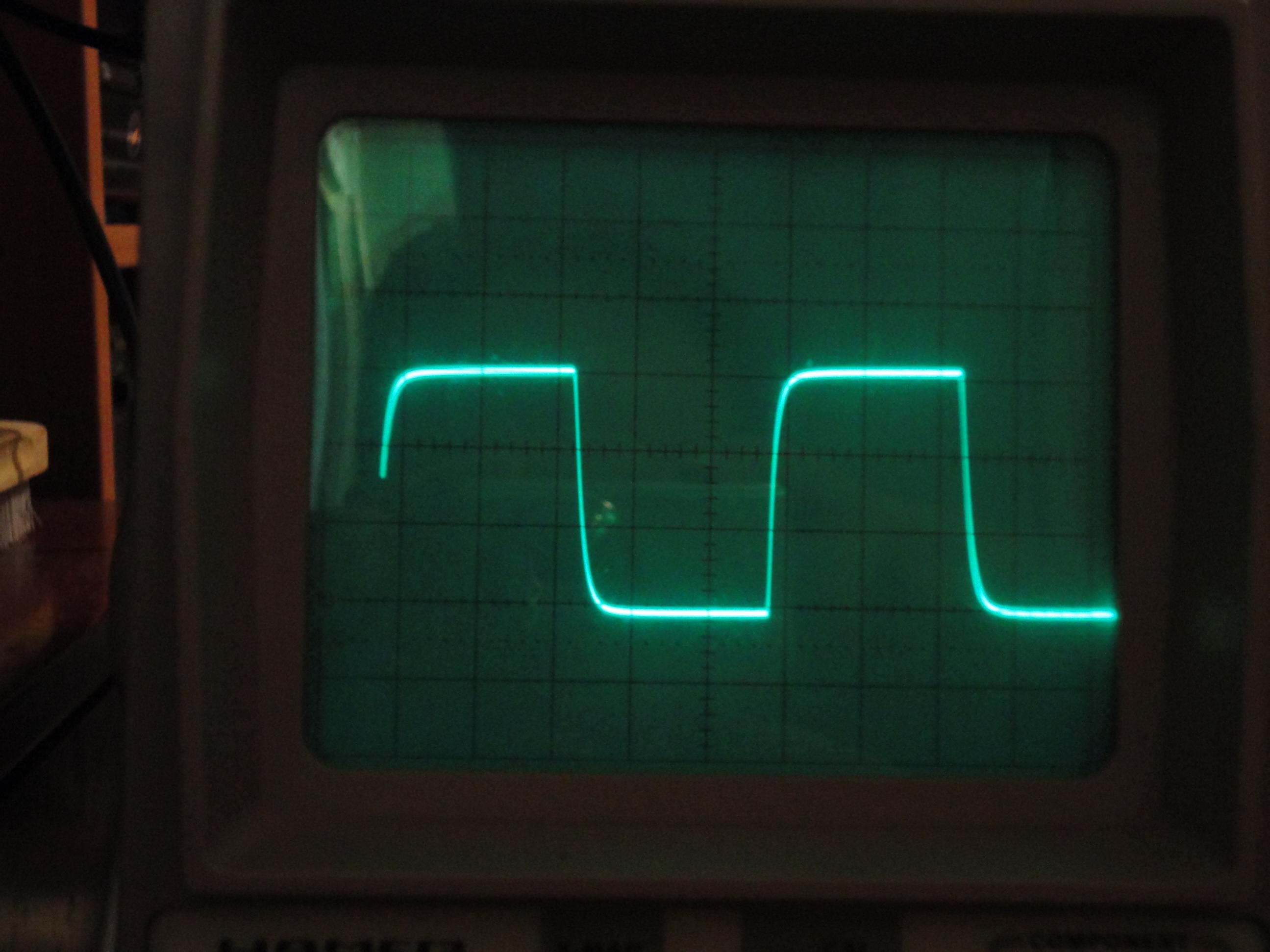

In last Sunday i finished the two channels of the amp , i have a little hum on the right channel but yesterday i solve the proplem , it was one PCC85 noisy tube , and i remove it . The sound is more clean , with better bass and better high frequency and more detailed than that of the Futterman topology and it sounds more powerfull , but i think this has to do not only with the differences in topology - schematics but with usage of better components , like better quality power supply capacitors , ultra fast soft recovery Hexfred diodes , special quality EI power transformers , and better designed differential stages to minimize harmonic distrotion . The -3db point in high frequency is at 170 Khz , I will make more measurements the next days , I will keep you in touch ,Thanks .
I measure 35 Vp-p with 1Khz sine wave into 8Ω load before the amp start cliping , wich means around 20 W , well its not too powerful because the PL36 is triode connected , but it sounds very nice , and maby in the future I will make some modifications . The output impedance (measured at 10 Vp-p into 8Ω load ) is 1,6 Ω . What do you think guys about these measuraments ?.

20W at clipping seems like there might be a problem somewhere- I would expect more power with that many tubes.
What is the B+ voltage of the power tubes? Have you looked at the amp with an oscilloscope to see how the driver circuits behave when the amp is clipping?
