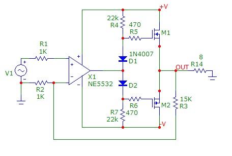

Nico Ras said:Disconnect op-amp output from junction between R2 and R3, only connect op=amp output to junction of emitters Q2 and Q4. Now change values of R1 and R4 to 470 ohms to lower quescient current to some reasonable value say 400 mA. Now clipping is symmetrical.
I am not sure why you want to bias the output in class A if the driver is class B, you already have cross-over distortion present from the op-amp, class A output stage is not going to make this go away.
Rather run in class AB with lower quescient current, why heat up the environment if this does not have any positive effect.
I will give it a try tonight. The idea is to bias both opamp and output stage in class A when operating in class A (I don't know if this will make any improvement in audio quality since my heatsinks really don't encourage class A bias).
Anyways distortion from the opamp is much lower than distortion from output stage and does not happen at exactly the same point since voltage and current are not in phase.
I thank any advise since i'm rather new to discrete output stages. Since i'm planning to buy some audio mosfets, has anyone listened to various of them and can give some recommendations (some are really expensive!)?

This sounds well? I remember doing one with zeners and resistors and the results were anything but nice.
Are you using the same mosfets than me? If this has 100x the distortion of the driver its a killer amp.

ionomolo said:This sounds well? I remember doing one with zeners and resistors and the results were anything but nice.
You are basically increasing the current drive of the op-amp. Mosfets work nice because they do not need high current to drive it and the op-amp driving them should be fine. Simulation indicates that THD improves although this is unlikely.
I never made one, only quickly simulated this a moment ago to see, just try it, you have all the components at hand anyway and it should work without any problem.

Theoretically my design does not increase current drive of the opamp if both current sources are balanced and current-source loading should give great power supply rejection, but yours is so incredibly simple that it seems it's not worth the improovement.
Any reason why opamp-driven output stages are not more popular among the diy community? I know that 12W it's not much but opamp rolling is really cool and 50W bridged matches the more common gainclone design.

I've realized i was using 47K resistor instead of the 20 stated on the schematic. Probably higher nfb will also lower the distortion and change sonics.
