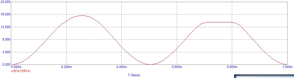

I will give it a try tomorrow. One thing that really favours LM4562 in front of dedicated drivers is that you can try your schematics in protoboard before building a soldered prototype.
Now it's really cold here and this thing sounds better. It may seem a very subjectivistic approach but bias current is cut in half (170 mA vs 80). I think that gm doubling distortion is worse with these mosfets than pure crossover.

There's also a thing that bothers me about the LM4562. When I push it, say above 1 or 2 Vrms the sound changes dramatically from warm to extremely analytical.
I don't know if it changes to better or worse but it's easy noticeable. Looking at the distortion plots from the datasheet it seems it behaves better when pushed, but i'm not enthusiastic about the clinical sound of it at high volumes and having a volume point where the sound changes it's coloration it's quite annoying.
Somebody has experimented with it? (It also affects headphone amplifiers and other things i've done with this ic)

ionomolo said:There's also a thing that bothers me about the LM4562. When I push it, say above 1 or 2 Vrms the sound changes dramatically from warm to extremely analytical.
It is because the circuit clips non-symmetrically, what you are hearing is odd order harmonics which sounds clinical, and cold.
Nico
Thanks, i'm using non-symmetrical supplies (17-18.5). I'll work a bit arround it. I also prefer analytical sound since it's much easier to color the sound in the preamp stage (Yeah, tubes). I like the word gainclone because I want a chipamp that clones the signal with gain : ). But what i feel from the LM4562 is some sort of ultrasonic fog that surrounds everything and this might not be a clean sound but rather an IM product.
This afternoon I'll bias it into class A to see what happens. I will also try to keep both supplies as matched as possible.
