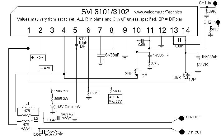

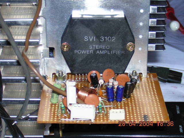

well I *FINALLY* got around to actually making my 1st Amp module in years
its a Technics SVI 3102 (2x 50W new class A Amplifier
i was given a SONY FH-B150 midi stereo and decided to add a little magic - i hope to see others use such a good ic in their upcomings - SVI has a COMPLIMENTARY SYMMETRY output stage - min ext components int. overload det. thump/dethump uses Technics synchro-bias - runs MINT (read no osc / not hot / no distortion) not bad for a 1st attempt - id like to be able to make a good PCB layout for this - tho i have no idea of PCB artwork etc - ill post soon the exact schematic i used - but heres a pic of the fully operating amp pic

AC IN
The AC in is utilized for the Thump/Dethump/Overload Det. RESET-
this will give a 4 sec delay before sound ON - nil thump off / if overload detected, AC must be switched off & on again for overload det. to reset
