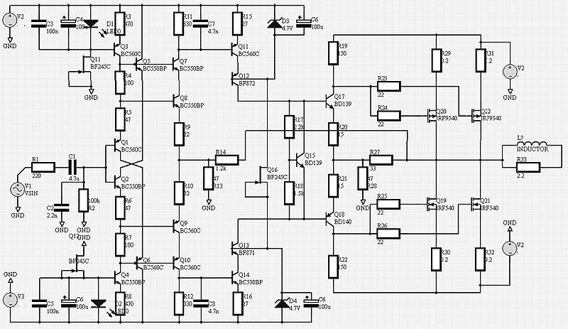

my new amp (comments?)
hi
I'm new here . It's my first post 😀.
I want to build amp for my bass unit (bi amp with push-pull ultralinear EL34 for treble/mid). It will have 100-150W. I post schematic (sorry for quality). Any comments, new ideas? (don't laugh to loud🙂 ).
It look like amp form Elektor (autor Giesberts). I made only few changes (especially in the input stage).
"Pre" section will have regulated voltage.
Bias maybe about 200mA
I think about 4 things:
-2 amps/channel (XLR inputs, balanced) would be nice ?
-2, not 4 transistors/channel (especially when balanced)
-different type of output stage (next post)
-different type of driver stage (cascode with constant power, like input stage)
Lenny

I just took a quick look, so I may be in error, but a couple of things I have noted:
1. Your use of AC coupling on the input but not the output. Why not use a fully DC coupled design?
2. I see only a pure resistive feedback network. You should use a capacitor to roll off the high frequency response.
3. You might also wish to use a capacitor in the main feedback loop to reduce the DC gain to 1 (highly recommended in DC coupled amplifiers).
4. Your driving the FETs from a common emitter configuration seems like a bad way to go. I would recommend driving them from emitter followers - with 150 collector resistance like you have, I would think the transient performance would be poor.
Hope this helps.
Jeff R.

Thank you for comments.
Yes, that's Protel 🙂 Protel SE form their www page (trial version 😉 ).
I forgot to mention that DC offset wil be done with DC Servo, so maybe this capacitor in input is realy bad idea.
Hi frequency behaviour is depended on C7, C8. I hope this is enough. Correct me if I'm wrong. I'm litle worry about oscilations, because I don't have osciloscope.
Ohmmm....
Meybe you could change first&second stages to one j-fet stage.
You could take a voltage gain and very good input bufer ( it have really high input imedance ). It is a possibility to connetc NFB with the current mode.
There is a great amount of negative feedback in last two stages, I,m affraid it could oscilate.
You have to design a system to prevent volage peaks, because Hexfets could burn to death. Maybe a capacitor across bias stabiliser, meybe zener diodes or system that slowly raises PSU voltages.

I have seen small capacitor
across R27, 33 ohm
in this type of output stage with a voltage gain
Also is good, maybe nessesary,
with a separate Power Supply for the output stage
for Current Feedback Amps.
They are more sensitive for such feedback.
This is already done here.

Hi Lenny
I once performed simulations on a circuit that was a little similar to yours.
The main difference is that mine is inverting and it's input stage is a little simpler than yours. The simulation results looked promising.
http://www.diyaudio.com/forums/showthread.php?threadid=7058

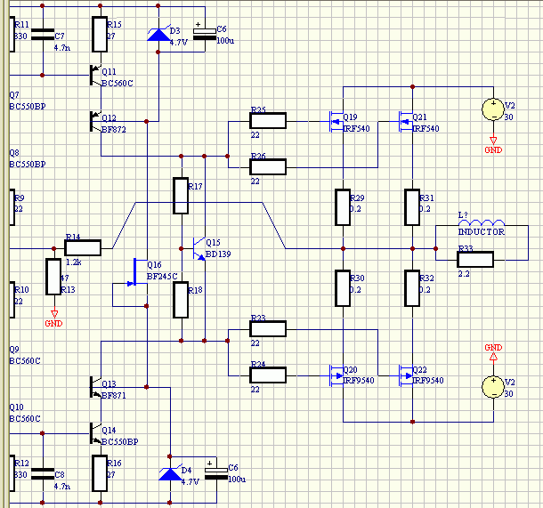

I particularly like the output stage on your first schematic. The first reason (as you already mentioned) is that it can be driven very close to the rails. The second reason is that lower Vce driver transistors can be used.
I don't think that this is topology is very critical regarding stability.
I haven't found the time to try my circuit out so far but a workmate of mine is very curious about it's performance and will most probably try it out.
Good luck with yours
Charles
