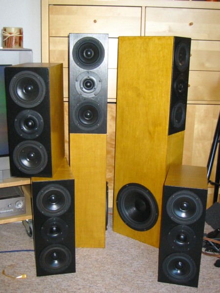

I finished my new speakers. Its is a simple design I think...but then the simple things in life are often the best 😎
They use Vifa drivers D27TG45, PL11WG09 & PL22WR09 (sub's). The crossover point is at 3KHz, 3rd order on the high pass and 2nd order on the low pass.
The sub's will be driven by a separate amp (not yet purchased) with the input signal comming from a XM9 XO and a WM8 Basis equaliser (Marchand). The sub enclosure is thus not vented and the WM8 will ensure a smooth response curve to 20Hz if I so desire. I think this will be a much better solution to a ported box design.
External dimensions are (H/W/D) 900*150*260mm and 390*150*260, the wood is 15mm ply, all joints are glued.
All up the cost is 4000EUR which includes 1500EUR for the amps (NAT T752 & NAD C270) and XO/EQ components.
Attached is a photo.
Cheers, Tim.

Congratulations on the speakers, Tim. You've been very busy.
It may be a simple design to you but you've only got to go back a little while and this would be leading edge technology.
I'm all for sealed box for bass - tuneful, tight, and fast. Incidentally, I'm currently using a 1970s Cambridge A70 solid state power amplifier for my subs. I got it used from eBay and it's fantastic for the job. You don't have to spend big money for a sub amp.
Enjoy your creations.
I plan to buy some D27TG45 too. Could you describe how they sound ? was 3rd order apropriate ? tell us more about the crossover !
Nice speakers, I built side woofer floorstander too and had pretty good results. Id go for sealed enclosure as 7v. good job:nod:

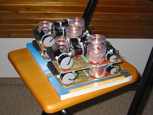

The D27TG45 is nice when paired with the two PL11's. The biggest thing I have noticed is the clarity and depth in drums and cymbols. Previously I had DT19's but they seemed thin in comparison and there was no depth to the sound.
OK, initally in design process I considered 1st or 2nd order and a notch filter to protect the tweeter at its resonant freq...but then I did a component count and it was the same as 3rd order...so I figured that was the better option - you know KISS.
But also with a MTM config comes the chance to make a D'Appolito configuration which relies on 2nd or 3rd order crossovers.
After plugging values into various formulas I decided that it would be quicker just to get madisound to do a LEAP design for 30 dollars.
I really wanted someting that would work first go without tweaking and the like so I took a conservative approach, selecting drivers with good response, computer designed XO, sealed boxes...taking this system approach worked well.
I have attached a picture of the XO's, notice they are on a PCB, this is to keep things compact as there is not much room in those boxes. Perhaps a different approach is better if you have the room (more active XO's could be an option).
