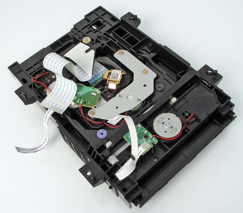

I have had another close look at the laser mechanism in operation (while holding it in my hand). Three things: commercially bought CD's make a quieter clicking sound than home burned CD-R's; the repeating mechanical ticking sound gets faster as the laser moves towards the centre of the disk; lastly, it ticks only when in 'play' mode.
My guess is that the laser requires realignment as it is constantly having to correct itself.

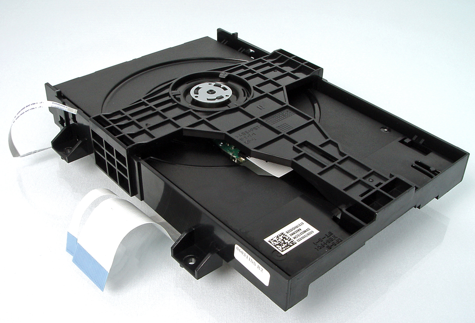

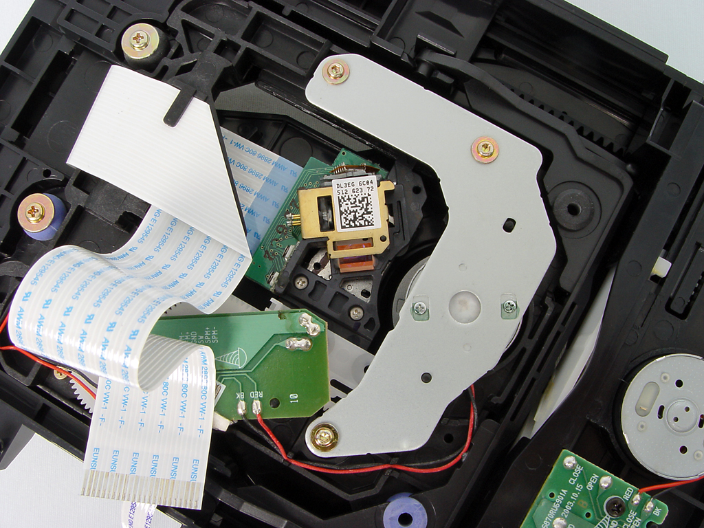

The mechanism is marked as follows: DL3EG 6C04 512 623 72 060311SS B2
I believe it is a Samsung laser mechanism but I cannot find a replacement anywhere (unless I buy 500 or more).
I have attached photos.
I prefer not to fool around with the laser gain because the unit works perfectly (other than the ticking sound) and would not like to unnecessarily shorten its life. However, can the focus and fine tracking offset be adjusted on this critter? Anyone?

Many DVD based pickups/mechs are noisy due to the way the servos operate... something many notice.
Does it make the noise if you pause it, as that stops the sled ?
tbh it sounds as though it's normal for something like this.
Yes, the noise occurs only when it is in 'play' mode. Stops when the laser is in pause mode, fast forward, etc.
Hard to say then, without actually hearing it for real. Ticking noise is characteristic of general servo noise (produced from the current in the tracking windings on the lens assembly).
The gears for the sled normally turn so slowly that I wouldn't expect that to be an issue, the motor usually just inches it's way around... again without actually seeing and hearing it's hard to make a judgement call.
