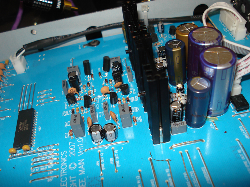

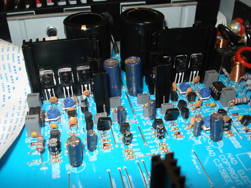

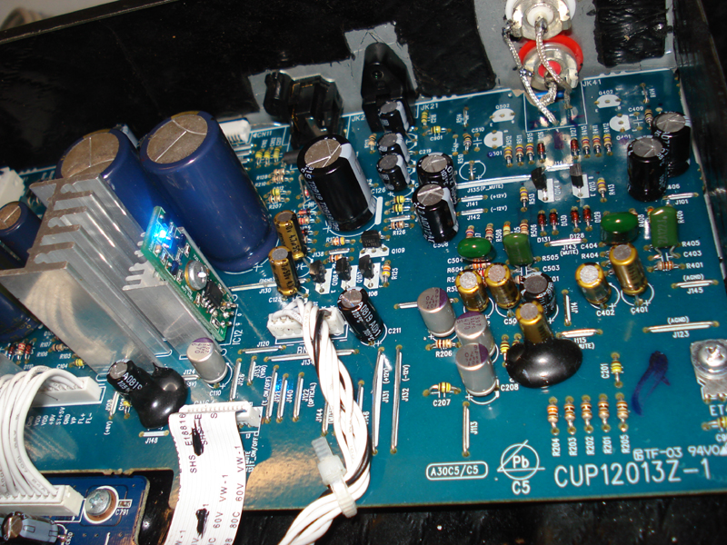

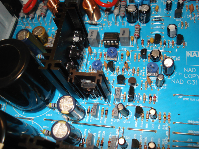

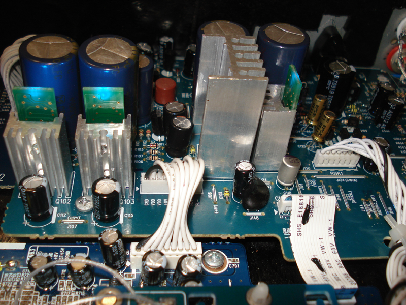

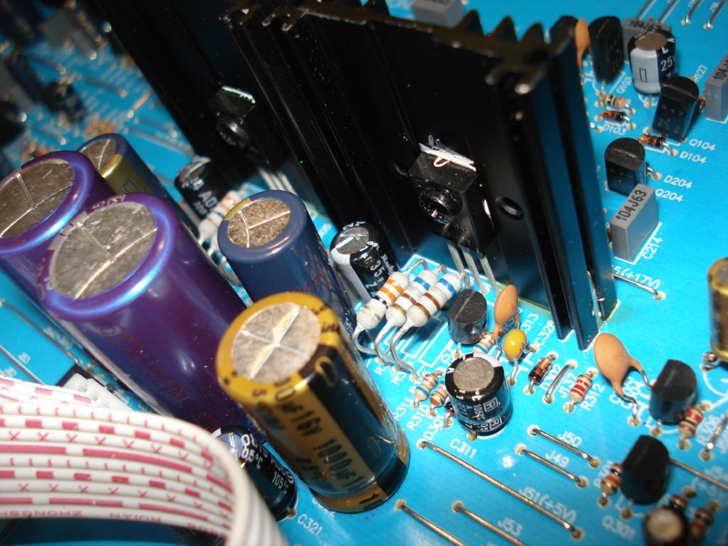

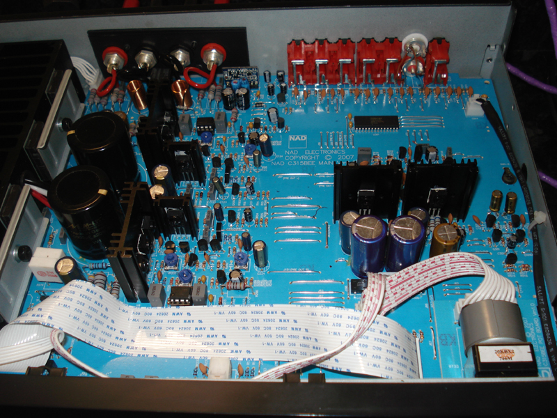

It's too bright.......
I'm guessing it's my fault being a newbie thinking I had to replace every single cap to make it 'better'. The first to be replaced were by Brent at Audio Upgrades which were oscons for the dac and digital rail, panasonic FCs for the digital and analogue psu's and rubycon ZA's for the output.
Then I changed every single other cap for Rubycon ZA's. Were they a bad choice? I've heard someone say they're too clinical? anyone agree? Is that why it's too bright????
It could be the amp (lil c315bee) though, I changed the main caps for Mundorf M Si's and every other larger cap for Panasonic FC's and smaller for ruby ZA's.
The overal output is much more detailed but top heavy. Any suggestions??
It could be the ZA's.
Did you mod the CDP before the amp? At what point did the sound get too bright?

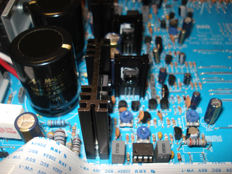

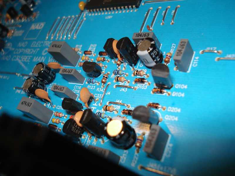

I would guess you put ZA's in the feedback position and directly in the signal path then?
Stupidly both at the same time and everything at once. Think I'm going to halt with the nads, they're truly miles better than standard but I fancy a fresh start knowing what I know now. I'm thinking the marantz 6003 duo.
I presume so, not knowing much I thought they'd be better everywhere. Feedback position?? please enlighten me.....
Where are you based?
Have you got service manual's for the amp and cdp?
Any detailed photos?
North East.....No service manuals....... I'll post some pics in a mo, just get the tops off and upload them etc.
