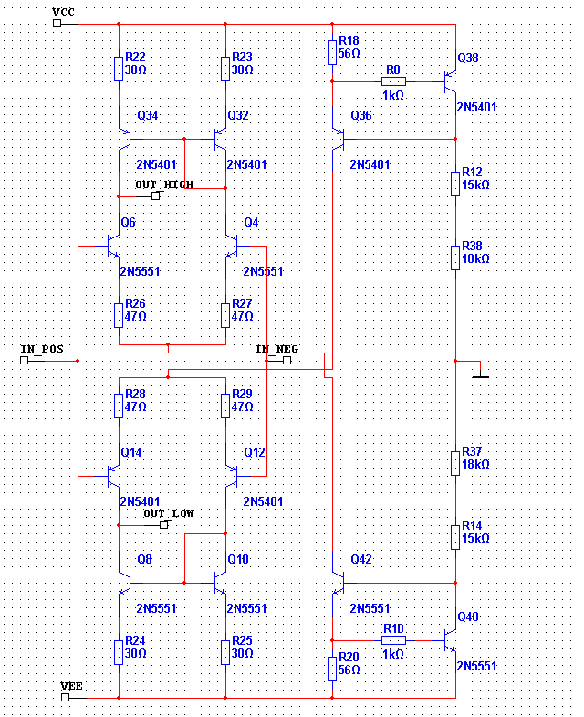

Hi guys,

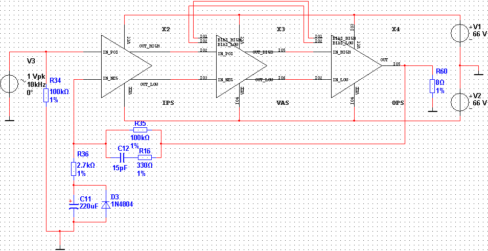

I'm building a Mosfet amplifier based on a selfmade circuit design (mostly based on techniques and building blocks learned from Randy Slone's book "High Power Audio Amplifier Construction Manual"), as can be seen in the attached schematics (I divided the schematics into blocks to make it more readable. The three triangular symbols contains respectively the input stage, voltage amplification stage and output stage, whose schematics will be posted in the next posts).
The circuit as it is seen in the attachments works great in Electronics Workbench, and simulation results are quite pleasing. I have now hooked it up on breadboard for real life testing, and some problems have occurred.
as long as I don't connect a speaker (or any load) it seems to be working fine, it reproduces the applied sine wave at various frequencies very nicely, and with quite low distortion (measured 0,4% at 1 kHz).

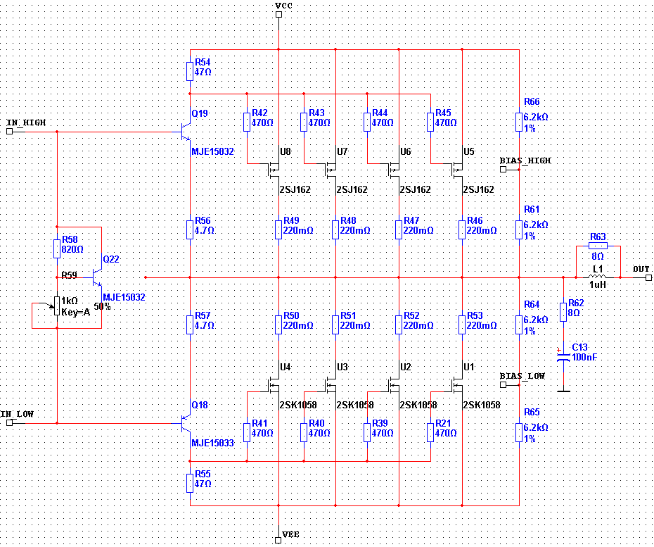

when I connect a speaker (8 Ohms) it starts acting weird. Upon power up, a lot of strange noises are heard in the speaker and the lower output device conducts approx 1-2 amps of current. After a few seconds the noise is silenced, and I'm attempting to play music. it is possible to recognize which song is played, but not more to it than that. The distortion is massive, and the sound is very grainy, somewhat like listening to a very badly tuned radio, to put a word on it.
The problem seems to have something to do with the biasing of the output devices. The sound seems to disappear completely on low volumes, and I measure -0,43 Volts on both the collector and emitter of the amplified diode transistor (Q22 in the output stage).
The test setup differs from the schematics by the following:
- Rail voltages are +/- 32 Volts (maximum available from my lab supply)
- MJ15032/MJ15033 transistors replaced with 2SC2073/2SA940 (also tested with 2SD669/2SB649, didn't help the problems)
- Only one pair of output devices
- the pot used for adjusting the bias current is rated 20K instead of 1K
- Resistors R54 and R55 in the output stage are 91 Ohms
- Resistors R56 and R57 in the output stage are 10 Ohms (the ratio between these and the R54/R55 should be 10).
Any suggestions? Is there anything wrong with the design, or are the problems caused by the changes made to the test setup?
This is the schematics of the Input Stage. The In_Pos connection is the main input, while the In_Neg connection is the feedback input. VCC/VEE are the positive and negative rail voltages.

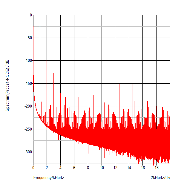

I have been using these for a while and they are fine for running
most simulations.
However, I do not know if these correctly simulate all and every
concievable parameter. I think they don't but that's another
story.
Just to make sure, I ran some sims Transient, Bode Plot, and
FFT using Simetrix and these models on a 1985 Elektor AXL
amplifier.
Attached is a FFT picture.

Hi Ventle
There might be a problem with the biasing of your vas stage. Current mirrors in a complementary differential stage cause the vas stage bias to be undefined. In a lot of instances the amp will still work but youll have dc offset problems. Slone used the mirrors in his early designs but most probably didnt build them and based them on spice. Everything is great with spice as it doesnt take into account the variations in actual components. In all his present designs which he has sold for comercial porpose he has dropped the current mirrors and uses resistors.
There are a lot of threads on this subject here, do a search on the name randy slone where these problems have been discussed.
Did you mesure the voltage across each of those output resistors? If you only measured .43v across the bias transistor
that sure points to a problem there either you need to replace it with the correct value, adjust it or have a bad transistor. I think
that outpur circuite wil need over 1 volt just to turn the drivers on.
So you are running in class B and a poorly biased class B.
thanks, that's quite useful information, meaning there IS a serious design flaw (I did search and read some long and quite informative threads about this design).
Seems like mr. Slone has found a way to overcome this limitation as well - the amplifier he only names 6-21 in his other book "The audiophile's project sourcebook" (known as the "OPTI-MOS" on the internet, see shcematics here) has been built by both Slone himself and several users on this forum. I actually breadboarded this circuit as well, but it turns out that this circuit won't work at all with 32-volt supply rails... PCB version with 66-volt rails coming up!

edit 2 - woody, I agree with your point, however, the scope traces does not indicate class B operation (no visible crossover distortion). I hooked up a 1.2 kOhm resistor in parallell with the pot, and the resistance value seemed to be correct, furthermore, I adjusted it to get the correct bias current through the output resistors, but results still the same - smooth curves with no speaker connected, massive distortion with speaker connected. I think homemodder has pointed out the real problem.

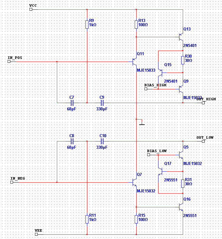

Interesting, i took a second glance at your vas stage, does slone show that cascode as in your schematic. The biasing of that cascode is a very clever trick to reduce high frequence distortion, Rotel uses it as well. I havent seen it done with a cfp before though. With lower rails it would be a problem with the optimos.

I wonder if the stange noise when the load is connected is due to the driver (VAS load) being starved of base current above the limit of the CCS(s) that is in series with the VAS load. If the CCS is uses to define the VAS bias Q point, it can only "sink" current below the bias point and not "source" it. Of course, as you know, without them the VAS bias will be undefined when using mirrors in the comp input diff.:smash:
Yes and no, he does use this VAS topology, but he doesn't bias the cascode transistor the way I've done it. I'm biasing it with a voltage divider setting the bias to exactly half the difference between the output rail and the supply rail - precisely as he has done in the optimos design (that's where I got the idea from).

I like that cascode idea of yours, it might have some merits to it, and perform its intended purpose better than slones way. The best way for you to experiment with it would be to replace the current mirrors with resistors to solve that problem, then see how well that cascode scheme works and pinpoint the best bias setting for it. In spice where it sims as a working circuit does it perform better than slones??
I have some info on that cascode technique and how it operates as well as the patent taken out on it, but havent looked at it in some time, if you interested i will try to dig it up out of my hardrives. This goes for the stochino amp as well. ts been 4 5 years since i constructed these but i should still have all the research i did saved somewhere.
