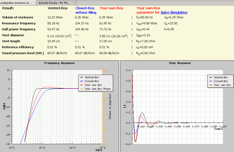

I put the parameters into the box model. Very interesting. If I use the updated spec. for the FE127 where Fs = 90Hz then my box will produce a little less bass extension than I had calculated it would.
The F120A looks like a nicer driver than the FE127 from the spec. Because the F120A is closer to the spec I actually designed my box for, it works better than the FE127. So with no changes to the Moon_Onken you get a pretty nice response.
There's a small 1dB lift in the bass, but this is likely inaudible and some people actually prefer a small 3dB lift.
Conclusion: the Moon_Onken looks like a great fit for these drivers. Better fit than the FE127's.

Dave: You are probably correct about 10litres being the minimum, but I would like to try some smaller ones. Afterall, I will be using subs. I could happily build a pair to your specs and compare them. I have plenty of plywood lying around.
My worry is not about how far the bass goes down, but how big the bump is before it starts falling off.

Originally posted by chrisb Gareth, perhaps this has been addressed, but I might add that there may not be accurate modeling for behavior of the resistive ports that are an important feature of the Fonken style of enclosure, so as the saying goes YMMV.
You are absolutely right of course. However, my personal view is that the sound of a closed box or BR speaker is not very sensitive to the exact sizing of the box although I will grant that poorly dimensioned ports can create problems.
The calculator is proven to be accurate for regular BR boxes. What I did find that encouraged me, was that when I took the dimensions of the Fonken designs published by planet10 and loaded them into that online calculator, it showed a remarkably good match with what the calculator would have suggested.
What I did was to play around with the design parameters in this calculator and decide for myself how much margin of error could be had in terms of the speaker design. It was quite a lot. In the end, it is the bumps and wriggles in the driver response that has dominated the sound performance of the speakers I built.
As you say, YMMV. I'm certainly not trying to 'sell' anyone on the design I used. One of my goals was to learn something about speaker design along the way so an off-the-shelf design was never an option. I was fortunate in having you guys to 'keep me honest' during the process.
