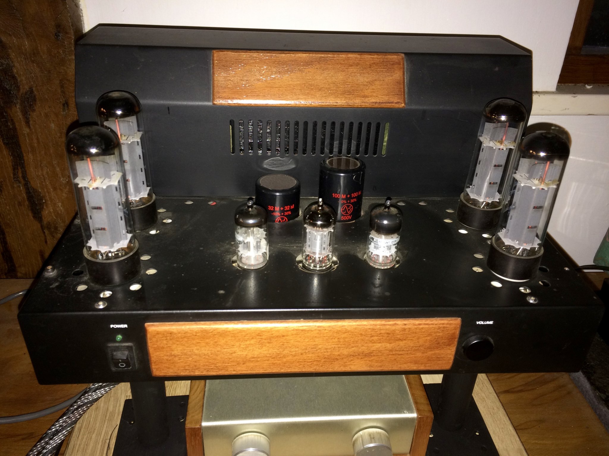

First change was done couple a months before Amp was broke down. It's about removing transformer cover. The result? However it was expected (as I found this tip over Internet) still was very surprising. The sound becomes more open, for me it was like dropping down the blanket off the speakers! Really worth try - I'll say 🙂
Now if the main transformer is tend to humming you have to consider pros and cons unfortunately. Mine does humming quietly, however that is very low audible - hear it only when I am sitting by the desk, next to the audio rack and doesn't bother me at all. From my listening position is completely inaudible.

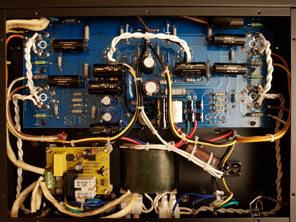

OK how did the Amplifier look after? In my opinion much more serious, please take a look:

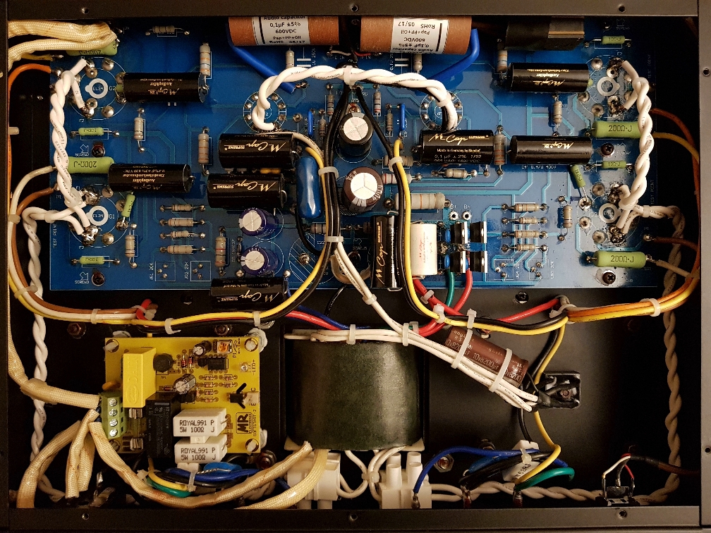

At the time I was waiting for replacement 10Ω 2W Resistors I was finally done some mods planned months ago. So I soldered small 10nF 2kV Caps by 420V Diodes to get rid of sibilants. That also makes vocals nicely smooth, which is always a good thing.
Another job was changing wiring for Tube Valve glowing for twisted ones (or more twisted if was present). Obviously for EMI reduction. Below is the most recent photo inside - new 10Ω 2W Resistors, 10nF 2kV Caps and wiring:

That mod is now left for permanent, with tracks cut - so there is no circuit hanging "in the air", means no temporary tracks & risky soldering inside. This is how it looks inside now:
Other changes can be seen above - I've swapped Anode Resistors for 200R 5W Kiwame Resistors. I have feeling that opens the sound a bit, especially in midrange area.

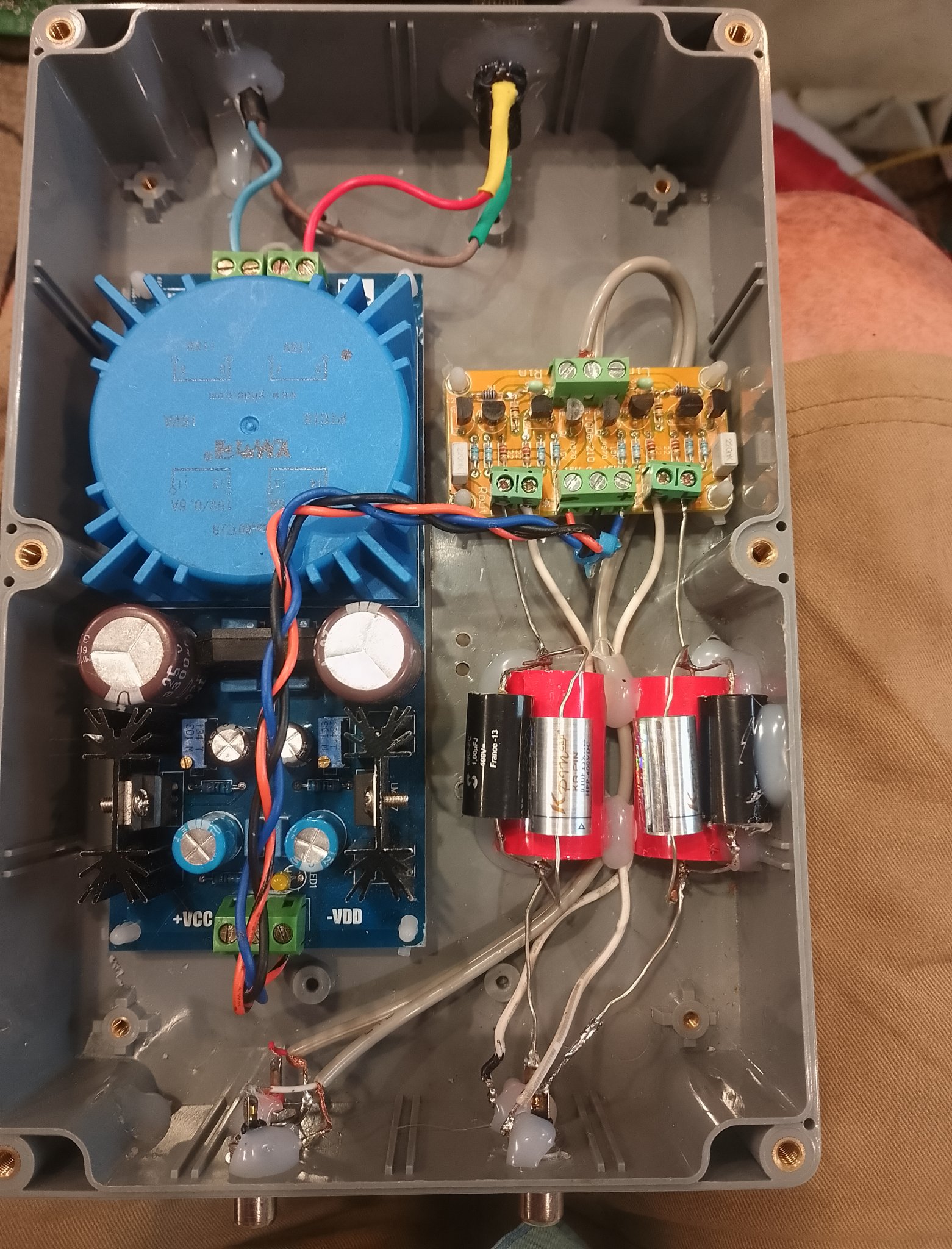

Old post I know but have done most of the mods as listed and very pleased with the results on the VR 70...had a buffer stage lying around.. just something that I made up a year ago . big power supply in it with cascaded transistors.. that confusion when complex passages occur seems to have been cleaned up significantly plus the slightly bloated bass that is a characteristic of this amp has also been cleaned up.. individual bass notes are effortlessly heard now. So maybe it's something that others may benefit from.. probably thou depending on which buffer stage and preamp..but again transforming. Imaging has improved as well with dynamics in the midrange benefitting. I am using Quad ESL63's so is easy to hear any changes..preamp is a NZ brand made in the 80s ...very updated tho..McLaren . Great blog this one and has been very helpful to getting to where I am with this RV-70.. excellent.
This is the buffer stage made between the pre amp and the dynavox VR70..all AliExpress and great value..had a extremely small amount of DC out...0.126 v so installed caps which didn't impact on the sound quality. Have just changed the input valves on the VR 70 to some Yugo SGH8 and am aware that this particular valve is not that reliable but this has perked up the detail and midrange definition a bit over the 6f2s so was worthwhile.. If they fail I will get the western reliable equivalents.. the 6f2s were ok and in reality the buffer stage was about 200 percent more improvement rather then the valve change..
