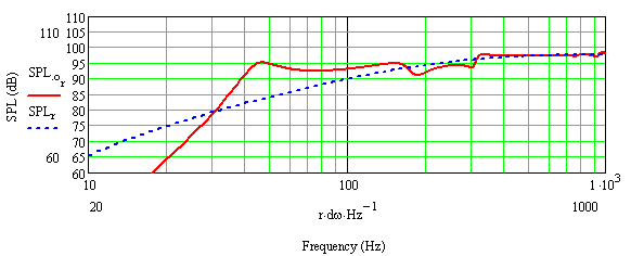

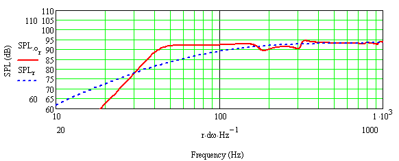

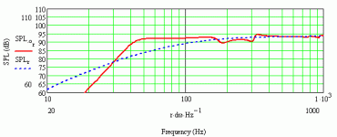

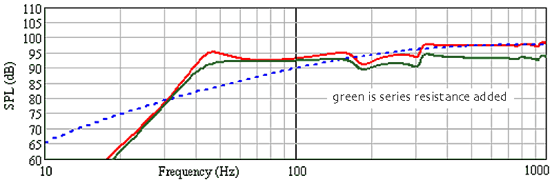

At the risk of putting words into his mouth, Dave isn't into exotic wire either (nor am I or Steve). A pair of the 24AWG twisted conductors extracted from a run of Cat5 network cable should do nicely for your Metronomes. You can untwist them if you feel so inclined and stick them between a couple of pieces of tape.
This isn't voodoo -what happens is the additional series resistance of the wire lifts the Qe of the driver slightly, and lowers the output impedence of the amplifier. If you don't fancy this, an alternative is to add a small resistor in series with the driver (in the positive lead). About 3ohms should be sufficient. In practical terms, you'll lift the bass response, and smooth out the midrange & treble. Most FR drivers need a degree of correction when used with SS amps. Remember though that the Metronome with the 108ESigma is never going to be a bass-champ. About 80Hz is your limit.
A quick example: an enclosure (not a Metronome, I just had it to hand) with a low-Q driver and a high DF amp, which will not correct its response.
